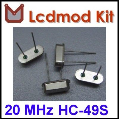

PostPosted: Tue May 19, 2009 12:29 pm    Post subject: Reply with quote  Mark this post and the followings unread
The crystal can be ordered at futurluc also.
http://www.futurlec.com/Crystals/CRYLF20M000.shtml
The pots kinda make you have to shop there anyways unless you have your own source. Mouser does not offer the kind of pot the pCB uses.
As far as delicate, there is nothing fragile or extremely heat sensitive. The crystal is just soldered on like any other part, there's no polarity either.
Yeah 1N4002 is fine. On the PCB those are the Bigger silkscreened diode.
The crystal look like that, you can also use the taller ones. This one in the picture is known as "low profile"

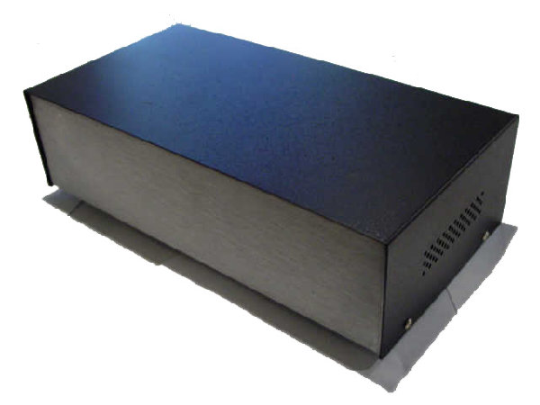

When I build a few to sell off I am going to use this case:
That's if your going to build it as a stand alone self powered unit.
I forgot to mention that if your going to build it as a stand alone, you will need a 12v AC 300mA or greater wallwart. If you decide to power it up on 15v regulators you will need 16v AC wallwart.
http://www.web-tronics.com/la-7.html
or this case is cool, on the medical tip.
http://www.web-tronics.com/smalemsercha1.html
There pretty cheap.

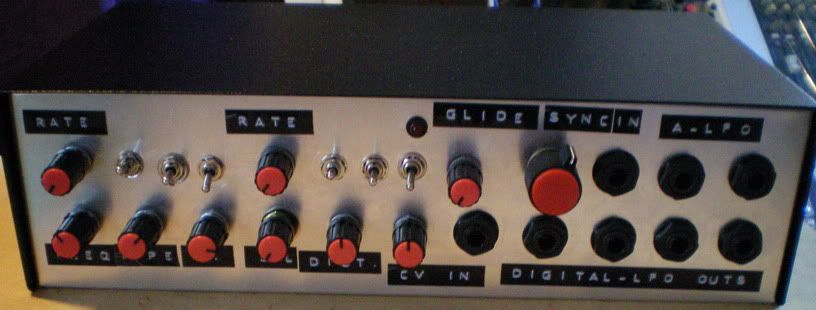

PostPosted: Fri May 29, 2009 12:50 pm    Post subject: Reply with quote  Mark this post and the followings unread
here's some pics of the build:
Photobucket
