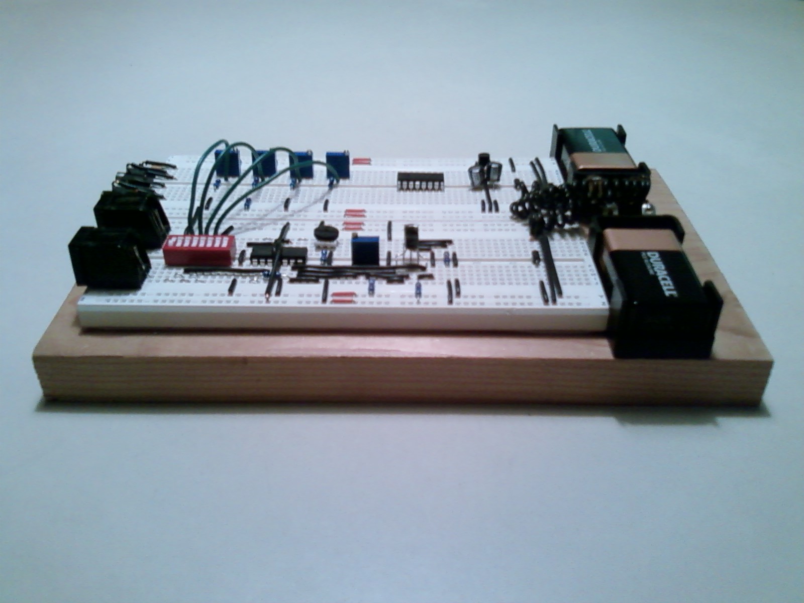

PostPosted: Mon Apr 12, 2010 1:06 am    Post subject: Reply with quote  Mark this post and the followings unread
Good news folks, I prototyped the expo converter and it works just fine, at least at first glance. I still have to make detailed measurements and I might need to change the tempco value for 9V battery operation plus tweak the output resistor for the three supply voltages, but none of that will change the layout of the board.
In building this prototype I epoxied the two transistors to a small piece of metal, and also epoxied the two 1kOhm 3300PPM tempco resistors underneath the piece of metal to simulate the actual on-board condition. The Digikey part number for the tempco resistors is P1.0KCHCT-ND. You'll want to buy several of them because they are 0805 and so it's easy to lose them or mess them up.
I guess this means that I'm ready to generate output files and send them to jeff-o, but I'll wait a day or two for anyone to make any comments they might notice about the design. So please let me know of any gotchas you might notice, thanks.
