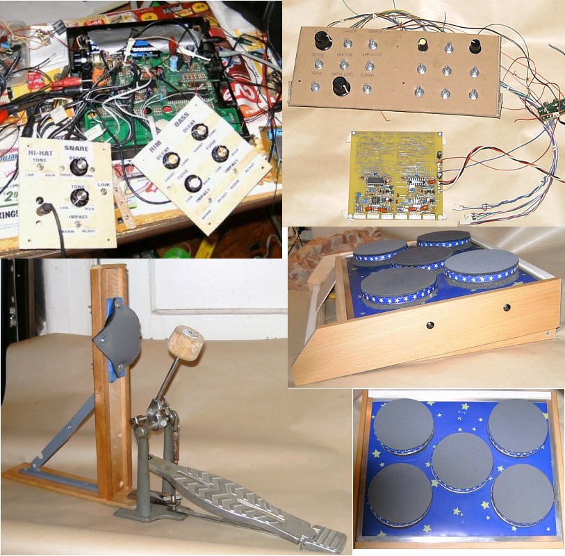

PostPosted: Fri Apr 02, 2010 6:39 am    Post subject: Reply with quote  Mark this post and the followings unread
If double-posting was allowed, this could also appear in "post your backlog." I'm too embarassed to to say how long this has been "in progress"
Shown: early stages of Synsonic mods; 2-unit Bass++ that needs troubleshooting, with its temp control panel; bass pedal with pad; box to house the electronics, with piezo pads.

Little update.
Added CV in jacks for the DS8s and took out the crappy noise transistors. Installed sockets so I can try different transistors, now they have 2N3904 in them.
Redid the power distribution, much tidier now and makes room for more modules.
Quad Bass++ is stuffed, just need hardware.
Bought some potentiometers but it won't be enough to do all four Bass++ at once, which I'd prefer. So I looked at the Cynare and HEY, I have the stuff for it.
Now considering how best to lay out the Cynare panel. The panel will be a 3U 19" just like the others, just because it's awesome.
The board is stuffed, just need transistors and ICs, but the sockets are in. I'm going for all of the extra jacks to make it uber patchable, the 6 shimmer pots, the impact level pot, and a banana to 1/4" jack converter for the main output with a simple level pot( maybe two of these since I'll have the panel space...). I don't have any of the 2222 transistors but I think there's enough 2n3904 in the parts bin, there's at least one for the noise generator. I have HEAPS of other kinds too, BC549, 550, etc. Let's just see how it goes I guess...
Has anyone taken the Shimmer out to its own output jack like the noise? I'm wondering if I'd have to do a buffer Op Amp thingy to have that.
