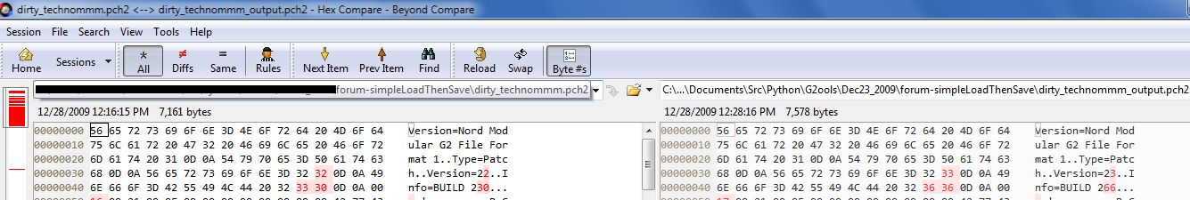

This works - which is exciting! but unfortunately - some pch2 files - after I save back out - show up as corrupted.
The clavia editor either won't open them, or the editor crashes with a visual c++ runtime error.
I've narrowed it down to a simple test in python to:
1. load a pch2 file,
2. immediately save it back out without any modification
...but the resulting output pch2 file is still corrupt.
in a hex editor - the differences show up spottily early on in the file like this:
Posted Image, might have been reduced in size. Click Image to view fullscreen. first few differences
... then near the end of the file they really go out of synch like this:
This works for most pch2 files I've tried, but a few like this are stuborn. ;o(

I would suggest that you try to process the original patch and check the results.
Ok- I've processed the Mother Misty modified patch (dirty_techno_MMM.pch2), with Zenpho's "read & write" python script- based on G2ools.
    Running MM's original file with Zenpho's R&W script, the header of the patch which is written IS modified, and there are many other differences as well.
    When I load the output patch in the 1.40 Editor, the editor crashes.
This is a diff of the patch header between Mother Misty's dirty_techno_MMM.pch2, and the patch created by Zenpho's python script.
The patch version is modified by G2ools. This is probably normal, although I don't know why it is necessary to modify the pat
 Filesize:  80.64 KB
 Viewed:  785 Time(s)

PM with version 1.32 sent. I tried to post it to the OS archive thread but I hit my upload limit.
I did notice that zenpho's "input.pch2" file had the blank name modules missing from mother misty's original patch and I did not want to assume that maybe it was not processed before being loaded and converted with the G2 1.40 Editor.
So, g2ools updates old version patch headers to look like a version 1.40 patch - probably not a good idea. At least one significant change to the 1.40 patch data was the addition of a mutation exclusion flag for most if not all of the patch modules. I'm not sure if the 1.40 or the 1.62 Editor relies on the header info for the patch version, but it may. The Editor being tricked into reading an old version patch that does not contain expected data may be a problem. In any case, I would also recommend that all patches be loaded and converted with at least the 1.40 Editor before being processed with g2ools.

PostPosted: Tue Dec 29, 2009 5:18 pm    Post subject: Re: Try the original patch Reply with quote  Mark this post and the followings unread
The version that g2ools is written for is 1.42. I looked into supporting other versions but the format changed enough to not make it feasible. Even 1.62 which has nothing new has a format change which I think is stupid. Why? There is nothing that changed from 1.42. It took me about a month to reverse engineer 1.42. I looked into updating for 1.62. It was going to take too long and I was impatient.
I have set up an repository on http://github.com/msg/g2ools. This has my latest sources which have many bug fixes. I was hoping to release a 2.0 g2ools version but haven't had time. I'll post a message to the g2ools forum with all of the new stuff (which there is much).
I think some of the problems with the patch posted above were fixed as I loaded and saved the file using the g2ools code. Then I loaded into the 1.42 editor without problems. If there is a problem, it works with the current source code on github.com.
Hope that helps.

Fantastic! The newer g2ools code does not corrupt the patch. That's good news!
I sure would like to thank you qfingers along with 3phase and others who worked on the g2ools NM and dx converters - what a great effort to build this. It is wonderful to hear some of my favorite NM patches come to life in my G2X.
