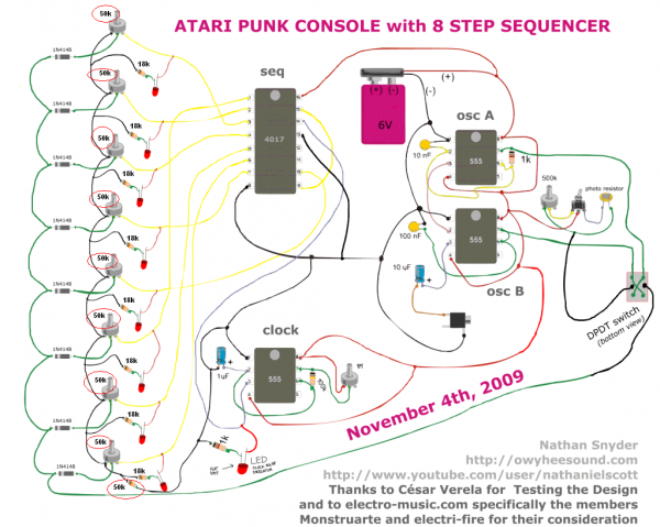

PostPosted: Thu Nov 22, 2012 9:04 pm    Post subject: Reply with quote  Mark this post and the followings unread

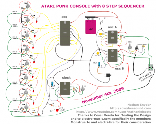

-minus- wrote:
I still have the two thirds of the eight 100K pot unusable problem...
I think you need to try this:
 Filesize:  318.35 KB
 Viewed:  1204 Time(s)
Sorry my english
Denis_Veselov
Joined: Nov 22, 2012
Posts: 13
Location: Russia
PostPosted: Fri Nov 23, 2012 4:31 am    Post subject: Reply with quote  Mark this post and the followings unread
or so maybe:
 Filesize:  319.85 KB
 Viewed:  1206 Time(s)
Sorry my english
Denis_Veselov
Posts: 13
Location: Russia
PostPosted: Wed Nov 28, 2012 1:17 am    Post subject: Reply with quote  Mark this post and the followings unread
Denis_Veselov wrote:
or so maybe:
I'll build this circuit on my breadboard, but it isn't working. Sad
Sorry my english
-minus-
Joined: Oct 26, 2008
Posts: 787
PostPosted: Wed Nov 28, 2012 1:29 am    Post subject: Reply with quote  Mark this post and the followings unread
Ok. So are you getting any part of it to work? Is there any sound?
First thing to check is the power supply. If you are using a battery has it got power in it? Then you need to check the power is getting to the I.C's. Make sure all the grounded components are connected.
If you are getting power to the board correctly, you should check that the clock is working and then move on to the 4017 counter.

PostPosted: Wed Nov 28, 2012 1:39 am    Post subject: Reply with quote  Mark this post and the followings unread
So i think, if to break all left wires (see circuit) of 8 pots, it will start give the sound in all its range.
But it make new problems:
1) Impossible to make a silence in anyone channel.
2) If all pots stay in left position, 8 tones have a some difference of tones.
Sorry my english
Denis_Veselov
Posts: 13
Location: Russia
PostPosted: Wed Nov 28, 2012 1:46 am    Post subject: Reply with quote  Mark this post and the followings unread
I just said about my changed circuit. It have a sound, but in second half range of pots.
Sorry my english
-minus-
Posts: 787
PostPosted: Wed Nov 28, 2012 2:08 am    Post subject: Reply with quote  Mark this post and the followings unread
Sorry I was unsure what you meant. So you have sound but the changes you suggested haven't worked.
To silence a channel you could use switches maybe. But that won't help the difference in tones problem.
What about reducing the 50K resistors you suggested using on the 8 steps. Perhaps you could try that?

PostPosted: Wed Nov 28, 2012 10:38 pm    Post subject: Reply with quote  Mark this post and the followings unread
This changes haven't worked too.
Sorry my english
-minus-
Posts: 787
PostPosted: Wed Nov 28, 2012 11:03 pm    Post subject: Reply with quote  Mark this post and the followings unread
Im just wondering what pots you are using. Linear (B) or Logarithmic (A). Log pots would tend to bunch up the usable range towards one end and would appear worse than linear in this application. Maybe check that.

PostPosted: Thu Nov 29, 2012 7:02 am    Post subject: Reply with quote  Mark this post and the followings unread
Pots have a mark: "B100K" (or "B50K" for changed circuit).
Sorry my english

PostPosted: Sat Mar 02, 2013 3:49 pm    Post subject: Reply with quote  Mark this post and the followings unread
Hi, first post, great thread. Will be building soon Smile .
Denis: Pots marked "B" are logarythmic, marked "A" are linear. You need A
It actually depends on the manufacturer. Most pots I use (Piher & Omeg) do indeed have an 'A' marking for linear, and a 'B' for logarithmic. However
alpha pots. and probably some other brands too, have this the other way around. (this can also be somewhat confusing in schematics when
they only use an 'A' or 'B')
welcome btw.
as for a filter, I recently used a simple sallenkey filter in a bend keyboard, which sounds pretty good.
Downside is that you need a stereopot. for the cutoff frequency, but it also has resonance control which is nice.

It actually depends on the manufacturer. Most pots I use (Piher & Omeg) do indeed have an 'A' marking for linear, and a 'B' for logarithmic. However alpha pots. and probably some other brands too, have this the other way around. (this can also be somewhat confusing in circuits when they only use an 'A' or 'B')
You frightened me for a moment there PHOBoS, but then I read it again. I assumed that A was LOG and B was LIN, but it turns out this is true for Alpha pots AND TruOhm pots (which account for most of the ones I have). I'll be a bit more careful in future not to assume that A and B mean anything!
Gary
RotomotioN
Joined: Mar 02, 2013
Posts: 9
PostPosted: Tue Mar 05, 2013 4:07 pm    Post subject: Reply with quote  Mark this post and the followings unread
Ha! Didn't know that. It makes it all the more confusing. Just get your meter and be sure!
