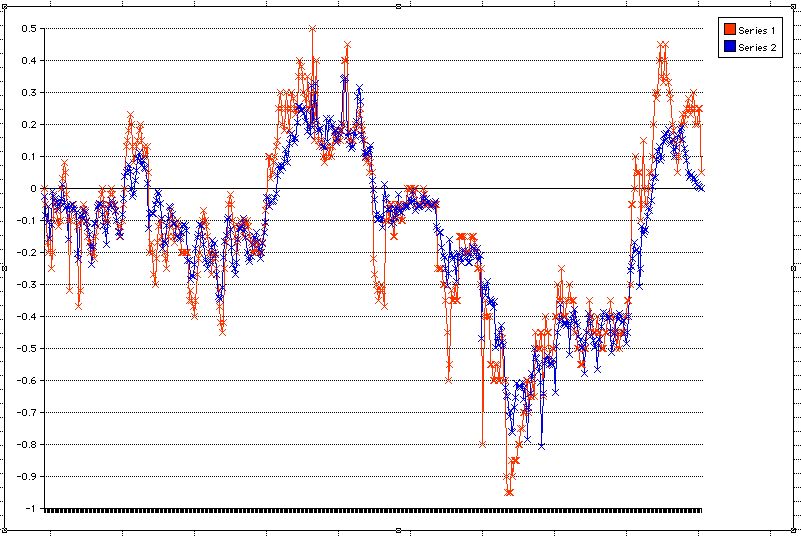

OK, I have been playing around with this adaptive filter most of the night now and it seems to be showing the beginnings of some hopes of working. In the plot shown below, 500 of 512 points are plotted (only 500 due to an insane limitation of Appleworks 6). The last 20 points plotted are predictive as are the 12 not shown at the end.
As you can see, the algorithm tracks the input closely and when I shut off the input signal to see how it predicts, it settles on the zero axis. This is in agreement with the input data that you cannot see. I do not yet trust the algorithm, however, because it seems to exhibit one of a few behavoirs listed following.
1. It will settle on zero.
2. It will oscillate around the correct solution.
3. It will show a periodic signal which is incorrect.
4. It will not work at all with some input parameter combinations.
I have found by attempting to fit three different segments of the data that I gathered and formatted (which is a bit of effort) that a carefully specified set of input parameters will properly reproduce the signal and predict it for only a very short while. These input parameters do not vary much depending on which of the three sub-data sets that I attempt to model, so that's a good thing.
I should also note that this method requires evenly spaced data samples and the input data is not evenly spaced. It is marked with timestamps that I cannot process without writing a Perl script or something, so what I did was just assume the data was evenly spaced and deal with it that way. This is not kosher and some additional algorithm such as a curve fit or simple interpolation is required to pre-process the data for use by the adaptive filter.
After I read your comments I will take the next step. Advice please?
Les

Looks like you have been working hard at this, Les. Some comments:
Don't worry about the timestamps of the data. Traders just call each data point a bar. Bars can be monthly, weekly, daily, hourly, all the way down to 1 minute and even less. Trading algorithms generally use any time scale. Weekends and holidays are usually ignored in most cases.
The objective of these algorithms is to generate some sort of trading signal - buy and sell queues. In the case of your algorithm, the time scale seems a little bit fast. You should add, if possible, some sort of slow down to this.
Shifting the result of the algorithm forward in time is done, but not without risks. The lag appears to be eliminated, but it is illusionary.
There is usually some number of samples that must be processed before the algorithm starts to work. If, for example, you are using a 512 FFT, then you should process at least 512 data samples before putting out the first result. If you are using a 50 bar moving average, then it will take 50 bars to get going, so to speak.

To address all four points:
1. There is a smoothing parameter. I will do more smoothing to get a clearer buy/sell decision. I added the "ringing" effect to act as a buy/sell signal. In the above example the dollar goes down then stabilizes, a sell signal.
2. I shifted the output data by a fixed amount equal to one of the input parameters. I understand why the data is shifted by exactly this amount of lag so there should not be a problem. This is why I feel the shifting has minimal risk, but of course it requires much testing.
3. The startup delay is precisely as you stated, Howard.
4. Jan, I felt that this method would not work in real time also when I first tried it, however after playing around with it for hours I thought about it and yes, it works in real time. This is because the computer can run through the calculation almost instantaneously and because all data to the current trade (with some availability delay) is known. It's just a calculation, not a violation of causality. Or did I explain that correctly?
Next up, I have realized that I can run an optimization algorithm to continuously guess at best-fit values of three of the input parameters, and set the fourth one to a known good value. This will automatically tune the algorithm for the given input data.
Further, I can look at the prediction values and determine a buy or sell decision automatically and update it in real time on the screen. I can also produce a numeric strength value to the decision.
By optimizing and deciding, the trader can just run the program continuously and when clear decisions print out then make the trading actions appropriately. I'll keep you posted.
Les

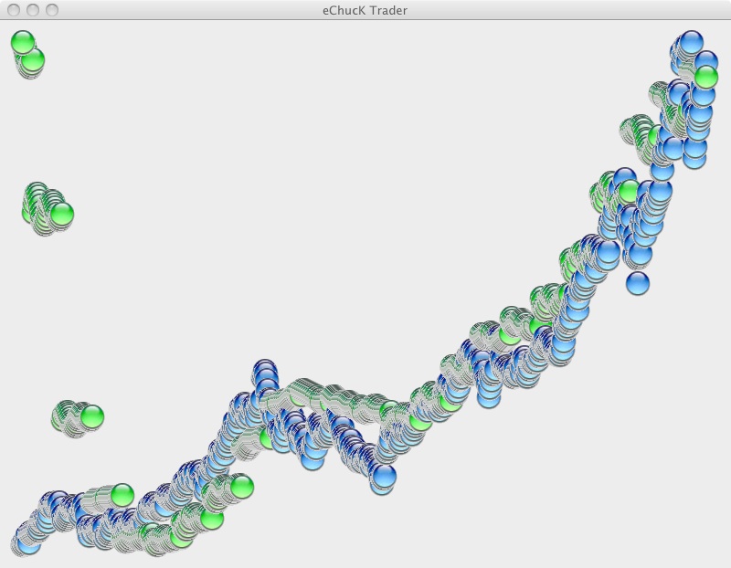

PostPosted: Sat Jul 03, 2010 2:46 am    Post subject: Reply with quote  Mark this post and the followings unread
I got motivated by my brother to work on the trading stuff and wrote a ChucK program to do it. The plot below shows the price of Apple stock from 05 to 07 in blue and the program's model of it in green. The program predicts a gain of $24 and the actual gain is $47. I figure in this game, a clear buy indicator is a good thing even if it is half-off. Or is that half-baked? I dunno...
Les

PostPosted: Fri Jul 09, 2010 1:30 pm    Post subject: Reply with quote  Mark this post and the followings unread
It's hard to tell what is going on from your figure. You x axis is very compact and your indicators are very fat. Also, the buy and sell indicators are not shown.
I have been thinking, but not doing, a lot about this lately. A lot of math experts I know take strong statements that it is impossible to predict the markets. I have been sucked into getting into arguments with them about it. I've come to the conclusion that it's not what this is about at all. The game isn't to predict the market, ie, IBM will be at 100 on September 15th, but to determine the probability of certain possibilities. This may seem obvious to many people, but it isn't.
The procedure of moving your filter's output forward in time is a common one. In and of itself, it's not a bad idea. It give you a prediction. You need to determine probability that the market is close to the predictions your filter makes. Then calculate the risk/reward ratio. That way you can determine if it is reasonable to harvest your market with your system.
Thus, it is possible to quantitatively measure your systems efficiency and effectiveness. I personally have never done this; I've just back tested my system and if it made a significant profit (subjective), I assumed it was a good system.

PostPosted: Fri Jul 09, 2010 6:50 pm    Post subject: Reply with quote  Mark this post and the followings unread
I'm just setting up the program and giving it an initial set of test data to chew on for now. To get a prediction I set the algorithm to continue after the data is done, as you say. Then I look at all the wiggling plots and see if the trend is up or down. This simple Apple 05 to 07 test case is an easy one to predict though, up up up up.
Next I'm going to add file i/o so I can get an online data service and pump their data into the program. But first we are going to select an online brokerage firm and invest in a few stocks that we like. Any recommendations?
