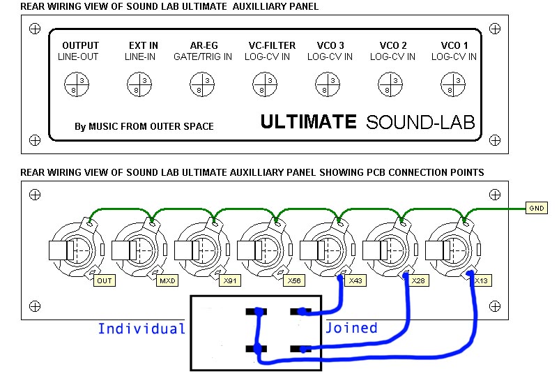

Anyway, things are generally moving forward, but I'm wondering about the CV to the oscillators, as it seems they are intended to be controlled individually. I'm wondering if I can do a modification to link the three oscillator CV inputs with a switch so I only need one CV feed coming in (see attached image), would this work?

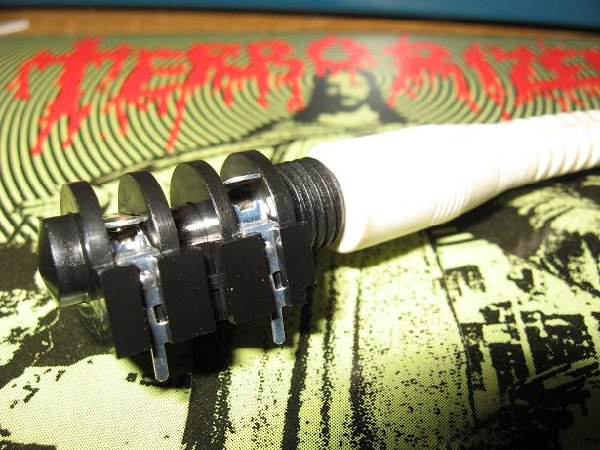

LektroiD,
If you use switched rather than un-switched jacks for the VCO2 and VCO3 CV inputs, you can do away with the extra switch.
You can then connect the input from VCO1 CV to the normalled connection of the CV inputs for VCO2 and VCO3, these will then use the VCO1 CV until you plug something into the relevant jack.
I hope that explanation is clear enough (though reading it again it assumes you know what a normalled connection is).
Regards

Magman, that sounds like a much better way! I only have one switched jack in my collection, so if I can get away with wiring up just using one switched and the other jacks non-switched, I'll do that. Either way, I think I'll need a diagram.

PostPosted: Mon Feb 08, 2010 10:39 am    Post subject: Reply with quote  Mark this post and the followings unread
sorry for jumping in magman ,i couldn't resist a dog rough sketch....
 Filesize:  22.54 KB
 Viewed:  14952 Time(s)

hope that sketch is not too confusing, if you are using the synth for bass lines & leads etc you'll likley have the 3 osc's all tuned together so you'll only use jack 1 / cv1 with 2 & 3 commoned to that .

PostPosted: Mon Feb 08, 2010 11:27 am    Post subject: Reply with quote  Mark this post and the followings unread
Superb! Thanks Skrog & Magman, all is clear now thumb up
