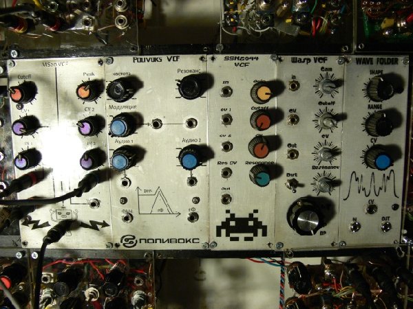

Continuing to pump out new panels.

Nice panels. Are they aluminum ones from ace hardware?

Actually they used to be a fairly large "Do not enter" sign. You'd be surprised how many panels you can get out of one road sign. I also picked some aluminum sheets from Skycraft but I haven't cut them up yet.

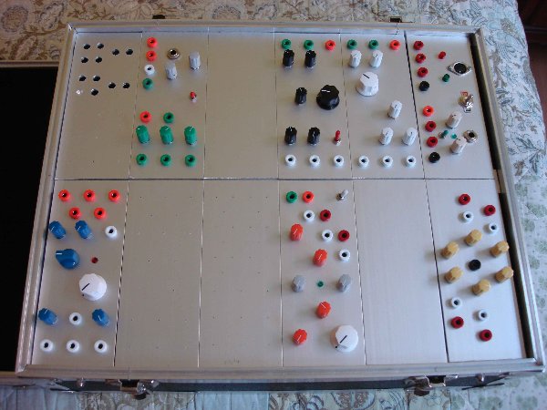

A project I'm trying to finish this year... Hand drilled panels take some time!
The panels are made from angled aluminum, great for very securely holding pcbs, This thing is pretty hefty though. I'm wondering if this is the first Dotcom to banana jack conversion....Embarassed The difference of having banana jacks has been great for me so far. I tried to shrink the whole system down and combined quite a few of the Dotcom modules to occupy one panel, thus having more room for more goodies.

Nice! I like the style, and how unpredictable it is visually. It looks like something that would be fun to play with. Not sure how easy it is to find your way around... Are you planning to add some labelling?

i like the finish on those ali panels. Really a good looking unique synth. Very Happy Very Happy

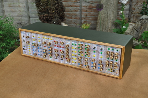

My first modular synth cabinet! 2010 build but started the first module a couple of years ago. Next is a Klee Sequencer.
Modules:
Power
MFOS Noise cornucopia
2x MFOS VCO
CGS Utility LFO
MFOS ADSR
Tellun Dunsel
CGS Synthacon VCF (double build)
MFOS Dual VCA
Stereo Panning mixer (MFOS +)
A few knobs still to be added.

Very unique ! Are those knobs made of ancient bones or are they wood?? Very Happy

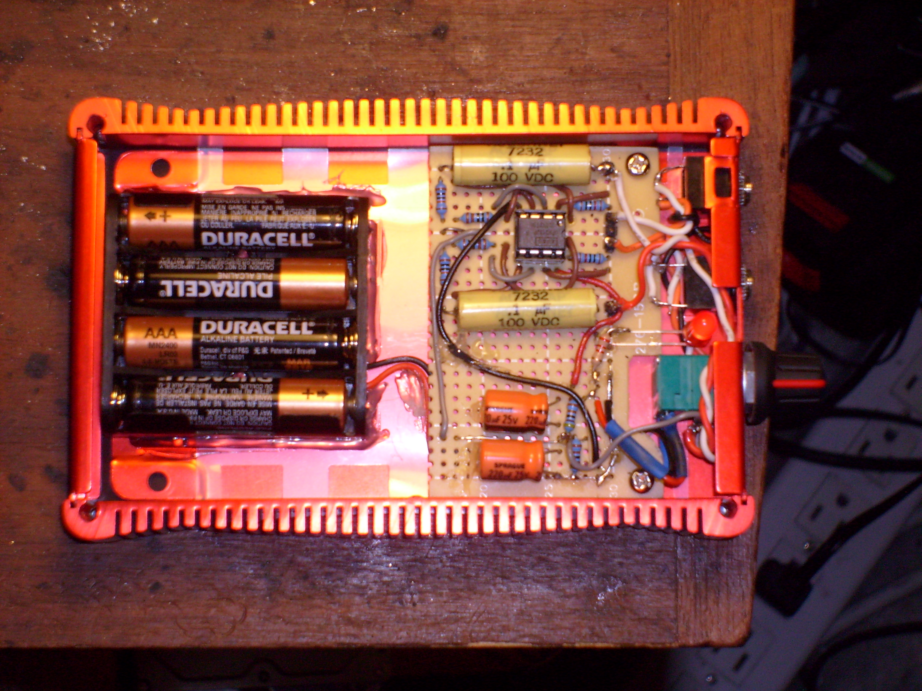

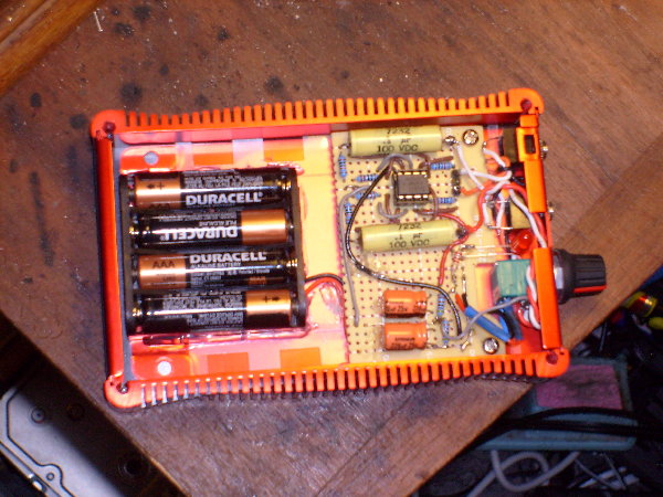

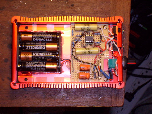

Here's a little build I just finished. It's a CMOY Headphone amp housed in an old 2.5" (laptop) Hard Drive external case. I'm quite pleased with how it turned out.

Had you used the Burr-Brown OPA2134 dual audio amplifier for this project? I know that I have seen two OPA134 single operational amplifiers for this project to better the isolation.

And are those knobs made from wood? (GREAT looking knobs.) Could it be that someone else in the world besides myself, has made knobs from wood? Very Happy (Wooden beads used as knobs by another chap, not really counting.)

Those knobs are cool. Are those legends burnt in using a soldering iron?? Very Happy Very Happy

The knobs are different colors for each module as well as in different pattern configurations so it's easier (and quicker) to "read" than traditional labeling... But, I'm speaking for my self of course.

I used an OPA2132. I was limited in supply voltage by the physical space. 9V battery would not fit in the case. The input caps were ones I had on had that were being thrown out where I used to work. I ordered the Stereo pot / Power switch on line. So far, I havent experienced any crosstalk or intermodulation that I can detect. I'm quite pleased with the build.

Thank god those caps were not thrown out. They are great for audio. Going to build myself one of those. lovely build. Very Happy Very Happy

The knobs are short lengths of eucalyptus branch seasoned for a year or so with the bark on.
I took sections that were roughly circular, 18-23mm in diameter, cut them to about 20mm long, beveled off the top, and cut a flat down one side. Drilled an 8mm hole in the back, filled with Milliput (two part room temperature setting epoxy clay), pushed in a pot shaft (covered with Vaseline) and pulled it carefully out before the epoxy had set. The markings are burnt on with a pyrography tool - guess a small soldering iron would work, but this is purpose built, with a variety of tips. Lot more work than placing an order with Rapid, but I quite like the result - though some are rather eccentric!
