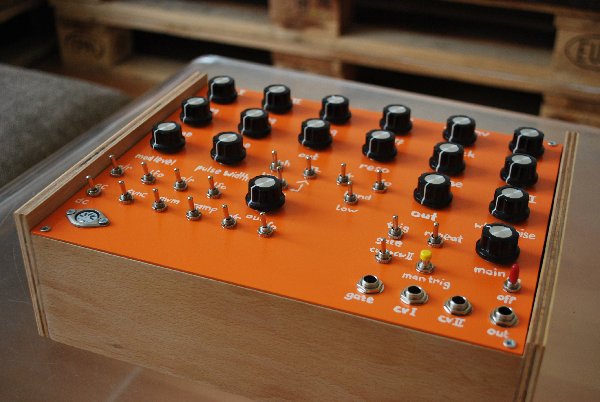

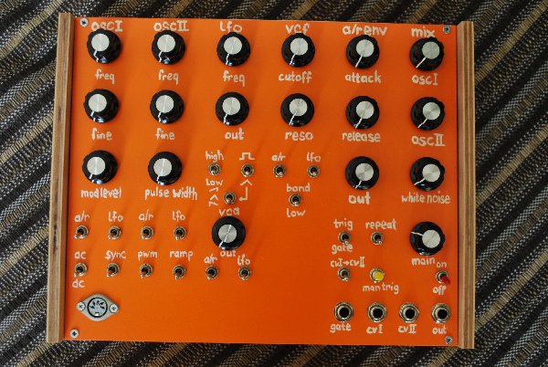

So - here's mine! My first synth DIY build...
It's a MFOS Sound Lab Mini with fine tune and osc2 -> osc1 modulation mods plus a midimplant.
The space besides the VCA is for an additional sample & hold - not sure yet if I'll need it though.
I spray painted the panel myself and as you can tell by the looks I did also the writing...
The design was inspired by Mr. Braskas visit at Tigric's lab.
This was great fun! Looking forward to build some more...

TekniK
Joined: Aug 10, 2008
Posts: 1059
PostPosted: Sat Aug 14, 2010 2:37 pm    Post subject: Reply with quote  Mark this post and the followings unread
that orange color is very sweet and the knobs are perfect on it

PostPosted: Sun Aug 15, 2010 2:49 am    Post subject: Reply with quote  Mark this post and the followings unread
The Midimplant is working perfect so far.
It is really small and quite easy to set up.
I'm using just one CV and one gate output out of the two - all I need for the Soundlab.
To drive both OSCs with the same control voltage from the Midimplant I simply connected the CVI and CVII jacks with the switch besides the manual trigger that says 'CVI -> CVII'.

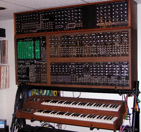

PostPosted: Sat Aug 21, 2010 5:06 pm    Post subject: Got this year's modules installed in a new cabinet Reply with quote  Mark this post and the followings unread
I decided to have a friend of mine (a professional woodworker) build a cabinet to house the new modules.
The cabinet is made of mahogony and is large enough to hold 17 3"x9" modules.
The new cabinet is the one along the top.
He also made another cabinet identical to the new one because I need the expansion space. I'll have to figure out where to put it!
The blank space will either become a Fixed Filter Bank or will house CGS wave folders -- probably the wave folders because the boards are already populated and it will be a "quick win" for me.

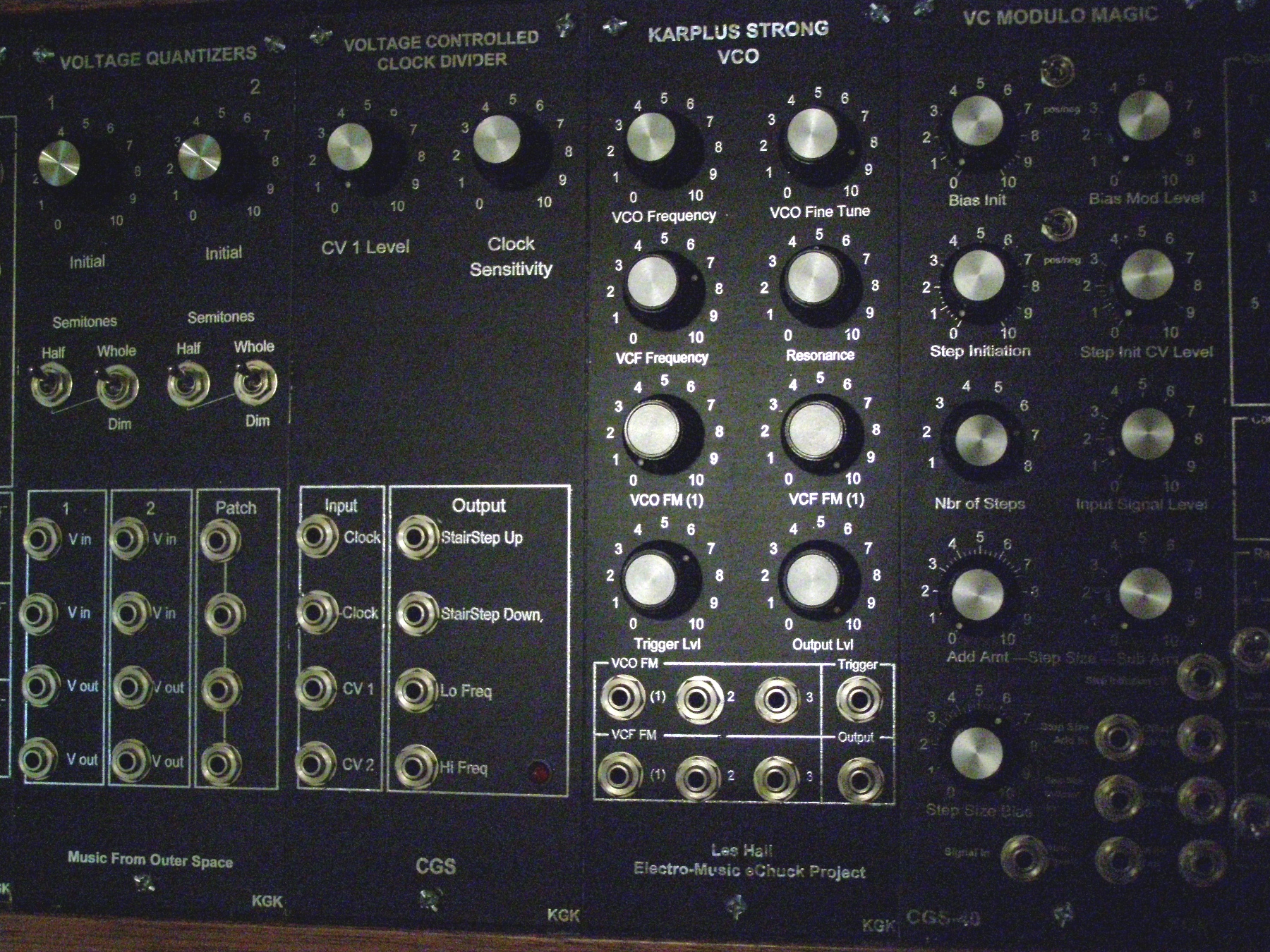

I also finished Les Halls Karplus Strong Oscillator and wrote about it on the K/S thread...
The new cabinet house the modules on the top row.

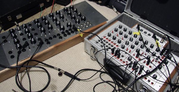

PostPosted: Tue Aug 31, 2010 9:52 pm    Post subject: Reply with quote  Mark this post and the followings unread
Nothing special, but it all makes some fancy noises when I need them..
Need to build a cabinet for them now
 Filesize:  143.32 KB
 Viewed:  220 Time(s)

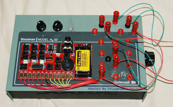

Long winded explanation about a bugbrand BoardWeevil 2009 mod:
Since I've had the bugbrand BoardWeevil, I've wanted to stabilize the touch pads so that I could hold one of those cool in-between sounds (Jetson-sy, babbling water, starve crunchiness, etc.). So I finally took the plunge and made a breakout box for it.
1. This breakout box has a lot of wires in it. When I get finished describing it, you'll probably be horrified. I added an LFO (directly below the Weevil, tapped right off of the positive and negative board origin right under the battery. It has tri and square waves, and a rate and depth control. Hardly need the rate part, because being able to change the waveshape greatly increases the playability. I took the design of Peter's at CasperElectronics - to add an LFO to the pitch contact in a Speak and Spell bend. The two banana jacks immediately to the right of the LFO (blk and red) are the leads from the LFO circuit that went to the pitch control(blk), and the V+(red).
The banana jacks (black) in a C shape just to the right of the BoardWeevil are laid out the same as the touch points on the Weevil, just turned CW 90 degrees. There are also 2 - 12 step rotary switches on the left side of the box - each connects to the same 12 touch points/banana jacks, so you can mix them up and play the switches. The jacks for the switches are the two red ones at the top of the "C". Unfortunately one of the switches feels like it will grind itself apart someday soon. I'm ordering better switches. They are non-shorting rotary switches. I bet your thinking - how much current have I robbed from the circuit? A lot. The starve knobs does not as acutely effect the sound. So I imagine it is always starving a little. The V+ seems to act like a voltage follower(?).
The potentiometer banana jacks are on the top right. They all have switches to turn them off. So you can prepare beforehand and add voices, or subtract them when soloing. The first, from left to right, goes to a photoresistor. The second to a single turn B1k pot. The third and the one diectly under it go to two 10-turn potentiometers. Those are the most gratifying of the breakouts because they can feel out the starved in betweens and hold them - sometimes they sound like they are sweeping a filter. Real nice. The last two pot breakout sections go to the x and Y axis of the analog joystick. The joystick is good for soloing, but it's range of motion (or quality) doesn't have any subtlety. It was the original accessory for the breakout box.
I don't know how I could have condensed this. Sorry
