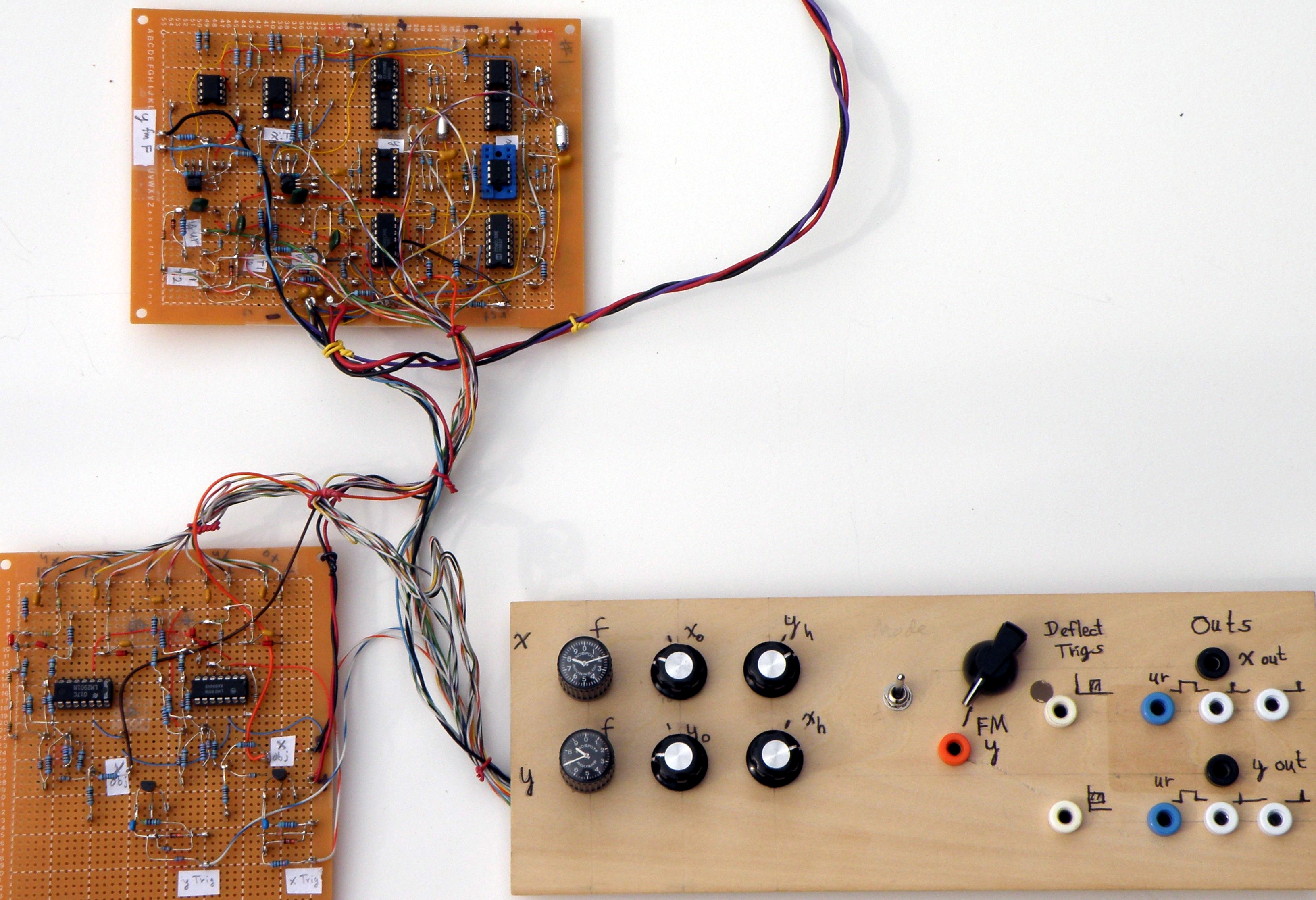

So here's a photo of the MegaCycler prototype as of now. I'm going to leave it as is for a while while I play with it some more, to decide whether the current parameter set is sufficient or if anything doesn't make sense to keep.
The upper board carries the two VCOs (the two columns on the right), the two expo converters, some signal scaling and the gate and trigger circuits. The lower board has the comparators to detect when the ball enters each object and trigger signals for those events.
The left side of the panel has controls for the oscillator frequencies and to define the position and height of the two objects. An FM input for the y direction has been incorporated. To the right of the FM control are the two trigger signals that signal when ball hits the object. On the right are all the main VCO outputs: the x and y signals, a gate signal for the upramp phase of either wave, along with triggers signaling the beginnings of the upramp and downramp segnents.
Ian
