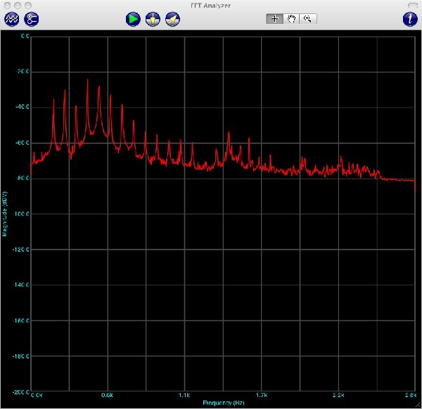

I've just downloaded the demo version of Electroacoustic Toolbox, which is basically a spectrum analyzer, scope, and other stuff for your soundcard. I measured some signals from the OYT guitar invention in both factory and invention switch position, and was rather surprised at what I saw.
In particular there was no additional harmonic content with the invention. I also noted that a super-sharp initial transient occurs with the factory setup that is not there for the invention (attack i guess you'd call it), and a greater content at discordant frequencies, i.e. frequencies not at harmonic multiples.

Sure Andy,
In this example I have placed the magnets near the bridge for the invention, and used the bridge pickup for the factory position. Pluck was done at middle pickup location of low E string, open (unfretted).
The spectrum in this case is very similar so it makes a good frame of reference for future comparison i suppose.
Les

Hi Les,
I bet if you tried other different mag pickups you would notice similar differences.
Different pickups sound very different, even combinations of different string types with different pickups produce very different sound.
My bet is also the attack changes as well but I must admit I have never thought of this before but it makes sense.

What I've learned from playing with the measurement software is four things.
1. there is NOT more harmonic content with the new pickup. It is about the same.
2. there is much lower dissonance with the new pickup (see above 1khz on low E string plots above)
3. the attack is much lower with the new pickup
4. the bass is less enhanced with the new pickup (a known flaw of coil wound pickups).
I'm wondering what part of the market is best suited for this pickup given those four observations.
