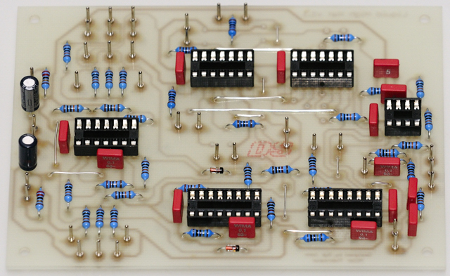

PostPosted: Fri Jul 29, 2011 2:10 pm    Post subject: Reply with quote  Mark this post and the followings unread
HexInverter wrote:
Oh no! Haha...when that happens, I usually get crafty and use some in series or parallel to get close to the right value I need Smile
Though if you're missing, say, 10 of them - that can be pretty annoying! Razz
This guys have been hiding in a vintage Dutch sugar box, but at at the end of the day the board is almost populated. Only the four 10nF caps are missing. I hope to get them by next week.
hide of resistors
 Filesize:  171.65 KB
 Viewed:  29497 Time(s)
mostly populated board.
 Filesize:  248.17 KB
 Viewed:  1855 Time(s)

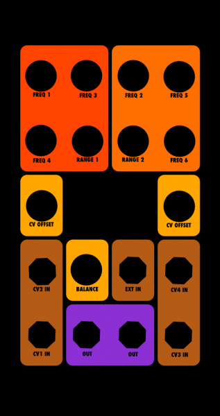

PostPosted: Thu Aug 04, 2011 2:26 pm    Post subject: Reply with quote  Mark this post and the followings unread
emdot_ambient wrote:
I havn't looked at the documents for a while...are you building the Bently or regular models?
I'm boring and will do the regular version.
It took some time to collect the front panel elements from various sources, now I come up with this draft:
Liquid Hihat panel draft, regular version
 Filesize:  48.63 KB
 Viewed:  3962 Time(s)

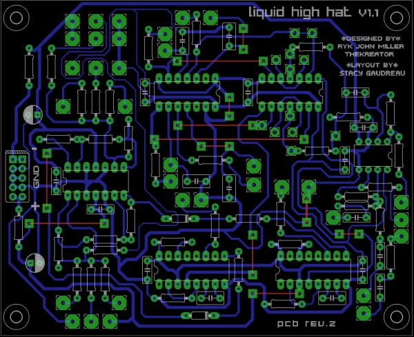

HexInverter
Joined: Aug 21, 2010
Posts: 338
PostPosted: Sun Aug 14, 2011 10:02 am    Post subject: Reply with quote  Mark this post and the followings unread
Well, the layout is pretty much done!
And, I am pleased to announce that having shaved roughly 10mm off the length of the board, I have reduced the cost enough to incorporate silk-screening into this design! The board comes in at a cool 111mm wide, now.
I have also tweaked a lot of custom parts to get the silk-screen the way I want it to look. A lot of care has gone in to making it easily readable, and aesthetically pleasing.
The boards will still be NON solder masked, but that is only to facilitate easier trace-cutting for the Bentley Mods!
Also, 2.54mm (.1") pitch standard headers have been added to accommodate those of us with Eurorack modulars. Now you can just use a chunk of 2x5 pin header and interface directly with a Eurorack style power distribution board! Or, don't, and just install wires in the header's place instead! A silk-screen legend has been added to make sure you don't connect the power to the board improperly.
Here is a little teaser! I am working on getting the funding for the next board run. I should have them ordered in a few weeks!
 Filesize:  961.45 KB
 Viewed:  3967 Time(s)
