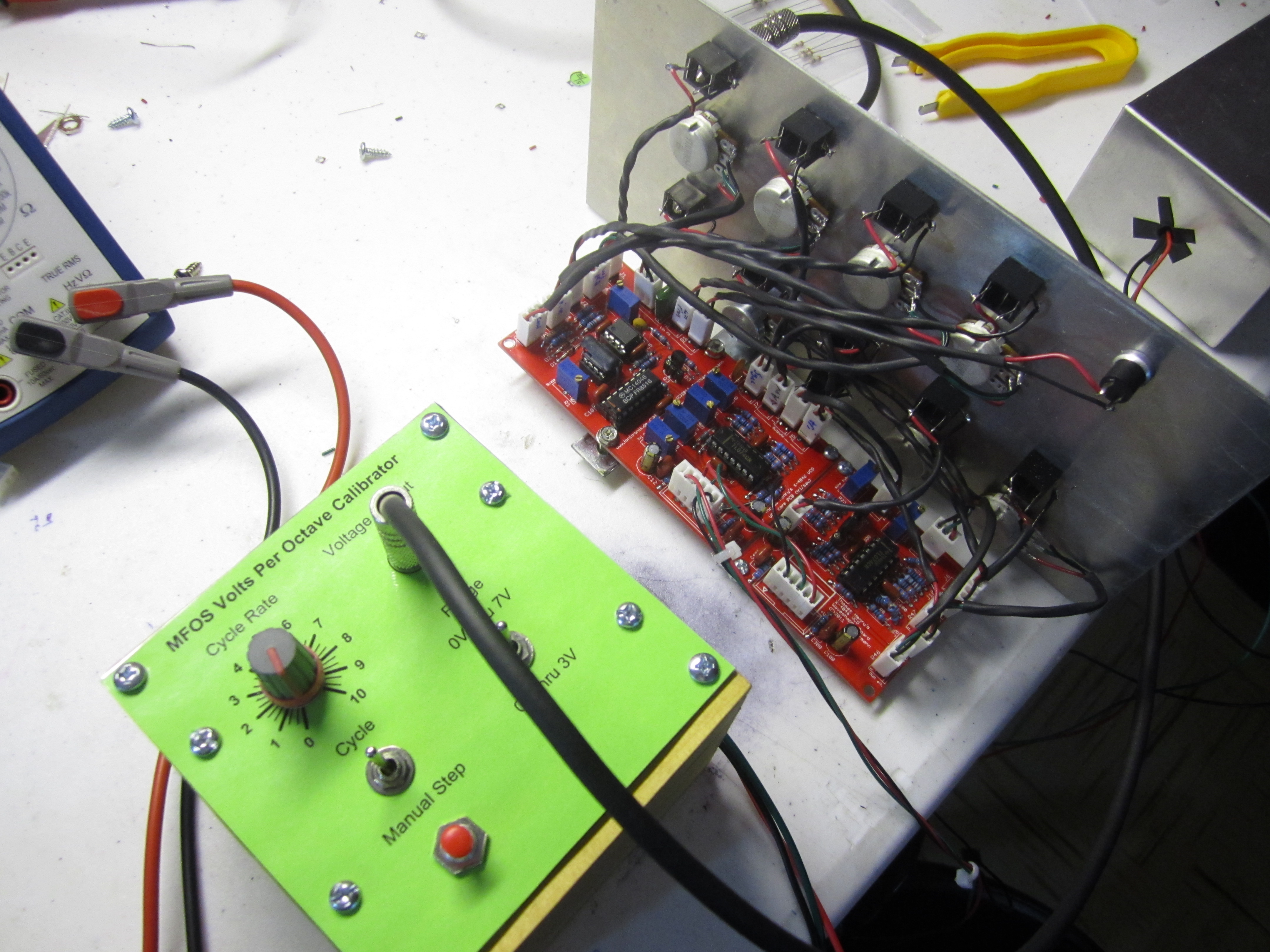

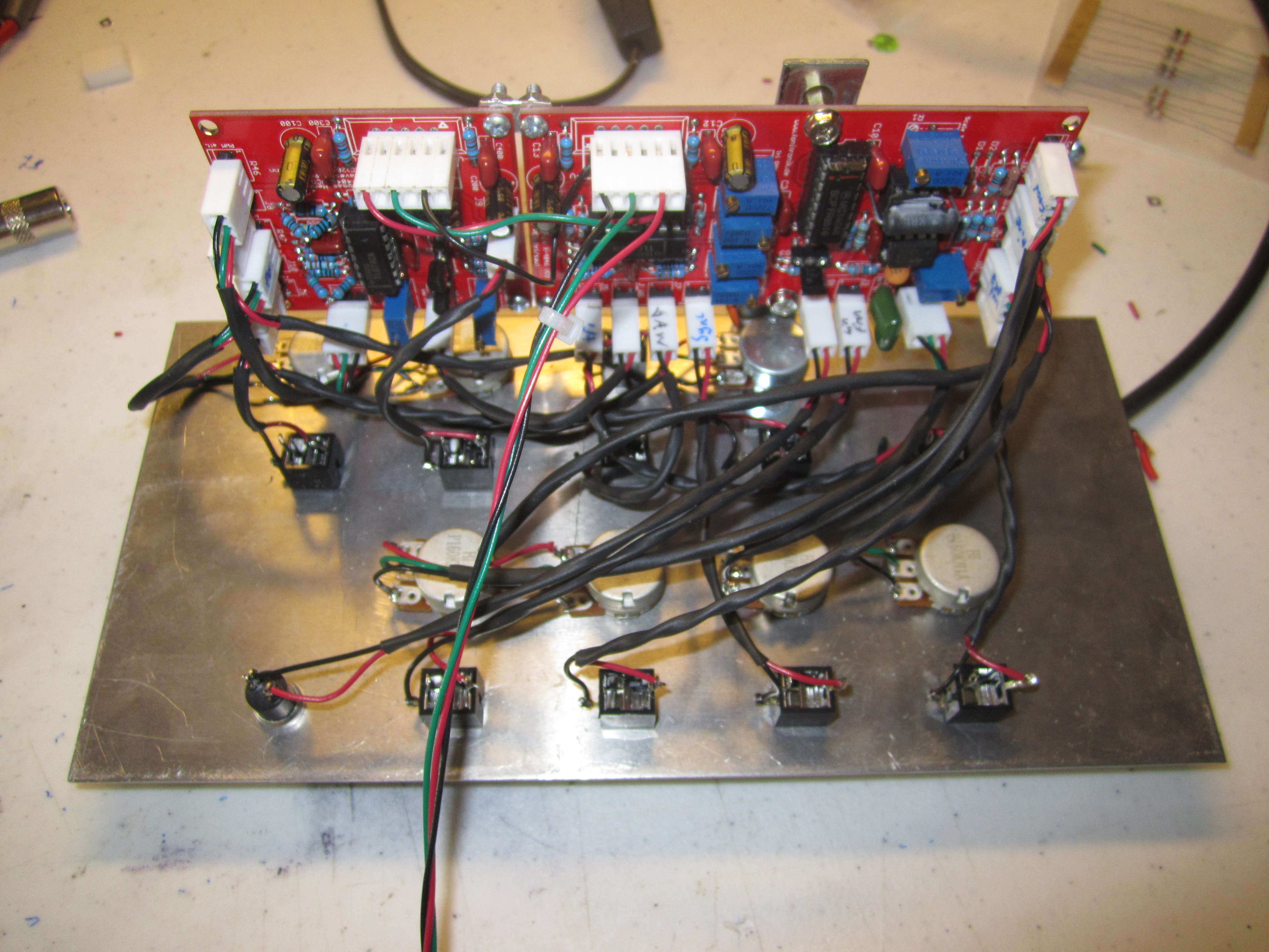

Finished mine last night. Working on calibrating it now. I have only been doing DIY synths for about 3 months. This is my 4th completed module. Calibrating is going OK so far. When the VCO gets into higher octaves, it cuts off. Powering it off then on brings it back once the frequency is turned back down. Not sure if this is a characteristic of my 4046 or not (which is a motorola). The HF trimpot is set to maximum resistance per Thomas's calibration instructions. I am going to continue calibrating with tools now. However if anyone has any input it would be gratetfully appreciated. So far I am very happy with it. A very big thanks to Matthias and Thomas for this great project.

| Completed X-4046 VCO & MFOS 1v\oct calibrator |

ive built one now and am finding myself here because i could not tune 1v/O whatsoever.
i now see that the ON semiconductor 4046 was a fail and that's what ive got in it now.
i also have the nxp 4046 and will be installing it tonight to see if my results improve.
other than the tracking problems (about a semitone per two octaves), im enjoying the sound of this oscillator.
the "pips" in the triangle wave make it buzzier than others in my system,
but the osc FMs wonderfully and has a very wide range, well down into lfo territory.
edit:
problem #1: 100k in R2...changed that to 390R
i then swapped out the ON PLL for the NXP PLL--wow, what a difference.
it was remarkable how much my waveform improved. i can barely see the pips in the triangle now
its calibrated very well now and it sounds fantastic. cant wait to build the next one

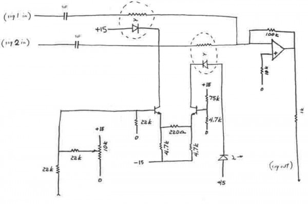

the vactrol is a vc resistor. so the ldr part would do the job of the pot, while it's controlled by a cv applied to the led side of the vactrol.
i've seen an example of a voltage divider somewhere around here in a thread not so long ago. that explained quite well how to use a vactrol. |

that's what i was thinking of (buchla/mark verbos?). i recently ordered some H11F3 optocouplers, which are much cheaper than vactrol. i hopefully will be able to adapt the above ciruit easily... _________________

| Quote: | | i hopefully will be able to adapt the above ciruit easily... |
Well, one could build a little standalone module with the above circuit and use it to crossfade the triangle and saw outputs of the x-4046.
It would be usefulf for many different tasks anyway.
And is probably very easy to build, even on veroboard.
