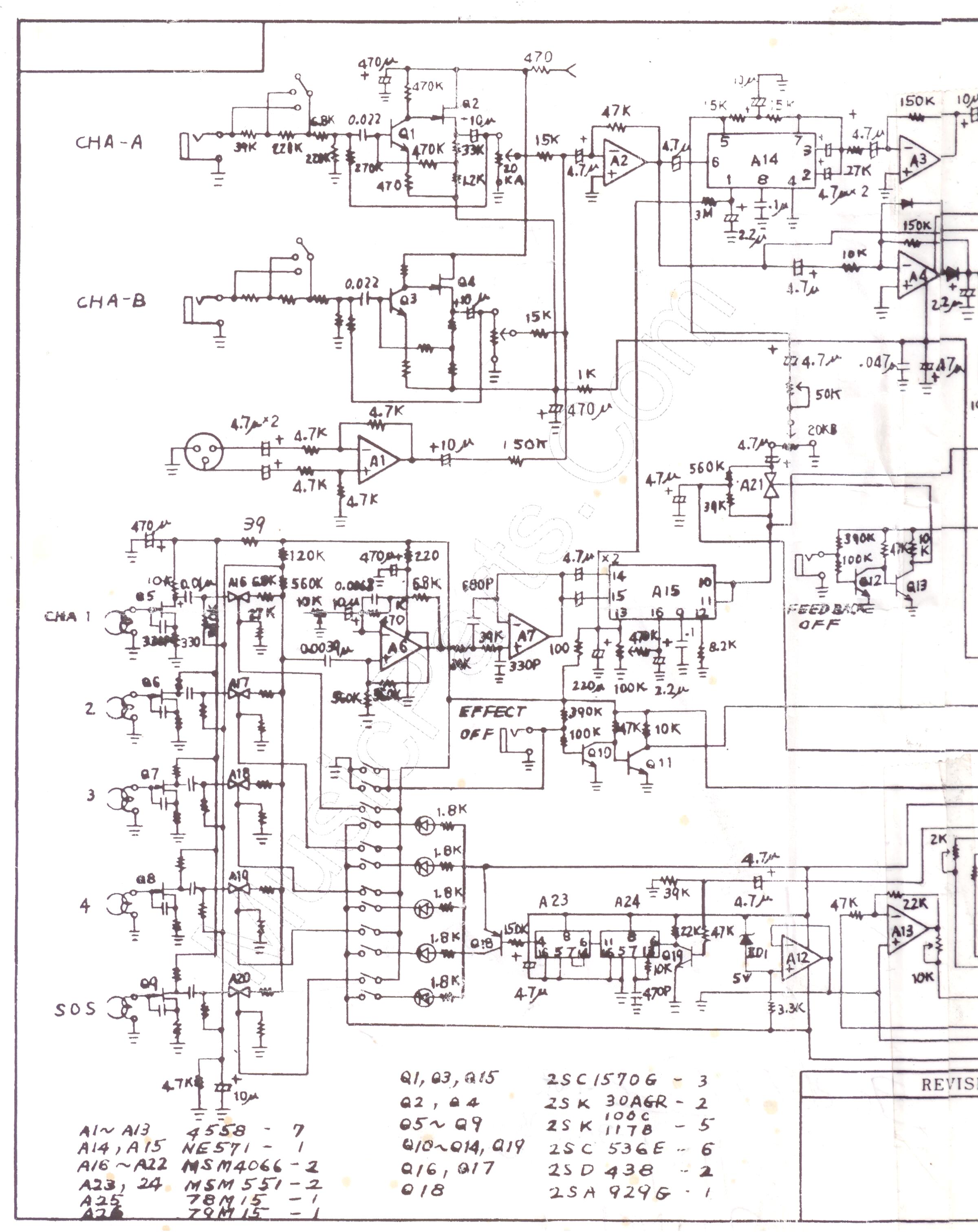

I've got a non-functional Korg tape delay just sitting around waiting for repair. I've tried replacing all kinds of parts, but I can't get it working. It's an electronic problem, not mechanical.
I've wondered if maybe the western substitute parts I've used are what's keeping it from working. There's an "MSM551" and "MSM4017 which I think are both CD4017s, and there's a "MSM4066", a CD4066. But I have no way of knowing if they're exactly the same.
Anyone have any experience with this Korg, or these Japanese parts?

This is the same thing that was wrong with mine! It got so bad that the echo became so faint as to be inaudible. I started trying to replace some of the CMOS chips, which happen to be japanese--but I figured they'd be the same, and I made it worse. It has this CMOS switching arrangement where the different tape heads combine and mix. I didn't know what else it could be.
Now, the LED indicators don't light up when I switch between the different head positions. But the audio still passes, and everything else is the same.
Most everything works, the Motor, the tape assembly, etc. Audio passes fine, so it's super frustrating-- mine worked very well for a short period of time. It's an amazing echo chamber, maybe not quite the sound of a Roland, but only because the noise reduction system on the Korg takes a bit of the rawness out of the sound.
I have the schematic, I can try to scan it at work and then upload it here(?)

I have some interest in this thread, my SE500 still works fine but its only a matter of time 'til something gets too old. Be good to see the schematic and between us we might be able to work out the problem.
I'm don't think the MSM551 is the same as a 4017. Its BCD rather than pulsing outputs Q0-Q9, the 4029 can be configured as a BCD decade up counter.
OK, I don't have the schem in front of me, and I may be confussed about this-- but, in my SE500, although the schem specifies MSM551s, the chips that were actually in there are labeled as MSM4017. So, I tried replacing them with CD4017, HEF4017. No dice. I also tried replacing the MSM4066s with CD4066s on the main board. Replaced the 1458 Op Amps too. In doing so, I also installed sockets. I don't know if I plugged something in wrong or made a soldering error, but somewhere along the way, I lost the LED indicators as well as the echos.
I actually don't know sh!t about electronics, so maybe when I post the schematic, someone will be able to understand what might be going wrong.

Korg SE500 Schematic, part 1 and 2.
If there's a better place for me to post these, let me know, and I'll move them.

Thanks Eric, much appreciated.
I seem to have "fixed" mine by simply taking it apart and putting it back together, and cleaning the heads a bit. I'm not super confident that it will stay fixed but it is sounding much better, for now.
thanks and good luck,

I seem to have a similar problem with my SE500.
I can hear a little bit of echo, but the volume is very low, the sound is very dull and I can hear maybe two or three taps of echo.
Ít could be the tape that needs replacement, or demagnatising the heads.
Anyway, if you solved your problems, i'd like to hear wath your solution was.
I disassembled mine yesterday, but that didnt do the trick. It actually made it worse. The motor is not running now, so i hope thats a losse connector or something.

Update;
I checked for loose connectors and indeed, the connector to the motor was loose, so that was an easy fix.
I demagnetised the heads and other metal parts along the tape path. I also cleaned the heads again with 97% alcohol.
I have a somewhat normal echo right now. The feedback is still not at its maximum potential, but the tape is really old and thus crap. I have to order or make a new tape and i guess that will solve the rest of the problems.
