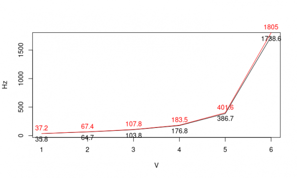

PostPosted: Sat Mar 24, 2018 2:46 am    Post subject: Reply with quote  Mark this post and the followings unread
Hi all
I'm just getting started with DIY synths and this is the first module I'm trying to build. Just populated the PCB from fonic.
The waveforms sound good so far and I'm getting a frequency response from sub until above audible.
However, I'm having a problem tuning the module.
When I apply CV (0V-5V) to the V/Oct I get an exponentially rising frequency response.
Can't figure out what could be the problem. Do I have a wrong IC?
Would really appreciate if someone could hint me in the right direction.
PostPosted: Sat Mar 24, 2018 3:00 am    Post subject: Reply with quote  Mark this post and the followings unread
Isn't exponential what we want?
for each 1V increase the frequency doubles.
linwop
Joined: Mar 24, 2018
Posts: 7
Location: Switzerland
PostPosted: Sat Mar 24, 2018 4:51 am    Post subject: Reply with quote  Mark this post and the followings unread
Hmm, true. I was thinking that'd be a linear relationship with a slope factor of 2.
In that case I just don't get the right adjustment range with the V/Oct trimmer.
Checked the Resistors and they should be fine.
Powering from +-12 V and did the resistor adjustments you suggested in your thread.
These are the frequency responses I get with the V/Oct trimmer set to min (black) and to max (red).
The voltages is actually from 0-5 and not 1-6

PostPosted: Sat Mar 24, 2018 5:35 am    Post subject: Reply with quote  Mark this post and the followings unread
the resistor adjustments for 12V don't change anything in the expo converter, though. they just correct the output levels.
Don't touch the HF trimmer for the start. Does the 1V/oct trimmer do anything?
[edit: i get it from your post that the trimmer works. and the curve you posted above shows very roughly the response we expect. it is just not right to the point that it would be musically useful yet]
For each 1V change on the 1V/oct input you should see a change of about roughly 18mV at IC3A/pin1.

PostPosted: Sat Mar 24, 2018 6:10 am    Post subject: Reply with quote  Mark this post and the followings unread
Correct!
I did some quick measurements before I went out:
0V: 0.026 mV
1V: 0.011 mV
2V: 0 mV
3V: -0.013 mV
Looks like it's off by 5mV.
Thanks a lot for your help fonik!

PostPosted: Sat Mar 24, 2018 6:52 am    Post subject: Reply with quote  Mark this post and the followings unread
maybe i'll chime in here and hint you to this excellent Explanation on how to trim for V/oct Response:
http://www.yusynth.net/Modular/EN/VCO/index.html
Can be found near the bottom of the page, hope this helps if you were not familiar with it.
I for this purpose used a step sequencer with single step advancing button and reset to step 1 button then first dialed in the CV's 0, 1, 2, 3V etc. on the individual steps in and then started at 55Hz advancing each step manually and having a DVM with a frequnecy counter hooked up to my Output, while trimming it... on most VCO builds it took not much time and effort and was working well for me.
Cheers Bastian
PostPosted: Sat Mar 24, 2018 7:03 am    Post subject: Reply with quote  Mark this post and the followings unread
With an 100k input resistor and 2k in the opamps feedback the calculated the actual change before(!) the trimmer should even be 20mA.
Something seems to be wrong here. Either it is one of the resistors, or it is your voltage source. (Please, don't take this personal, but just two weeks ago someone contacted me having issues with his VCO MAXIMUS which would not track. In the his voltage source was not calibrated and way off, so 1V increase was not 1V really.)
Anyway, the problem is pretty much encircled, which is good.

PostPosted: Mon Mar 26, 2018 3:48 am    Post subject: Reply with quote  Mark this post and the followings unread
Cheers Bastian
Hi Wackelpeter
Thanks a lot for that info!
Turns out there's nothing wrong with the circuit. Managed to tune it with this guide. Was using the 5V output of an Arduino previously and used a Voltage divider to get roughly 0-5V.
But used a sequencer as you recommended this time.
Thanks a lot for your guidance @fonik and wackelpeter!
PostPosted: Mon Mar 26, 2018 3:51 am    Post subject: Reply with quote  Mark this post and the followings unread
linwop wrote:
...Was using the 5V output of an Arduino previously and used a Voltage divider to get roughly 0-5V.
that is almost exactly what the other person i was mentioning did. alas, a simple voltage divider won't be precise enough and w/o a buffer you might run into serious problems.
anyway, i am glad you gor it sorted out.
