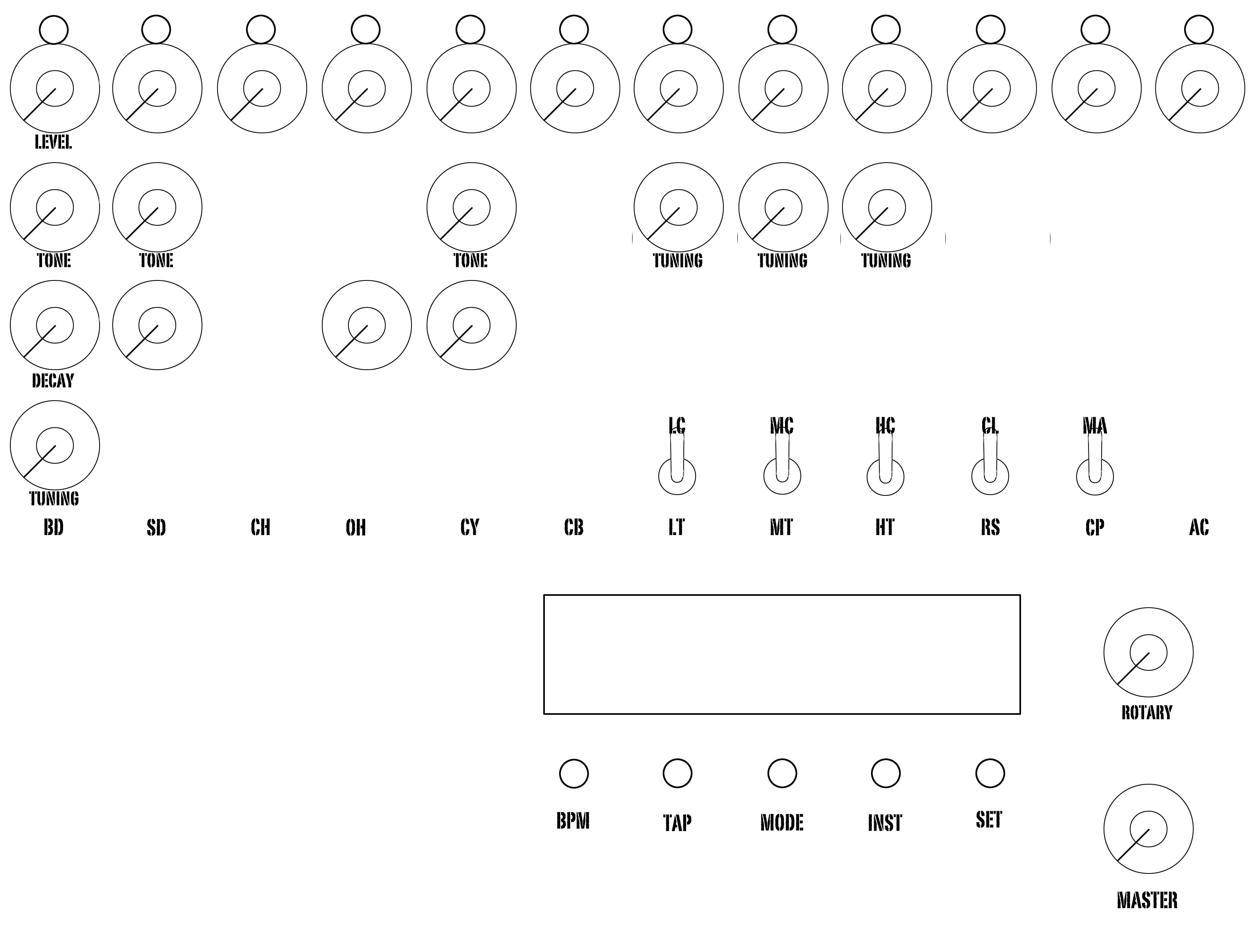

PostPosted: Sun Apr 07, 2013 8:06 pm    Post subject: Reply with quote  Mark this post and the followings unread
So I have a piece of 10.5" x 8" aluminum left over as a spare from another project, so I was trying to think how I'd lay things out with my arduino controlled 808. The fact that I re-ordered the voices would probably drive someone familiar with the original crazy, but aside from the accent, they're somewhat in the order I would expect them to be used--with the exception that I've grouped the cymbal family so the cowbell is over with them instead of at the far end where it belongs Smile.
The circles across the top would be LEDs for each voice (blinky lights!), and the circles below the LCD display are momentary switches. The idea being that the sequencer interface would mostly involve pressing an appropriate button and turning the rotary. With no button pressed it would move the cursor from step to step, at which point the "set" button would turn that step on for the current instrument.
Currently missing are start/stop, reset, and clear buttons which I think should probably stand on their own somewhere in the open space to the left.

sneakthief
Joined: Jul 24, 2006
Posts: 569
Location: Berlin
PostPosted: Mon Apr 08, 2013 4:19 am    Post subject: Reply with quote  Mark this post and the followings unread
