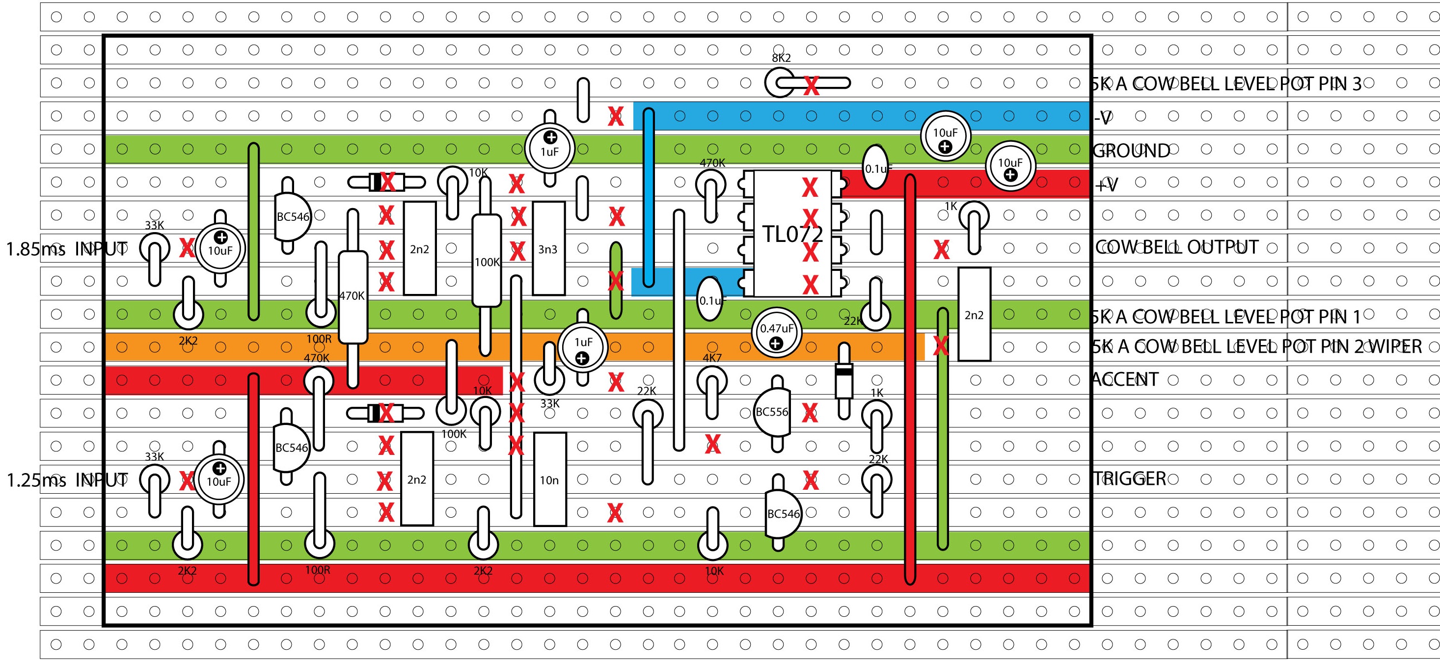

Good question. What I used to do is hand draw with pen, loads of holes between lines on a note pad to represent the stripboard tracks. I'd then draw the components in pencil so I could easily erase them.
Then I drew up stripboard paper! I could print it out and draw in pencil on it.
I then went one step further. I drew up components in Illustrator. What I do now is I work directly in Illustrator. I import the schematic first onto a layer. I arrange my stock components by copying and pasting. At first I work roughly. I use a red X to represent the cuts. I colour the + GROUND and - in red, green and blue so I know what I'm doing. It's handy to start with an IC and work outwards from that. I just follow the schematic. Then it's a matter of shuffling things around to make the footprint small. It's an intellectual challenge, like sudoku, and very relaxing. Laughing Once the rough looks ok, I make the board. If it doesn't work, I try figure out where I went wrong. If it looks like it is going to take too long figuring it out, I just try a different layout. When I get something which works, I then draw it up again and make it look pretty. I've got quite a lot of stripboard layouts here I have drawn but never posted. Mainly MFOS stuff and CGS...
Here's the stripboard paper anyway. If you have a vector based programme like Illustrator, I can post the .ai file with all the resistors, jumpers, caps, IC's you'll ever need Very Happy
EDIT: yeah it's good to NOT cut the traces. That's part of the challenge... of the gentle art of stripboarding. Laughing It's not so easy when you have transistors all over the place.

Wow, that's cool, thanks Smile
I have Photoshop, but not Illustrator...well, it's not installed I may have it hiding somewhere. I'll check it out and get back to you.

I like LochMaster for doing stripboard layouts. It has a pretty good selection of usable components and lots of functionality specific to stripboarding. Uncle Krunkus seems to be the master of the medium (IMO), as it was his work that got me started with it. Just my 2c.

Unfortunately Lochmaster is PC only and I currently don't have a multiboot installed Sad
DIY LC is pretty basic and buggy, but it does the job as well...
I've tried Illustrator for stripboarding before, but I was having trouble with properly aligning elements to the grid. I also found scaling components a bit of a chore. How do you deal with these issues? Are you using 'Symbols'? If you don't mind, I'd love to take a look at your file as well cyclops ...

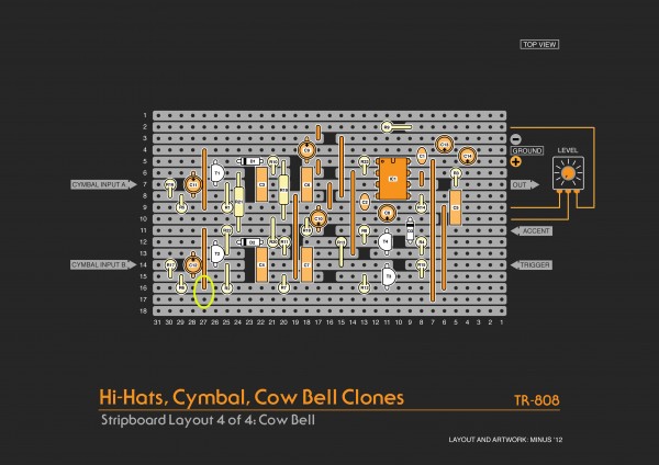

minus great layouts.

PostPosted: Tue Sep 18, 2012 3:10 pm    Post subject: Cow bell not working Reply with quote  Mark this post and the followings unread
Hello minus, I stripboarded the sound source and work perfect.
I stripboarded the cow bell and doesn't work, please can you check your layout?
Transistors T1 and T2 are in the correct place?
Thanks.
-minus-
Joined: Oct 26, 2008
Posts: 787
PostPosted: Tue Sep 18, 2012 8:02 pm    Post subject: Reply with quote  Mark this post and the followings unread
Hi. Sorry to hear the cow bell isn't working for you so far. Yes I can confirm that T1 and T2 are correct. I've uploaded my rough I did before I redrew the posted cow bell diagrams. It will give you an idea of the power rails etc. Red is the positive, blue the negative and green is ground. The orange rail was for my own reference so I wouldn't get confused with the two 100K resistors coming off those diodes. The red X's are cut marks. I worked off this diagram, then I opened a copy of it and simply redrew it neater over the top. Check that you have made all the cut marks in the correct places. Check that your components are in the right holes. If you look at the schematic from the service manual I posted on page 1 of this thread, you can compare it one step at a time with the stripboard layout. It's a fairly small circuit.
I assume you are feeding it from the sound source correctly from the... oh... wait a sec. I had the inputs incorrectly labelled! Embarassed They are meant to be cow bell input, not cymbal input. I'm not sure this will be your issue though, but make sure you are taking wires from the noise source cow bell outputs to the cow bell board at the correct points. I have just updated the original diagrams on page one of this thread. SORRY!
Check your power to the board... check the sound source to the cow bell board Laughing ... check your cut marks are all done and in the right places... check components are all in place... check components are of the right value and orientated correctly... inspect the bottom of the board for solder bridges, cold solder joints, cut marks which haven't cut through the stripboard copper...
Let us know how you get on.
EDIT: Check that you have the accent tied to the +V when you test it. Leaving it unconnected will result in no sound.

PostPosted: Thu Sep 20, 2012 1:17 am    Post subject: COW BELL! Reply with quote  Mark this post and the followings unread
Ok minus, big thanks for your explanation! Fantastic layout.
I found a difference between booth layouts, I marked in yellow the jumper at strip 16/17, which one it´s correct?
 Filesize:  1019.98 KB
 Viewed:  1510 Time(s)
-minus-
Posts: 787
PostPosted: Thu Sep 20, 2012 1:50 am    Post subject: Reply with quote  Mark this post and the followings unread
Alfredo that is excellent spotting! thumb up You should be working for Roland! Laughing That jumper should be going to the + rail as seen in the rough version. You need to extend the jumper one hole down. I have no doubt this is the cause of the problem. I shall now update the artwork and repost. Thank you so much for spotting this. I try to make these images correct but an error can slip through. I'll check all the others and see if I have gone wrong with them. I do check these things by ticking off the parts with a pink line on a separate layer. Somehow this slipped through. Please post again when you have the circuit working for you.
