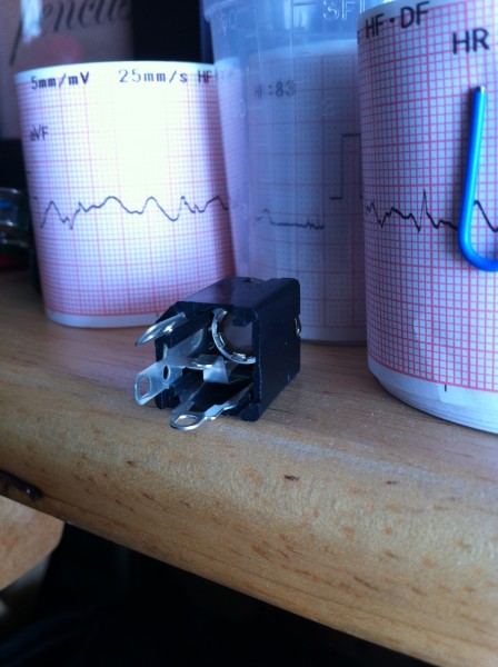

PostPosted: Thu Apr 25, 2013 11:27 am    Post subject: Reply with quote  Mark this post and the followings unread
How exactly would i connect these jacks as normally open vs closed?
I assume that right-most would be ground? Would normally open mean that I do not connect the middle connector (does this middle connector correspond to the arrow in Thomas' normally closed I/O)?
 Filesize:  1.75 MB
 Viewed:  271 Time(s)
PostPosted: Thu Apr 25, 2013 11:51 am    Post subject: Reply with quote  Mark this post and the followings unread
Ne'er the twain shall meet.
Normally Open and Normally Closed jacks are not interchangeable.
That jack is normally closed, and the lug on the slanted corner is ground, the next lug counter clockwise is the switch (what the "arrow" represents in Thomas' schematics), and the next lug CCW is the signal.

PostPosted: Thu Apr 25, 2013 11:55 am    Post subject: Reply with quote  Mark this post and the followings unread
These are normally closed but you said they could be wired in a way that they act normally open.
My question is, for example, on the ADSR's J2 plug, which of the 3 prongs is connected to ground, +15V, and the 100kohm accordingly?
Edit: Ah, so from top-to-bottom, the connections would be: ground, +15V, 100kohm?
PostPosted: Thu Apr 25, 2013 12:48 pm    Post subject: Reply with quote  Mark this post and the followings unread
I don't recall saying that they were interchangeable, was just trying to explain where "normally open" and "normally closed" made sense since you seemed to be confusing jacks and switches....
Edit: Yes I think that's right, but I don't have AS4t21C handy to me when I'm working in the office....

PostPosted: Thu Apr 25, 2013 1:41 pm    Post subject: Reply with quote  Mark this post and the followings unread
elmegil wrote:
NO is Normally Open. NC is Normally Closed.
A normally open jack is a standard 1/4" mono jack.
A normally closed jack, has a third connector, and if there is no jack inserted, whatever goes to that connector is then routed to the tip input. In this doc, that's indicated with the arrow pointing at the jack's tip. So on the ADSR for example, you have 15V to the gate unless there's a plug inserted in which case it takes the gate signal from the plug. For the ADSR this lets it operate in a "just triggered" mode. Similarly, the normalling of the trigger input lets it operate in "just gated" mode.
You can use a normally closed switch in place of a normally open one, you just don't use that third connector...
