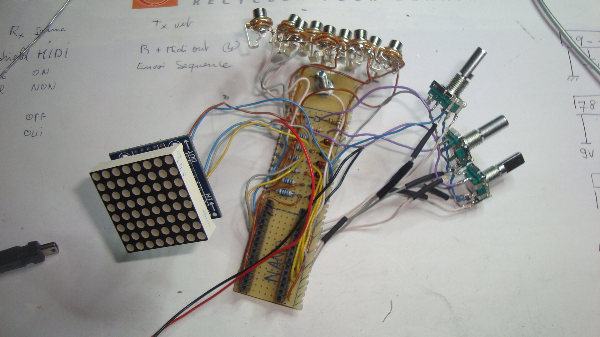

PostPosted: Mon May 25, 2015 7:13 am    Post subject: Reply with quote  Mark this post and the followings unread
Thanks for the input protection Smile
But I can't test because I've a problem ...
When everything was on a prototyping board, all was working good.
And I wanted to put everything in a eurorack module.
I drill my frontplate and put all the component inside.
Then the module worked about one minute and freeze.
I restarted it and the matrix flash all the led's one second and stop.
And then, no more action...
I tried with another arduino nano, and it was the same, work one minute and freeze.
Then I try to restart and it just turn on the led one second ... that's all
I tried with all the components out of the module because I thought the groung with the plate was bad,.... no more result ??
I tried the arduino with the code matrix demo, and the matrix plugin.
It work !! so the Nano was not dead ... or maybe only the output for the matrix ??
I put the euclidean code to check, and the leds flash one seconds and stop lightning ....
I don't know ....
I checked all the welding point and the connexion, all seem to be good and at the good place...

PostPosted: Mon May 25, 2015 4:42 pm    Post subject: Reply with quote  Mark this post and the followings unread
Oops! I noticed the schematic image is an older version. I'll post the new one tomorrow - the switches should be:
+5v -- 15k -- switch -- 15k -- switch -- 15k -- switch -- 15k -- GND
dub halley: try clearing the eeprom with this code and then reloading the euclidean program...

PostPosted: Tue May 26, 2015 1:55 pm    Post subject: Reply with quote  Mark this post and the followings unread
Hi
I did the modif on the circuit.
Thanks for the tricks with he eeprom clear !! Very Happy
But there is a mistake, Arduino didn't want to compil because of the :
#include <EEPROM> on you example the .h missed... Wink
Thanks to you I find on the example in arduino IDE,
Files/Examples/EEPROM/eepromclear
And it work ..... not well but works.
The encoders didn't have a real effect
I tried with a spare max7219 and another matrix, arduino and encoders
It's the same problem, so I think they are not the coupable.
I re-cheked all the circuit two times.
And if the encoders are not well wire ??
Could thez "satured" the in of the Duino ??
It look like an overload ???
See on the video below...
any ideas ?? Very Happy
Thanks

PostPosted: Tue May 26, 2015 2:11 pm    Post subject: Reply with quote  Mark this post and the followings unread
EC11 encoders shouldn't have any issues.
The debugger lets you verify your encoder movements to see if they're working OK:
Set it to #2 then set your Arduino serial port monitor to 9600bps:

PostPosted: Tue May 26, 2015 2:30 pm    Post subject: Reply with quote  Mark this post and the followings unread
on the serial monitor I see that the encoder didn't work ....
I swapped them in different ways ...
I tried new ... Strange ?? I smell a rat
Thanks Very Happy

PostPosted: Tue May 26, 2015 2:54 pm    Post subject: Reply with quote  Mark this post and the followings unread
My guess is that the encoders are connected incorrectly.
Maybe this will help: http://www.hobbytronics.co.uk/arduino-tutorial6-rotary-encoder

PostPosted: Wed May 27, 2015 1:31 pm    Post subject: Reply with quote  Mark this post and the followings unread
Hello
Ok, I tested with the code in the Arduino IDE
Files/Examples/Encoder/TwoKnobs
And in the serial monitor I check each encoder.
I saw an increase/decrease number for the 3.
But, if i scroll (not so) speed the encoder "panic" as you can see on the picture below
Is it the reason of the problem ??
I'll check another time the circuit now

PostPosted: Wed May 27, 2015 3:14 pm    Post subject: Reply with quote  Mark this post and the followings unread
Hi
I'd uploaded the euclidean code V 0,3 in the Arduino.
When I opened the serial monitor I saw :
nn=0 kk=0 oo=0
I moved the encoders one by one, and nothing happened ...
Suddently 1 appear at nn=1 (picture)
And when I saw this 1, it was the moment of the Arduino's freeze
During the freeze, I cannot open or use the serial monitor, the Duino lost contact with computer ....???
I resume :
I re-check with the code ledmatrixdemo (in led control library)
The matrix Work
I checked with the twoknobs (in encoder library)
The encoders work
I checked the circuit, I'm sure.
The Nano work
Still searching Smile

PostPosted: Thu May 28, 2015 7:44 am    Post subject: Reply with quote  Mark this post and the followings unread
Dub Halley - I'm sorry to hear it didn't work out so far. So far this code has been successfully tested with a few different encoders.
It's very hard for me to speculate here, but it's possible the batch of encoders you got from eBay simply aren't working well with the encoder library.
The encoder behaviour you mentioned when rotating it quickly is definitely suspicious.
This could be from encoders that aren't built well enough and put out "noisy" signals.
Also, I suppose that's the nature of these eBay components... I've noticed that you never know exactly what you'll get as parts can vary between shipments.
Also, does anything happen when you push the encoder buttons? The different LED's corresponding to each of the 3 channels should turn on depending on which button you press.
If you're absolutely sure that your wiring is OK and you don't have any ground problems, try out different encoders.

PostPosted: Thu Jun 04, 2015 2:51 pm    Post subject: Reply with quote  Mark this post and the followings unread
Hello
Sorry for the lag ...
Don't be worry it's not your fault Very Happy
More difficult a DIY module is to build, more fun when we('ll) have to use it with the modular Cool
I read a good article in this wonderful french review : http://www.hackable.fr/
There is inside : encoder, how it's work.
Here a picture from the web.
I add an 100nF Capa from the switch to gnd and to get an anti rebound switch.
It worked a little bit better when I tried with the example of the encoder library.
But it's still not exact ...
I command 6 of the conrad encoder ... we'll see ...???

PostPosted: Fri Jun 03, 2016 6:50 pm    Post subject: Reply with quote  Mark this post and the followings unread
after a previous aborted attempt i came back to this project and ive spent so many hours today trying to prep a shady nano to get this working.
i just have to share the following- if anyone has issues getting the arduino program to talk to their chosen board, please visit codebender.cc and this takes 10 mins, mostly automated.
at last i can start the build proper! but tomorrow. first i need to sleep

PostPosted: Tue Jun 21, 2016 5:51 am    Post subject: Reply with quote  Mark this post and the followings unread
First off, I found a bunch more bugs in Tombola's code & wiring guide. I'll post a revised version in the next couple of days.
1. Power consumption & led brightness
The brightness can be set between 0 at 16. When it's 0, it's actually pretty readable and comfortable.
Some power usage that I've observed:
60-80mA / 5V at brightness 0
120-160mA / 5V at brightness 8
140-180mA / 5V at brightness 16
I also fixed a bug with the startup and sleep animations that overrides the brightness variable.
2. Added a pulldown resistor
There should be a 10k pulldown resistor that connects A2 to ground. The voltage divider that the 3 switches use to select channel leaves the analog input floating when not pressed and makes the buttons unreliable.
I also modified the analog readings to match the new button values.
3. eeprom corruption causes arduino to go blank
The eeprom sometimes gets corrupted due to the way it's written. I'm making a more robust eeprom reset procedure. In the meantime, use this code to clear your eeprom - afterwards reprogram it with the euclidean code:

4. Weird characters like those shown in earlier posts
Most matrices have 2 connectors: one for input one for output. Make sure to connect the arduino to the connector on the matrix that has the DIN pin and not the DOUT.
5. Test your encoders!
Use this encoder test program to see if your encoders are connected properly. I modified the original "TwoKnobs" sketch match the project using the arduino Serial Monitor

PostPosted: Tue Jun 21, 2016 5:53 am    Post subject: Reply with quote  Mark this post and the followings unread
Code now on github: https://github.com/sneak-thief/Tombola_Euclidean_Sequencer
Latest schematic:
Hardware updates:
- tested as working with this LED display from Bay:
http://www.ebay.com/itm/131497841320
- 10k pulldown resistor to GND on the A2 switch inputs
- Switch inputs go to AREF instead of the normal 5V
- I now use 10K resistors because they're more common and more likely to be already on hand. If you're using 15K resistors, it's easy to change the code to make it compatible.
- You can substitute 220R resistors instead of 200R resistors if that's more convenient..
Software updates:
- Added more error checking for eeprom reads / values to reduce risk of crashes
- Fixed brightness define bug which prevented brightness from being set
- For those who tried the previous code and only saw a blank screen, Tombola had programmed the screen to only turn on after the first trigger, otherwise it would stay in "sleep mode". The screen also goes into sleep mode after several minutes of inactivity.
- I changed the default mode to automatically run from a fixed speed internal clock until it receives a pulse, then it only triggers externally.
Sneak-Thief - raw electrofunk

PostPosted: Thu Aug 11, 2016 7:50 am    Post subject: Reply with quote  Mark this post and the followings unread
Hello sneakthief!
Thank you for your work on this project. With your latest version (0.7) and some eprom clearing, I finally got it working!!
Only issue now is the channel selection. What do you mean with
Many thanks, again
