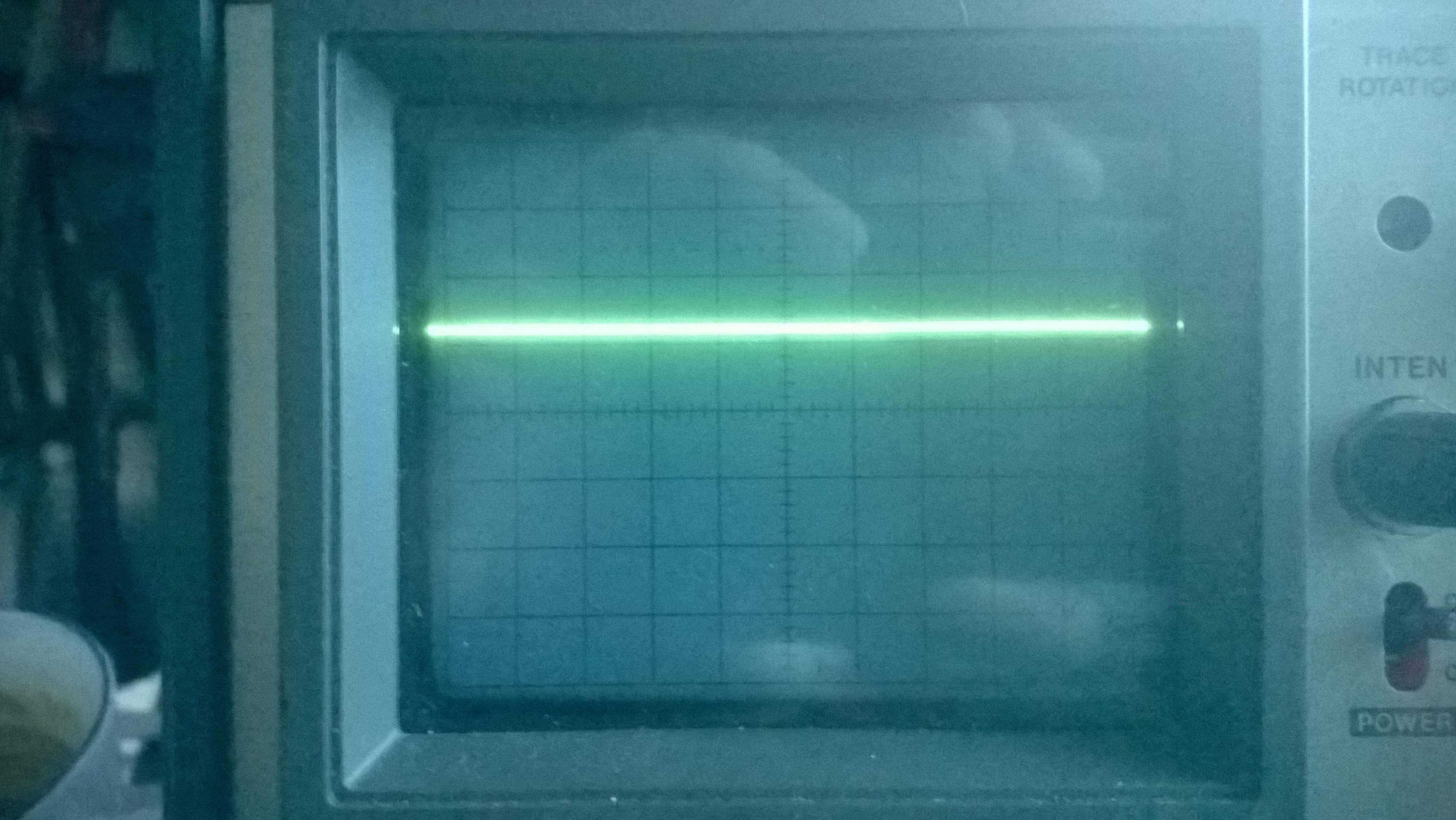

PostPosted: Sun Jun 29, 2014 6:45 am    Post subject: Reply with quote  Mark this post and the followings unread
I have some scope images, still new to using the scope!
I have set the horizontal to centre line by using scopes ground setting then I switched to scopes DC setting. The volts/Div was set at 0.5. The probe was set at 1x10. My bench power supply is set at 12v drawing 0.004 amps when I press start on sequencer, the clock rate was set to 10. I then took the images.

PostPosted: Sun Jun 29, 2014 8:31 am    Post subject: Reply with quote  Mark this post and the followings unread
The probe will have a 1x or a 10x setting. I'm not sure which you used, but I'm guessing 10x? 1x10 doesn't really clarify that Smile
If you're using 10x then your volts/div are multiplied by 10, so .5V x 10 = 5V, and those spikes coming out of U3B are strange in that they don't appear to be going -12V to +12V per Ray's description, more like -5 to 2.5. It's also strange that the integrator is only going 0 to +5V.
if I didn't know any better I'd say this looks like you are using a 5V supply not a 12V supply. Are you sure you have 12V / -12V at the power pins of U3?

PostPosted: Sun Jun 29, 2014 10:13 am    Post subject: Reply with quote  Mark this post and the followings unread
Scope is 10x setting.
Measured, using scope, pin 4 0f U3 showing -5.5v and pin 8 +6.5v.
However using meter I got -12v on pin 4 and +12v on pin 8.
Used meter to check output of bench supply and confirmed +/-12v.
used meter on power supply inputs on pcb and confirmed same result.
Used meter on all power pins for all ic's again got correct readings for all.
Using scope for the above I get -5.5v/+6.5v readings??? Confused I was expecting the same results as the meter.

PostPosted: Sun Jun 29, 2014 10:33 am    Post subject: Reply with quote  Mark this post and the followings unread
Sounds to me like there is some problem with the scope set up. Smile
Unfortunately I'm far from an expert there, so I have no good advice.

Just checked scope manual I had the volt/div fine tune red, inner dial, set wrong, so it is now all the way clockwise. Now getting correct scope readings, so readings in previous scope image set should be doubled. I am going to recheck all of them.
