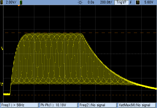

Heya! Sorry to come so late to the party here.
I actually had my old Lunetta modular in pieces in a box in the basement, and I found/pulled out the VCA circuit just now to see how it works with non-square waves. It's freaky!
Input is a (slightly overdriven) sine wave at 73ish Hz.
I've attached scope shots at two resolutions: one is the overall envelope and the other is a zoom into the top of the wave.
The waveform is actually pretty clean during the sustain portion, but you can see the strange way it's clipped during the attack and release. Pretty neat.
I also recorded this just for fun. I'm not 100% sure that I'm not distorting it further in my laptop, but you get the idea. It's got this woooomp kind of noise at the beginning for slow attacks. (I play around with attack and release a bit.)
Anyway, that's the deal with the active version of the circuit and non-square waves. Works great, but idiosyncratically.
edit: Oh yeah. I built the circuit without the output capacitor because I was using it for control voltages as well as audio, which make the super-long envelopes that it can produce even more reasonable. If you etch/build my version of the board, look out for that and add one if you're only doing audio processing.
Who knows which version I posted?

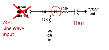

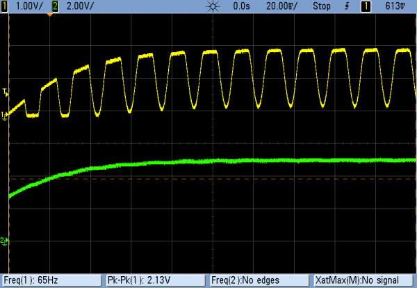

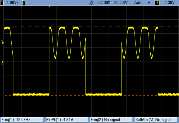

And then to answer a curiosity of mine about the two-diode VCA circuit.
I built it exactly as indicated (with a 10uF cap on the output) and then pulled out the last / output diode.
Somewhere in between, I switched to 5V supply, so the input is a 5V sine wave at ~75Hz.
I did two experiements. First, I used a 5V square wave as the control voltage, and ran it with and without the output diode so you could see the effect at a constant level.
The only thing different is that the full swing of the control voltage (that shows up as negative through the cap) is supressed by the output diode. But I'd say that both work "fine" with analog signals, though the sinewave is visibly flattened at the top. (My guess, by the diode drop of the "input" diode.)
I guess you want the output diode in there, though, because there'll be a thump at the turn-on with a square wave control voltage, and it's going to be louder in the single diode version.
Then I tossed a 47uF cap on the control voltage to smooth it out, and hooked up the scope (in green) to the CV input. Not entirely surprisingly, the performance is a lot like the op-amp buffered version of the same thing in my last post.
So there you go. The buffers in the op-amp probably help a bunch to make the attack/release part perform more consistently, but otherwise don't seem to do much. OTOH, it's nice to have those long swooping envelopes.
The sine wave came through a bit less distorted in the op-amp version because it's being amplified before the diode, but it's really not that big of a deal.
