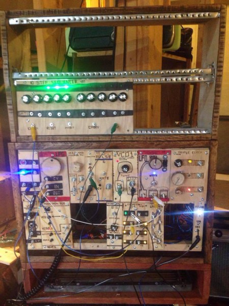

I was really pissed off last saturday so i built this (a krach orkester… ähm noise ensemble). Guerrilla style.

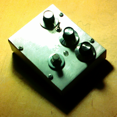

Wow, so much great stuff here. I'm so glad I stumbled upon electro-music in my quest to build stuff that makes noises!
I'm a total newbie to all this, but thanks to these forums and other internet sources I've managed to build a sort of modular. The stuff you all share has been invaluable for helping me make sense of those crazy schematics and stuff.
Some of the modules are totally passive (like the vactrol low pass gate), all are very simple (basic 40106, 555, and op amp-based oscillators). Next step is to build a dual supply so I can finally build a resonant low pass filter (in my mind, that's what I'm missing). Case and panels built with my very minimal woodworking skills and pallets; many components liberated from other items, thrift store toys, even parts of a TV I found in the woods. Patches made with alligator clips, screws, and nuts. Powered off a 5V wall wart. Most of the circuits come from various folks on these forums like synthmonger, Thomas Henry, et al.
Not pictured: I'm using a Raspberry Pi running wiringPi and Mido to listen for MIDI input and scale the 1-127 to 1-100 PWM on the GPIO pins (using a python script). Then I take that through a simple 1-pole low pass filter to get a fairly smooth voltage, which in turn modulates stuff, plays oscillators, etc.
Not the fanciest but it sure does make some noise!

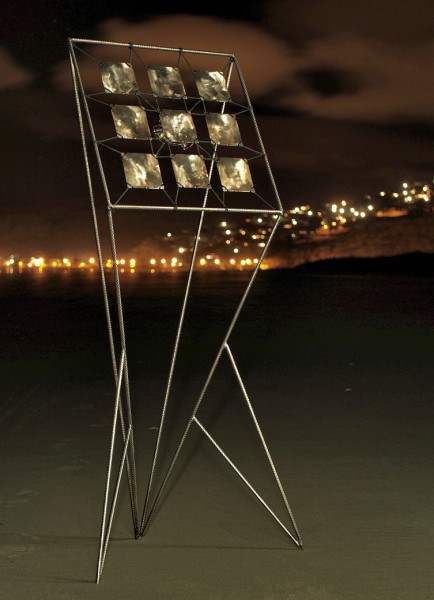

Touch sensitive sound generator with 9 contact plates.

Looks lovely and intriguing!
