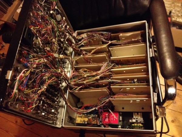

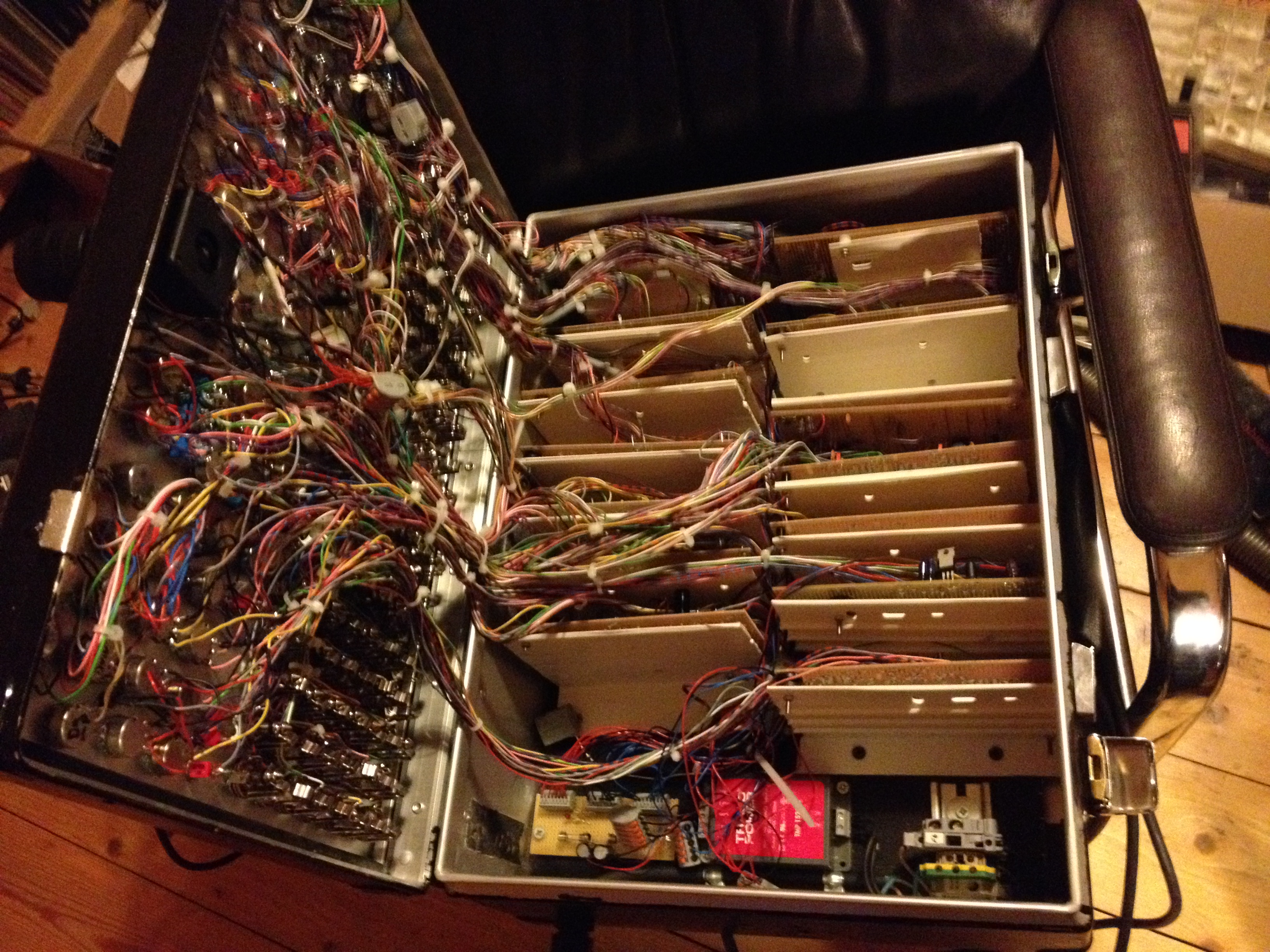

PostPosted: Sat Feb 21, 2015 1:41 pm    Post subject: Reply with quote  Mark this post and the followings unread
Yes Sir we can...
But believe me the back ins't as much interesting as the inside... Very Happy
Hearing my noodle it reminds me a bit on Heldon's Zind in some moments...
ah and by the way... is it normal that on the EMS VCF the volume goes down or lower when it self oscillates? mine does so but as far as i know and in all of my other filters it's the opposite effect and volume cranks up...????
correct or should i dive again into it and look for some Errors?

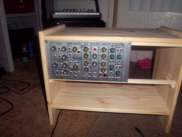

Started this in late 2013, finally got around to finishing it. I went for the simplest circuits I could find. The vcos, vcf, vcas, and adsr are all from Nicolas Woollaston here on e-m. The dual skewable lfo are mfos. Sample and hold is the YASH from Rene Schmitz. Ring Mod is from Aaron Cram. A/D is from Thomas Henry. Noise source is simple noise source, and sub-osc is a divide-by-n counter... Panel is 12"x6" aluminum from the local hardware store, graphics were simply printed on an overhead transparency and covered with clear contac paper. Ikea Rast rack.

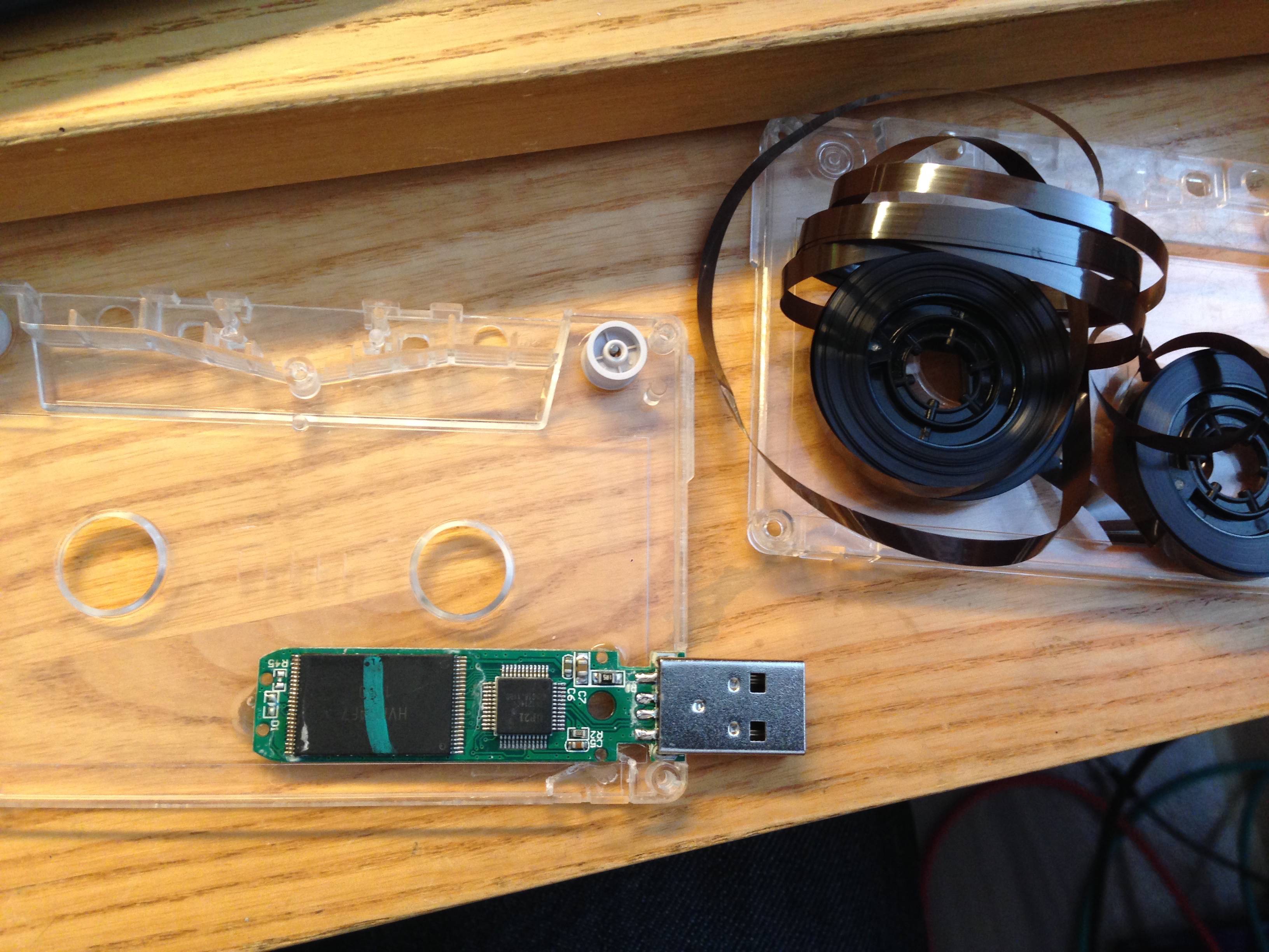

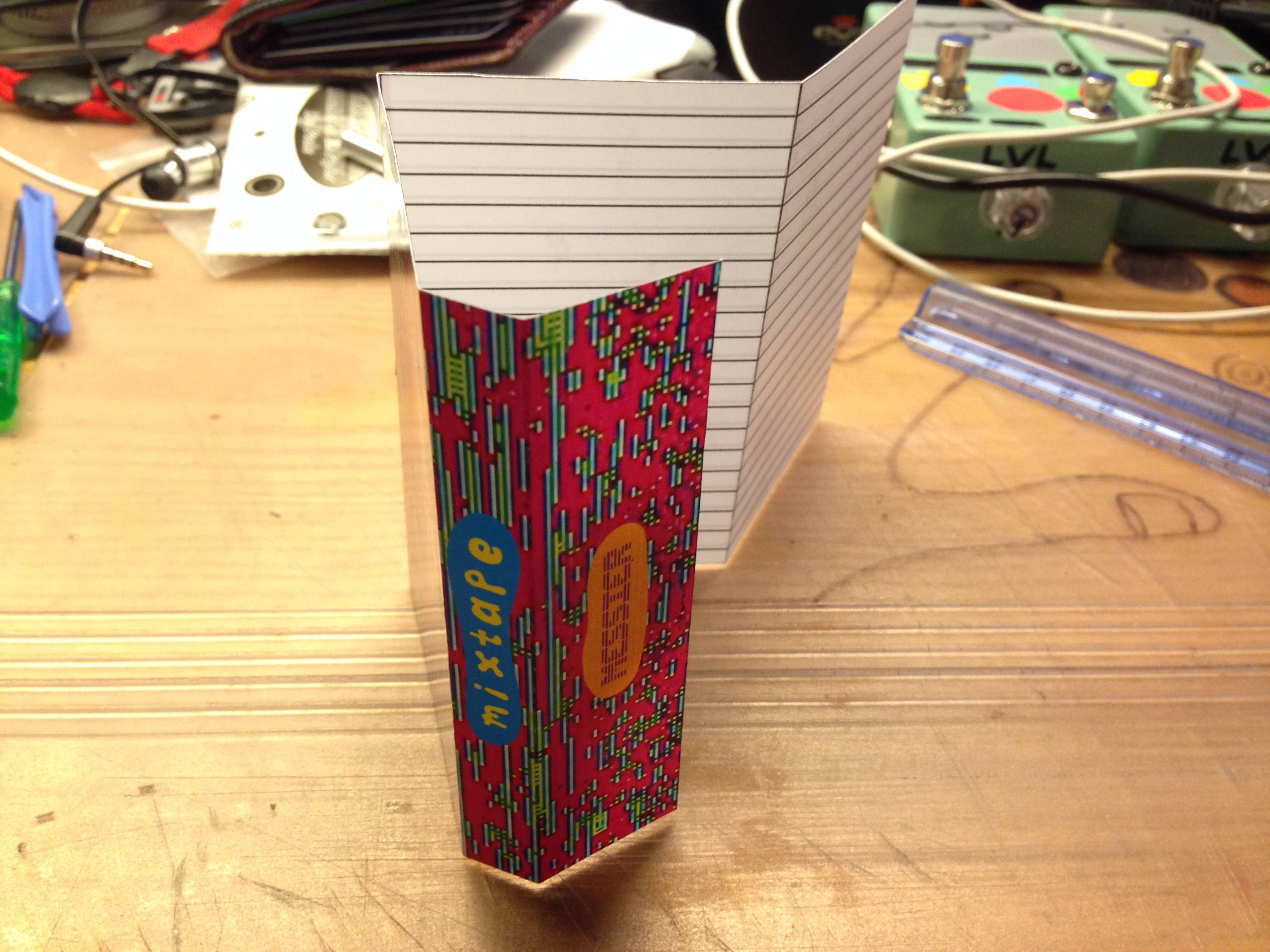

this is borderline for this forum, but thought you may like it.
built this real quick for a girl i know. love
(and yes the label is upside down Embarassed)
made out of a freebie 1GB usb drive i had laying around from a networking event or something like that. random clear tape. super glue. and photo paper + laminator (sanded down to remove glossiness).

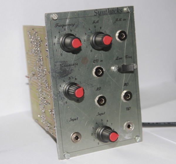

PostPosted: Tue Mar 24, 2015 11:11 pm    Post subject: Polivox VCF Reply with quote  Mark this post and the followings unread
Finished, with original parts. Sounds awesome!

I like that! Smile Is that Letraset for the labelling? And silverface MOTM panelling?

It's a aluminium corner with the transparent label. MOTM format.
