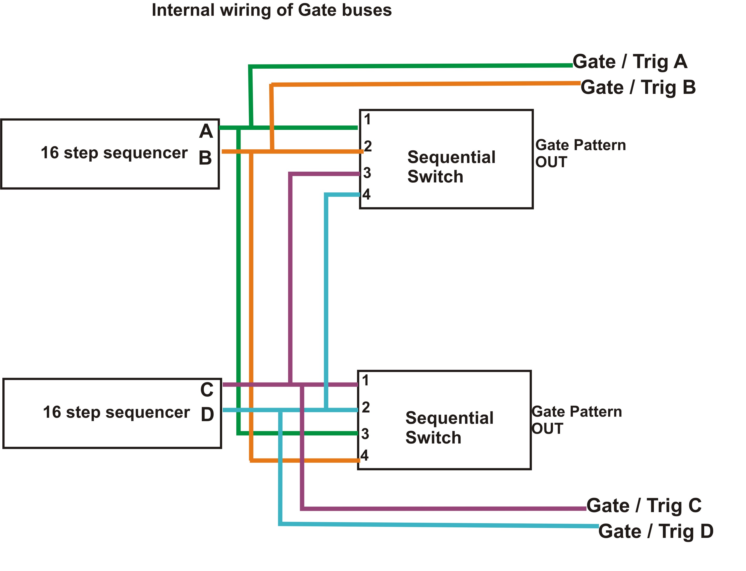

Since building the vari-sequencer , I have sorely missed having 2 identical mfos standard 16 step sequencers .
I have a standard 16 step I built in 2005 and it's soon time it was condensed Smile.
I have ordered another standard 16step set of pcbs from Ray a few days ago and I'm planning to build a dual sequencer on a spare 400mm by 250mm blank panel I have had set aside.
This thread will take a few weeks to get going, I'm at the planning / thinking stage at the moment Smile.
The new panel needs to contain......
2 x standard 16 step sequencers.
2 x simultaneous gate buses per sequencer.
2 x sequential switches.
2 x clock dividers.
2 x CV mixers (keyboard transpose).
lots of toggle switches & wiring Very Happy .
here is 2 planning diagrams of how the external clock & re-set"all" functions are connected & also the plan of how the Gate buses are connected inside.
And a first envisaged panel layout Smile Smile Smile Smile.

Wiring, wiring and some more wiring......
Got the 2 main sequencers purchased pcbs running , did the usual no chip power test and fully chipped test , apart from a dud LED they are working with no problems.
Next job , connect up the add on circuits , clock dividers / sequential switches / cv transpose mixers and 2 extra gate / trigger buffer circuits for outputs "B" and "D".
If there are no build faults on the veroboard circuits.... I should have this operational by the end of the weekend , hopefully Smile .

Skrog Productions wrote:
If there are no build faults on the veroboard circuits.... .
Famous last words .... Smile
just finished fixing a list of de-bug errors......
Chip wrong way round (not done that for a long time).
No power to 40106 (blindly drilled an isolator hole on the feed strip).
Decided the up / down tie diodes on the clone of the gate bus inverters were not needed ( they were needed).
Never mind Smile Smile hehe , all the wiring is done now and all the apparent faults have been tracked down & fixed.
