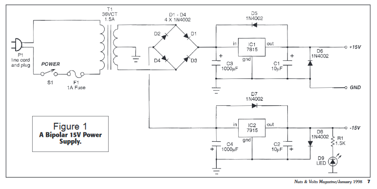

What do you think about Thomas Henry PSU ? i'm seriously thinking to build it!
 Filesize:  57.07 KB
 Viewed:  542 Time(s)

PostPosted: Sun Jan 01, 2017 12:25 pm    Post subject: Reply with quote  Mark this post and the followings unread
The only basic knowledge i have is from what is left from my school days some 25 years ago and those things i learned from debugging and fixing my own builds... so not the most reliable source i would say... but i do hopefully hint often enough that may answers shouldn't be mistaken as those by someone knows what's going on inside the circuits... because i mostly can't figure this out... there are plenty others here which are a hell better in that and they have definitely more knowledge of what is going on inside... Wink
Well that PSU from Thomas should be great for DIYlers and the synth builders but i would have some slight scruples to recommend such PSU's involving 230V mains power for beginners or unexperienced persons...
It's still dangerous and can be lethal... So i would maybe recommend to start off with a wallwart PSU...
And when it must be a 230V powered PSU then better stick to an DIY PCB Kit that is tested and proven to be safe instead of trying to design a PCB Board yourself...

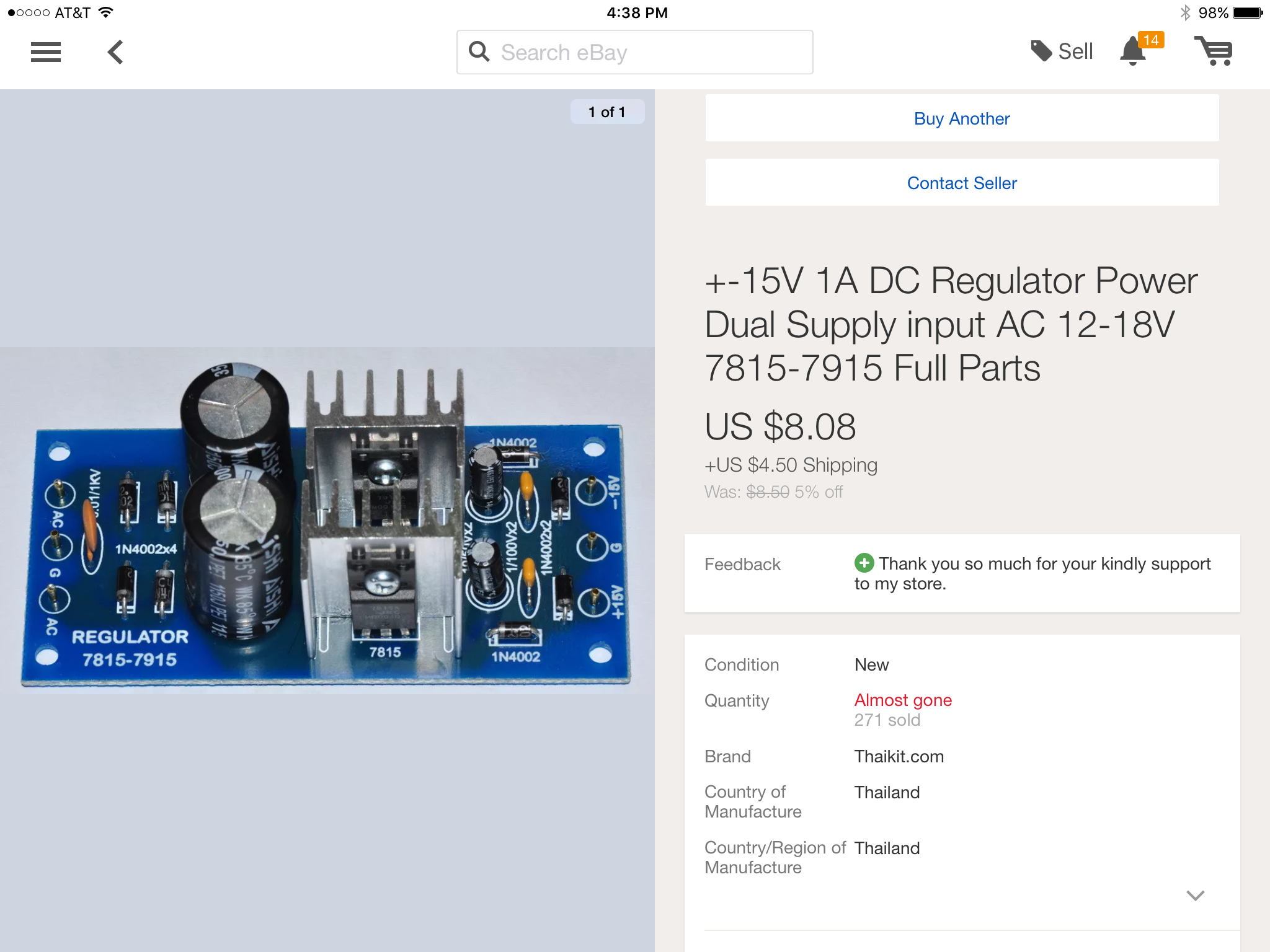

I have built that exact power supply. It works fine.
I did add 2 more sets of 10uf caps on the output.
I can tell you the ones I buy on eBay for 12 dollars use the same schematic. It's a pretty standard schematic, and you can't build one for 12 dollars US.
I couldn't get a link to paste so I took a screenshot. That is the 1 amp. They were out of 1.5 amp ones last time I bought one
LOL glad I looked. Almost sent a screenshot with all my information including credit card numbers on it.
 Filesize:  1.2 MB
 Viewed:  481 Time(s)

it looks awesomely good to purchase pre made PSU's from e bay. Sure convenience is there,but i'd love to learn the old way,that of the analog days when every and each one built their own custom PSU.
Or have it built by someone else lol Laughing Laughing
anyway, i'll give it a go, because it's handy to have a second PSU for sure
