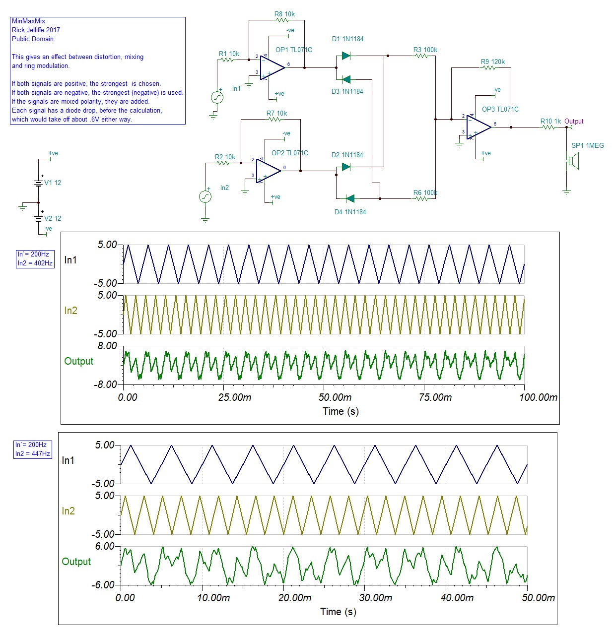

This circuit uses a simple arrangement of diodes, kinda like a diode ring but not, to make something that is kinda like a ring modulator but not.
It "mixes" two input signals. If both are positive, it gives the max of them. If both are negative it gives the min of them. If they are mixed, it sums them. Each input has a diode drip, which provides extra distortion.
Here is the schematic, simulated, and two audio examples, also from the simulation. The first has two triangle waves close: it gives a grungy chorus. The second has them separated by a non-harminic distance, and you can hear more of the inharmonic effects, but frequencies related to the inputs dominate over any sum/difference frequencies.
(The circuit can also be run from +/-15V with no change.)
ERRATUM: The circuit has 1N1148 but what is meant is the common 1N4148. Apologies. Actually, I think any small signal diodes will work.

Was looking at the parts needed for this circuit "minmaxmix" over the weekend but not sure about the 1N1184 diodes:
Mouser has things that look a bit like a car key in an ignition or something and are quite expensive.
Am I missing something?
Ricko
Joined: Dec 25, 2007
Posts: 251
Audio files: 27
PostPosted: Wed Jul 03, 2019 8:02 am    Post subject: Reply with quote  Mark this post and the followings unread
Oh, that is a typo (it comes up by default in the Tina-TI simulator and I don't catch it. Thanks for catching it. (The Velocitizer schematic had the same problem.)
No, it will work with any diodes. 1N4148 was what was meant. Apologies.

nice use of a full-wave bridge rectifier Laughing
I like the simplicity of the circuit makes me wonder how well a passive version would work, I guess I should just try it.
There will be some loss of course but it could be build very small. It also reminds me of a disrete XOR (which is a bit like
a ringmod) with a bridge rectifier that does use a transistor but doesn't need any external power.
Posts: 5810
PostPosted: Sun Jul 07, 2019 7:32 am    Post subject: Reply with quote  Mark this post and the followings unread
I did a quick test with a passive version. 2 signals connected to the AC inputs of a bridge rectifier and the DC ouputs of that connected to
the outside lugs of a 4K7 pot, the wiper of the pot is the output. The effect is most prominent when the pot is not in the center position,
so that might be a useful addition to the MinMaxMix circuit.

Iḿ not sure if the diodes would behave any different but there can be some loss with a passive resistor mixer.
For example if one signal is +5V and the other -3V then with an active mixer (with a gain of 1) the output would be +2V,
or actually -2V because it inverts (that's a good reason to keep the inverting input buffers).
With a passive mixer the output voltage would only be +1V (if equal value resistors are used). With an active version the
inputs are also isolated from eachother preventing any crosstalk in case the signals you are using for the inputs are
also used for something else with the help of a passive multiple/splitter.

An additional problem with passive resistor mixers comes from the driving impedance together with the value of the mixer resistors. Let's assume equal size resistors. When the resistors are very high value, the driving impedance is mostly negligible because the mixer resistors add to the driver impedance, but as the value of the resistors is reduced, the driving impedance becomes more and more significant. Imagine what happens if we start with 100K and then try 10K and then 1K and then 100R etc. As we decrease the resistors, we perceive a higher loudness from the mixer (because the lower resistors pass more signal current), but you can see that what we're doing by lowering the value of the mixing resistors, we are coming close to connecting two driving outputs directly together. Intermodulation distortion increases as the resistive connection between the two driving devices begins to work like a multiplier. The lower the resistors' values, the more distortion there is.
An active mixer won't give such distortion which is one of several reasons why active is used for high fidelity mixers instead of passive resistor mixing.

So in the case for MinMaxMix, where it is only diodes and a resistor mix we have three cases:
* If both inputs are below the level of a diode drop, the diodes block, and therefore it is like an open circuit: very high impedance as if unplugged.
* When both input signals are in the same quadrant, the higher level one "wins": the other is not forward biased so does not conduct. Therefore there is no tricky impact on impedance: just whatever resistors are place.
* When the signals are in opposite quadrants, both a positive-going and a negative-going diode conducts, and if they were connected together without a resistor this will be like connecting two outputs together (except that the outputs of the producers will have 1k or so resistors on the outputs usually). Therefore you always want the resistors for the positive and negative diodes' outputs before they are summed. And in this case, there is an effect on the impedance seen by each originating producer of these summing diodes.
Is that the takeaway?
Posts: 5810
PostPosted: Tue Jul 09, 2019 12:32 pm    Post subject: Reply with quote  Mark this post and the followings unread
Yep, I think that is all correct.
There is something else I am wondering about though. With the active version the diodes are referenced to virtual GND (pin 2 of the opamp).
With the passive version they are referenced to eachother if not connected to anything, or probably a resistive path to GND of whatever you
connect it to. So I think that for the passive version it would be best to add 2 resistors to GND after the diodes before mixing. I was initially
thinking just one resistor after the passive mixing but that creates another voltage divider and might still act a bit wonky.

Yes, I think the passive version is safer with some resistor to ground (I mentioned a 1M resistor above for this) and two would be better (resistors are cheap) but I don't know that it would make much difference if there were two or one?
If your post-diode mixing resistors are 10k and the ground resistor is 1M, that just reduces a 5V signal to 4.95V: I think it is more important to have a diodeswith a really low forward voltage/diode drop (i.e. aBAT85 or germanium) rather than 1N4148s, which could give you .4V in that scenario.

Ricko wrote:
I think it is more important to have a diodes with a really low forward voltage/diode drop (i.e. aBAT85 or germanium) rather than 1N4148s, which could give you .4V in that scenario.
yes, using schottky diodes would be a good idea. I do seem to recall that the voltage drop also depends somewhat on the current. Not sure if
a higher current had a lower voltage drop or the other way around. For the active version you could actually put the diodes in the feedback
path of the opamps to counteract the voltage drop. I also used that method for the WaveWiper.
here's a schematic of the passive version for reference (if you can find it in all the white space).

I don't mind the idea of the pot, actually.
I think a DC-blocking cap after it too, if used for waveshaping rather than CV mixing. That would open the door for cheap modulation by adding a CV to an input signal for different offsets.
