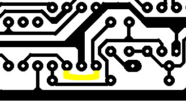

For those about to build:
There is a wire jumper that is not mentioned in the building instructions (at least I couldn't find it) and I didn't understand what it means when I looked at the picture. There are no holes for this.
Without this, nothing happens at all!
Perhaps you could insert a track here in the pcb (after checking wheter I'm right, please)

| Yea, looks like a mistake on my part. Thanks for the heads up. I went back and edited the post to include this track. |
haebbmaster
Joined: Aug 27, 2016 Posts: 40 Location: Windenreute, Germany
Posted: Sun Nov 05, 2017 10:20 am Post subject:
No, it's a problem of the original PCB. Thanks for correcting. _________________ Make modular synthesizers great again!

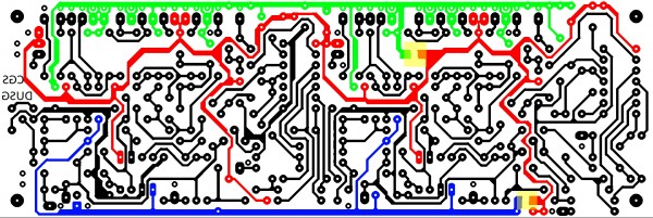

So, for the DUSG:
You have to make two cuts on your PCB. The original of Ken Stone is a bit confusing here. Looks like he made these cuts afterwards too.
You can check for shorts with the fill function of your paint program.
