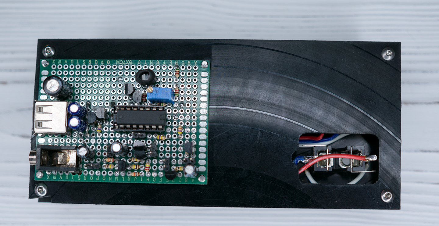

PostPosted: Fri Aug 24, 2018 3:34 am    Post subject: Reply with quote  Mark this post and the followings unread
I've recode ATTiny85 USB -> CV/G converter to make glissando. Is it not necessary to have ADSR envelope driven LPF for saw bass?

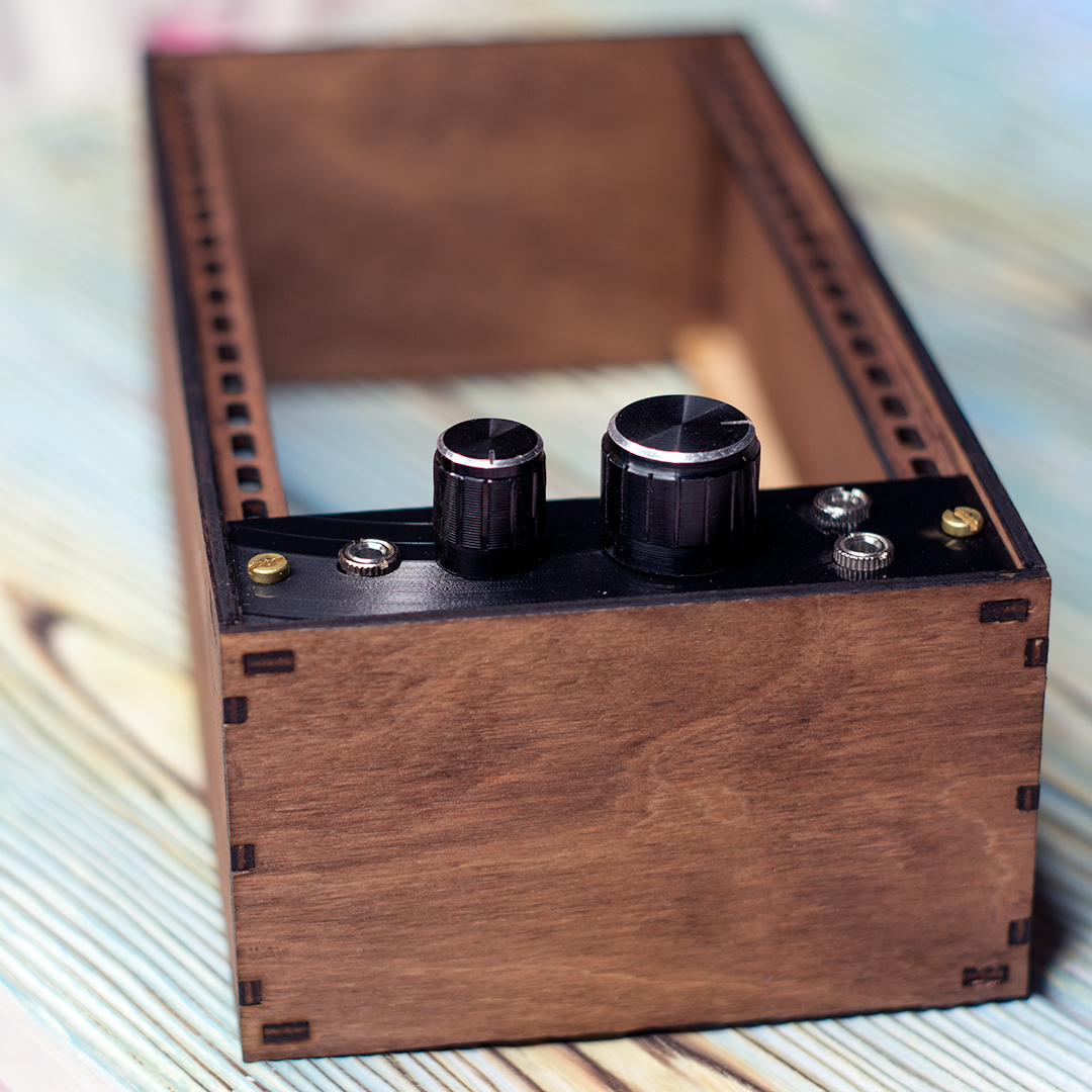

First attempt to make eurorack case:
 Filesize:  686.63 KB
 Viewed:  554 Time(s)

Eurorack case still is too expensive for me. So, I decided to make 'tiny' rack for testing new circuits for BassMaster. Height of modules is 100mm, width 10X mm.
 Filesize:  638.5 KB
 Viewed:  398 Time(s)
 Filesize:  722 KB
 Viewed:  441 Time(s)

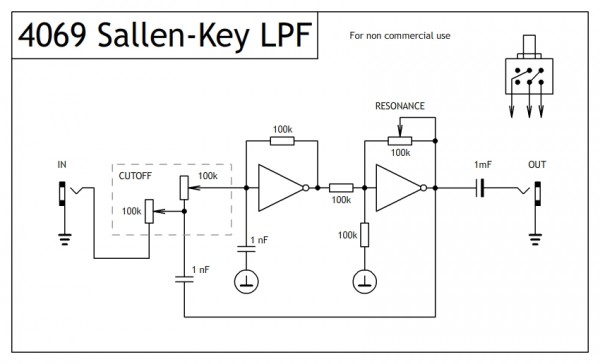

BassMaster 85 with glide feature + Sallen Key LPF in tiny rack:

I have tested several filters, even tried diode half ladder one. But I don't have enough knowledge to set them up well. Trials and errors...
Later I will return to the development of the diode filter (it sounds like boiling mercury, but I have still no success with resonance), and so far earned only Buchla-syle LPG.
But it works great!

I've tried this schematic: http://www.experimentalistsanonymous.com/diy/Schematics/Filters%20Wahs%20and%20VCFs/4007%20Based%20VCF.pdf
CV range occurred to be quite unuseful(

I understand that, and it's great! And I always check such schematics. And I often sketch what I have checked. That's why I've been doing my synth for so long Laughing
I tried the second circuit with a stereo pot. instead of transistors, but I really did not like the sound of resonance. I have little experience, perhaps the input signal was high amplitude...

JovianPyx, I've tested the 4069 state variable filter with k3446 MOSFETs. Filter closed at ~3V on MOSFETs gates, and opened on ~3.5V
I think it is possible to use level shifting op amp to get CV range closer to 0-5V.
