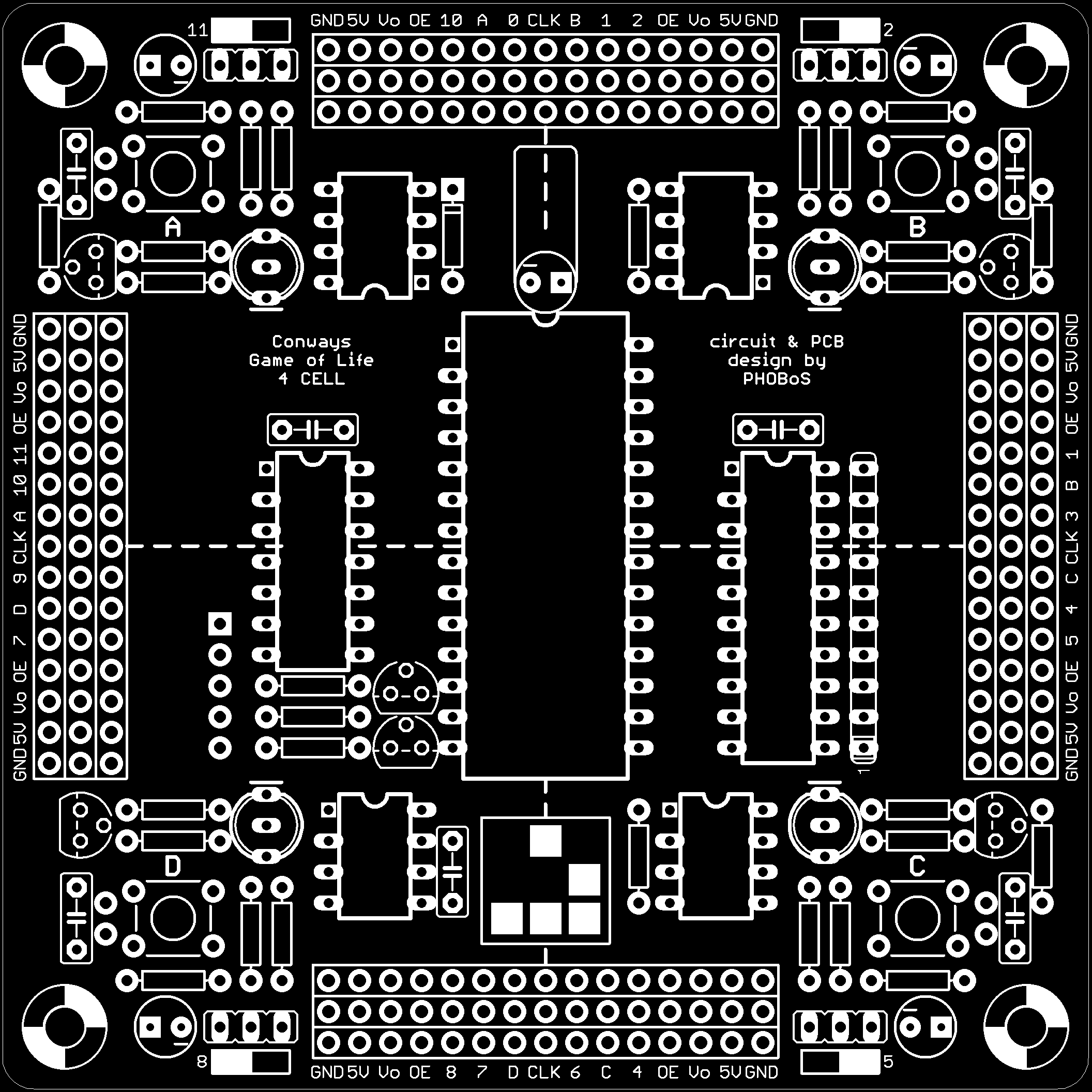

[0.2.2] [0.2.3] [1.1.1] [1.1.3] [2.0.0] [2.3.3] [3.2.0] [3.2.2] [5.1.0] [5.1.1]
Posts: 5913
PostPosted: Wed Feb 03, 2021 12:00 pm    Post subject: Reply with quote  Mark this post and the followings unread
I've been thinking to make something to set the cells of the cube in an easier way, likely with an arduino to keep it versatile and I have an idea
for something that I could then use as a fun controller. It's a bit silly of course as I could simply run the whole thing with an arduino that way.
but here's the thing; since I couldn't get ordinary 74HCxx flip flops to work I used the 555's which was also much more convenient for the PCB layout.
The 555's don't use a switch that has one side connected to GND or V+ so it can not simply be controlled with a logic 0 or 1. I'd have to bridge the
switch itself (I did add connectors for that) either with something like a 4066 or if I am lucky just a transistor will work. Of course I need to be able to
address all 96 cells individually so it will require 96 of them and because I don't have 96 outputs on an arduino i'd also need 12 8-step shiftregisters to
control those switches. I might design some PCB's for that too to keep it compact so it can easily fit inside the cube and save some time on soldering.

The red is indeed different from what I have but for the rest I think it looks the same, so I guess that also confirms that my cube works correct.
And yeah red is just an extra bonus since I had 4 pins free per EPROM but to simplify it; red is on when a cell is alive and has exactly 2 neighbours
(creating yellow) or when it has more than 3 neighbours. Of course you can easily try different rules, or more colors (e.g. depending on the age of
a cell, or the exact amount of live neighbours)
anyway, looks awesome! Razz now go get breakfast

PostPosted: Sat Feb 06, 2021 7:46 am    Post subject: Reply with quote  Mark this post and the followings unread
here's a better background image, don't know if that would improve things though.
also, small detail, I rotated the faces in such a way that they are all perpendicular to eachother (if that makes sense).
You can probably see what I mean if you look at this photo:
 Filesize:  42.81 KB
 Viewed:  192 Time(s)

Posts: 24598
Audio files: 309
PostPosted: Sun Feb 14, 2021 5:28 pm    Post subject: Reply with quote  Mark this post and the followings unread
Cool
Besides learning some 3D stuff for myself, my hope was for it to be useful for you.
So, anyway, if you have ideas for improvement for what you want to use it for, I'll try to change things for that.
