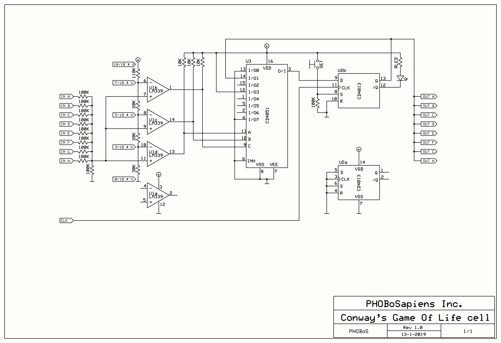

* this is probably going to be one of those long posts that hardly anyone understands or cares to read, but I'll give it a try Laughing *
One reason I started this thread is of course because I'd like to make a hardware version of Conway's Game of Life. It's been brewing in the
back of my mind for a while and I couldn't resist any longer. The most efficient way of doing it is with a microprocessor and I'll probably do that
but I was curious what it would take to make it without one. The idea is to make single cells with 8 inputs and 1 output that can be linked together.
Initially I thought of using logic chips, it is afterall just 0's and 1's. Synchronization is easy to do with a latch before the output so all cells can be
clocked from a single source, although it could also be interesting to make an asynchronous version so each cell has a build in oscillator with a
different frequency. However, decoding the 8 inputs is not that easy or at least takes quite some logic gates to accomplish. I did figure out a way
to do it with some adders and also found some similar circuits here. Another way would be to use some logic gates to link a couple of muxes together
which gives the option of changing the rule set. You need a lot more than 1 cell to actually make it useful though so the circuit should be very small
and that's just not going to work with pure digital logic.
There is another way that I had been thinking about which is analog. The hardest part to do digital is to determine how many inputs are high
for which you need a majority gate. Analog this is quite easy to make with a resistor network and a comparator or in this case 3 of them.
So that's what I did and I came up with a working circuit Cool
Version 1 was the first working idea and version 2 is a further developed even smaller one but the input section is the same on both. The 8 inputs
(from neighboring cells) are each connected to a resistor network that forms a voltage divider with a 9th resistor to GND. I initially added this resistor
because I was thinking of using diodes on the inputs but it turned out to be very useful when calculating the appropriate resistor values. For every
input that is high the output voltage of this network rises by 1/9 * V. With all the inputs low the output is 0/9 * V, with 1 input high it is 1/9 * V,
with 2 inputs high it is 2/9 * V, etc all the way up to 8/9 * V. (The circuit is designed for signal voltages that are the same as the supply voltage 'V'
but since it is all about ratios the actual value of this voltage doesn't really matter)
I slightly rewrote the rules (but they function the same) which translates into 4 useful voltages:
< 2/9 * V: Any cell with fewer than two live neighbors dies.
= 2/9 * V: Any cell with two live neighbors doesn't change state (lives on, or stays dead)
= 3/9 * V: Any cell with three live neighbors lives (lives on, or becomes a live cell)
> 3/9 * V: Any cell with more than three live neighbors dies.
3 comparators are needed to turn these 4 voltages into useful (digital) signals.
These are configured in such a way that the treshold levels lie exactly between 2 of the voltages for reliable triggering.
the first comparator (U1d) triggers when the voltage is between 1/9 and 2/9, which is 3/18 * V
the second comparator (U1c) triggers when the voltage is between 2/9 and 3/9 which is 5/18 * V
the third comparator (U1b) triggers when the voltage is between 3/9 and 4/9 which is 7/18 * V
just for "fun" let's use a voltage of 5V
0 inputs high 0/9 * 5 = 0V
1 input high: 1/9 * 5 = 0.56V
- first comparator triggers at 3/18 * 5 = 0.83V
2 inputs high: 2/9 * 5 = 1:11V
- second comparator triggers at 5/18 * 5 = 1.39V
3 inputs high: 3/9 * 5 = 1.66V
- third comparator triggers at 7/18 * 5 = 1.94V
4 inputs high: 4/9 * 5 = 2.22V
5 inputs high: 5/9 * 5 = 2.78V
To create the correct voltages for the treshold levels the resistors need to have a ratio of 3/18, 2/18, 2/18, 11/18,
which is very convenient because the E24 series contains resistors of 30K, 20K and 110K (33K, 22K, 120K should also work fine)
This results in the following bits (for version 1):
- less than 2 live neighbors: 000
- exactly 2 live neighbors: 001
- exaclty 3 live neighbors: 011
- more than 3 live neighbors: 111
All that's left is to translate these signals to a 0 or 1 according to the rules and my first idea was to use a mux for this:
000 -> 0
001 -> depends on the current state so the output of the cell is fed back into this input of the mux.
011 -> 1
111 -> 0
The output of the mux is then fed into a latch so that a new state appears on every low to high clk transition. Because it is important
that the output stays as close to the supply voltage as possible I connected the LED to the /Q output so that it doesn't cause a voltage
drop on the Q output. (The LED goes on when /Q is 0). Using a transistor as a buffer would be a nicer solution but I tried to keep the
component count as low as possible.

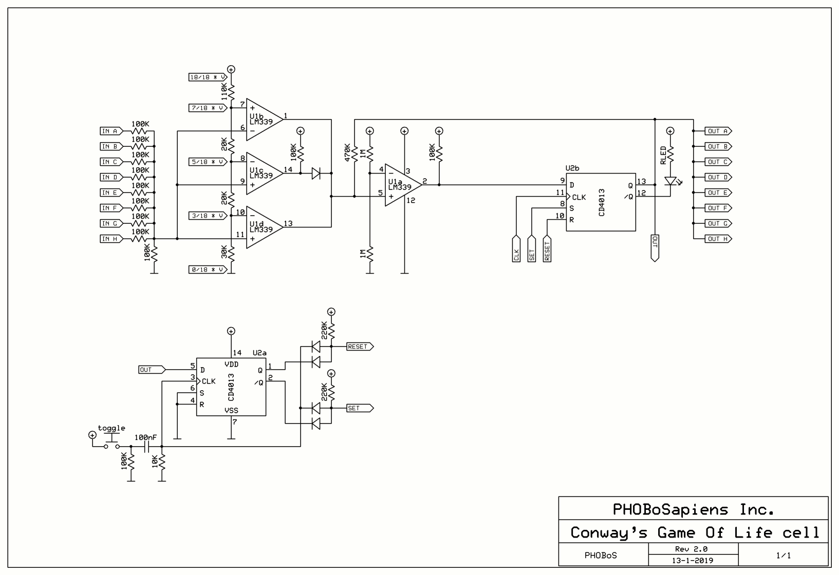

Although version 1 works I couldn't shake the feeling that there might be a way to do it without the mux, maybe by using the spare latch
and/or comparator.
I had to bend my mind a bit but today I figured it out Idea
Note that for version 2 the inputs of the 3rd comparator are swapped which results in:
- less than 2 live neighbors: 100
- exactly 2 live neighbors: 101
- exaclty 3 live neighbors: 111
- more than 3 live neighbors: 011
however, this isn't really true as the comparators have an open collector output, so it's actually:
- less than 2 live neighbors: X00
- exactly 2 live neighbors: X0X
- exaclty 3 live neighbors: XXX
- more than 3 live neighbors: 0XX
(X is a floating state)
A nice thing with open collector outputs is that you can connect them together without shorting the outputs. Comparators 1 and 3 are directly
connected together and with the pullup resistor and diode on the output of comparator 2 this results in the following states:
The output from the cell is also connected to this point through a resistor so when the output of comparators 1 or 3 is low it is pulled to GND
and when the output is floating (exactly 2 live neighbors) it is whatever the current output state is. When it is pulled high by the resistor on
the output of comparator 2 it forms a voltage divider with the resistor feeding back from the output which results in a level between 0 and 1
if the output is low. This is why the extra comparator (U1a) is used. The output of this comparator is connected to the latch as in version 1.
but wait there is more,..
Because there was still an unused latch I wondered if it could be used to make a switch that can toggle the cell between dead or alive with
a single button for programming the initial state. The idea being that you could make cells with illuminated push buttons. This got a little bit
more complicated than I hoped because the latch remains in the last state it was set and doesn't follow the output. So if the last state was 0
and the ouput of the cell is 0 nothing happens, neither would it work if both are 1. To solve this I added 2 AND gates made with diode logic.
