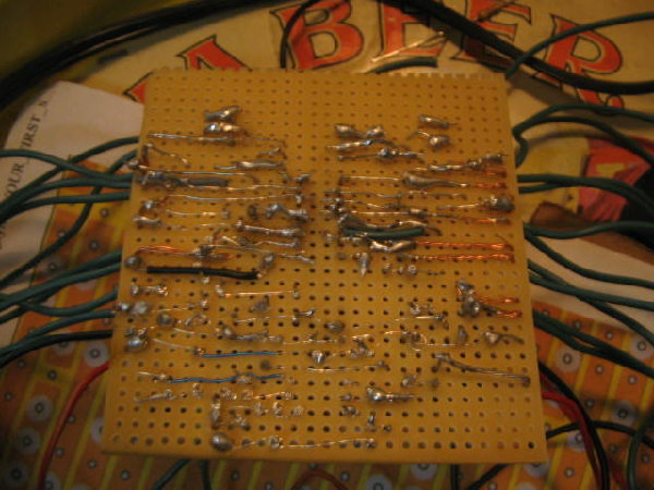

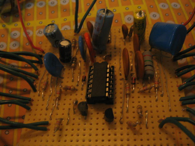

I'm running Maplin out of capacitors!
This is my work thus far. Are those wima capacitors ok? I will whip them out quick as lightening if they aren't!

Those WIMA caps are already out, I saw more appropriate caps on the net on Maplin's website. Those caps (the Wimas) are for stratocaster style guitars! You can see I extended the legs.
One question, is the red bell-wire ok for the jumpers?

Most bell wire I've seen is solid conductor which works fine electrically but can break after a few repeated bendings. If your wire is stranded, it will be fine.

I like the WIMAs, they're cool. Very Happy

Ok cool. I put the WIMAS back in temporarily, as I got the other components together, but the thing is astonishingly quiet.

There must be something amiss about the wiring, 'cos mine pumped out plenty of signal. Eventually.
Make sure you're using the right Hex Schmitt Trigger, it needs to be a (CD?)40106, a (CD?)4584 or a 74C14. Don't use a 74HC14! These aren't rated for 9V, and you will be listening to your chip being slow roasted! Laughing (the level will be low as well)

I'm using a CD40106, just as the doctor ordered. I will check the components when I get replacements for those WIMA 0.022 caps. Maybe once I get those suckers out (with their home-made legs!) it might be louder.
Could be a cold solder. I'll replace every matte finish solder in the thing if necessary!
Good news is the filter works, its just a little bit nasty to listen to!

Ok I got it working "perfectly". I need to post a youtube video.
Basically it was quiet, and all you could hear was a choir of naughty oscilators. So... I circuitbent it. I found a connection which totally boosted the output. This also cleared the multiple oscillator fiasco.
I also managed to install some kind of ringmodulator to it! How in the hell?!?!
Its a gem though. And seriously, if you make one and no sound comes out, then something really is up! I had a capacitor fall off the board today, and it works fine without!!!

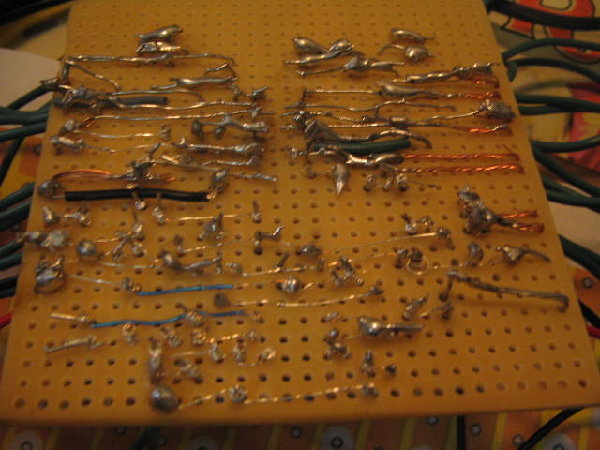

Funny you should say that... I got a volume pot in it now, because I actually sat down and worked out how to fit it! I usually just dive in with the iron.
I also fitted a battery kill-switch to actually turn the thing on and off.

Ok. The thing is nearly finished.
Some very VERY densely packed wires!

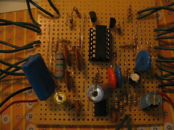

Built a few of Ray's modules and have got 'em working first go, but this WSG has got me stumped.
Its a little less then half working.
I'm using the Uncle Krunkus stripboard layout.
I cheated and resized it to fit as a sort of "poor man's pcb".
My first problem is that the Pitch knob isn't working on the WSG 1 side of the board but all the others are all fine and its making some sounds that are quite cool when gated through my microkorg arpeggiator and other modules.
The WSG 2 on the other hand doesn't do anything at all.
Now I've been over and over the board and can't find where I've gone wrong. The only thing I can think of is that I've put in the electrolytics in backward on that side.

With soldering? Probably not, it takes quite something to do that for the usual chips.

I remember Ray saying something about the cap which backs up the pseudo split supply, when someone had a similar problem. Make sure that cap is the right way around. By pseudo split supply, I mean the arrangement for the 741 which is the heart of the filter. I just had a look, and it's C7.
The symptoms you describe sound like what happens when an electrolytic is reverse biased. The dielectric breaks down and behaves "differently", and can sometimes be re-polarized, in which case it sounds better for a few seconds, but then ultimately fails and goes weird again etc. You're lucky it hasn't actually gone "pop" Laughing
Maybe the transistor is doing something to the output waveform the way it mixes in that long wavelength? I have to get a scope on it at some point, but I'm off on a work trip for the week.
If I can figure it out for my next stripbpard core (to mount in a handheld geiger counter, with all the controls and LDRs: mount the LEDs into goggles connected to the handheld unit via cable!) I'd like to use it.
I got this to work fine, BTW, clocking a CD4040 with the WSG output. It does seem to be a little finicky about range, but a few resistors in the right places would fix that. Here's messing around with this playing with vactrol filter possibilities:

I've built the WSG as my first project and it's all gone surprisingly well. However mine doesn't quite sound like some of the youtube vids posted here.
The issues is I get "static" sound when I rub my finger around the top strip. Isolated on the section of circuit from R4 > C2 > connectors linked to IC2 > C3 and the connectors of the actual Pot
Am I right in thinking that the Caps are 471k ceramics?? This seems to be the only bit of the circuit that has issues. All my wiring and holes are correct as far as I can tell.
Could it be an issue with the components? The noise only starts on the top leg of R4 not the bottom and ends before R16.

attached are pics of my realllly bad soldering but nothing is touching, no solder in between nodes on the perfboard, i scratched in between the close ones with a needle just in case, im thinking i have a component in wrong or am missing a connection somewhere, but it looks like the diagram (except c25 i had to use 2 .01s instead, but i put them as instructed, side by side, as well as the first three connections on the negative rail (by the battery) i accidently moved 1 slot down, but they are connected to the right spot on the bottom, and the top is connected to negative like it should be) everything else appears to be correct.. HELP i want this to work, im obcessed now =x maybe my diodes are backwards? they look right.. all the polarized caps are in right, possibly my lm471 is backwards? the writing on the chip faces left (from the stripboard layout view) for the 40106 and right for the 471 and i have seen them all the same way in the other. i hope the 471 isnt backwards. i didnt put that one in a socket lol ..
pre-emptive thank yous for your time and brain cycles =]
also im realizing the filter circuit is pretty small for this. im wondering if i can use the filter with an input , where would i route the incoming audio?

PostPosted: Thu May 29, 2008 2:12 pm    Post subject: c7 backwards Reply with quote  Mark this post and the followings unread
so going back through the old posts one more time i realized that C7 was reversed on my board. Usually they signify the positive on these electrolytic caps but this one had negative signified.. anyway, i reversed the cap and still have the same problems, no output unless i bridge from around the 40106 to the output capacitor. and its really quiet when i do that. im thinking my 741 is backwards =[[
