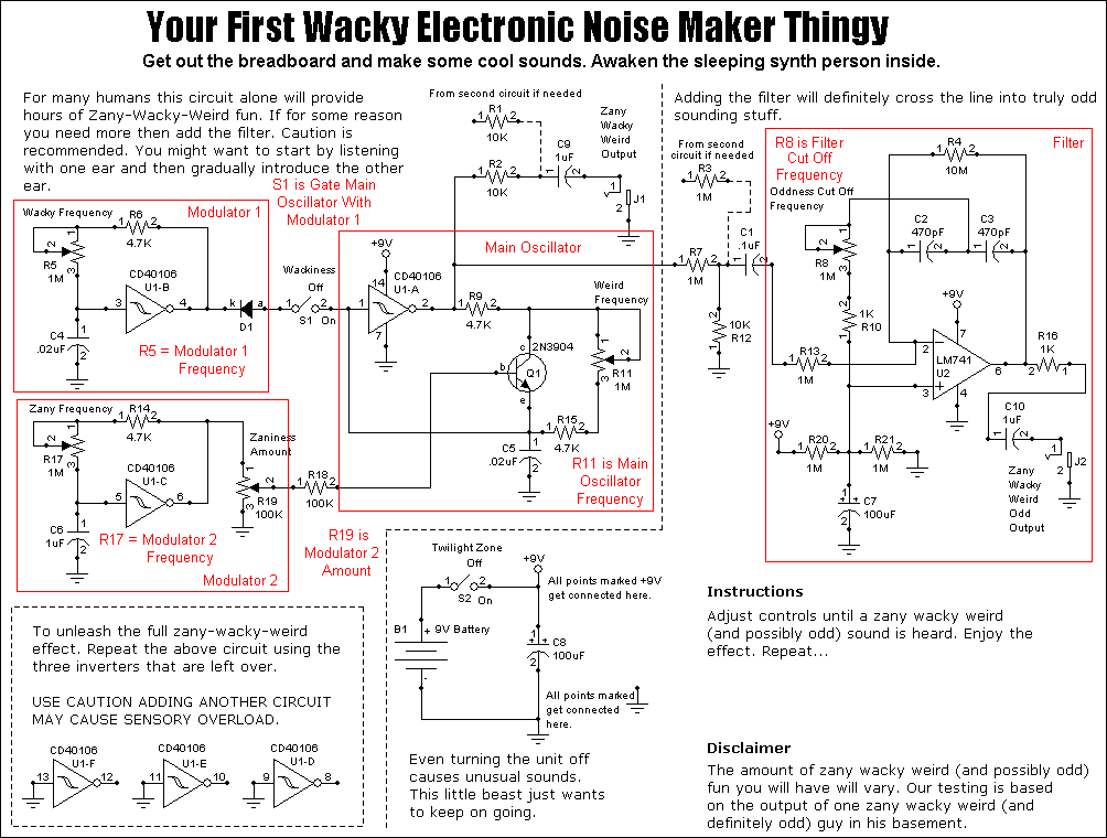

doomrock
Joined: Jun 11, 2006
PostPosted: Sun Jun 11, 2006 6:12 am    Post subject: Reply with quote  Mark this post and the followings unread
Hi, I'm new to this and have nearly completed soldering up the stripboard layout. (Thanks for that by the way). My problem now is that I'm not sure how to wire up the various pots, switches and power supply, or any idea what each one does. Could anybody knock up a quick diagram?
Thanks,
Jamie.
ladislaobiro
Joined: Mar 24, 2005
Posts: 105
Location: Italy
PostPosted: Mon Jun 12, 2006 12:09 am    Post subject: Reply with quote  Mark this post and the followings unread
Hi Jamie,
welcome to electro-music.com forum Surprised
I might have a diagram buried somewhere into my pc that will answer this part of your question...
I will try to find it out, and post it here...
bye,
ladislao
ladislaobiro
Posts: 105
Location: Italy
PostPosted: Mon Jun 12, 2006 8:37 am    Post subject: Reply with quote  Mark this post and the followings unread
here you go...
at least you will know what does what...
good luck... Surprised
ladislao

dnny
Joined: Mar 12, 2005
Posts: 519
Location: Helsinki, Finland
PostPosted: Sun Jun 25, 2006 1:42 pm    Post subject: Reply with quote  Mark this post and the followings unread
steve3186 wrote:
The list of parts for the strip board layout are different i was wondering why this is? Any info anyone??
Hi Steve and welcome.
the sripboard uses all the capacity of the 40106
so there is 2x zany 2x wacky 2x weird
and the PCB uses the half of the capacity (as shown in MFOS schematic)
1x zany 1x wacky 1x weird
both designs come whit the filter (oddness)
there is no volume knob or led on stirpboard, but if you want i can draw them for you
daniel
