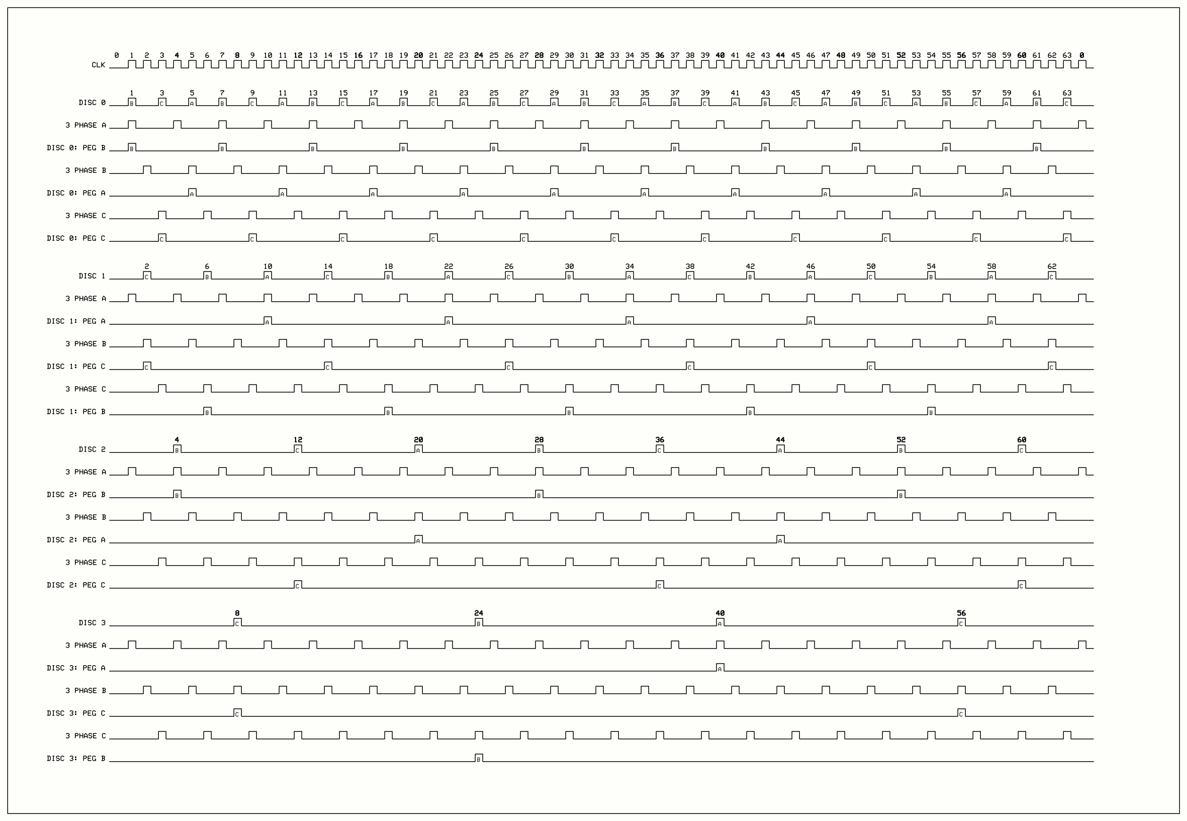

I designed and tested a simple circuit that creates a (0), 1, 2, 1, 3, 1, 2, 1, 4, 1, 2, 1, 3, 1, 2, 1 sequence, and it can easily be extended.
I don't really like the (0) in there but it shouldn't be very hard to change that to another 4 (or whatever the highest number is).
However that is only part of it, there is also the sequence of the pegs/rods which for 4 discs is B, C, C, B, A, B, B, C, C, A, A, C, B, C, C.
I have been staring at it and trying to group things together by looking at the actual movement but haven't been able to find much logic behind it.

a bit of an explanation for the circuit above which relies on the fact that for the CD4043 (which has 4 flip-flops) SET is dominant.
This means that if both SET and RESET are high at the same time the flip/flop will be SET.
As mentioned before:
To solve it you count in binary and the position of the bit that changes from 0 to 1 is the number of the disc (0 being the smallest) to move.
0001 move disc 0
0010 move disc 1
0011 move disc 0
0100 move disc 2
0101 move disc 0
0110 move disc 1
etc,
And that's what it does. Everytime one of the outputs of the CD4520 changes from 0 to 1 (and that is only ever 1 output at a time)
it sends a pulse to the corresponding flip-flop to SET it. At the same time all the other flip-flops are RESET by the CLK signal.
For reliability I used a smaller capacitor for the RESET inputs although I am not sure if that is even needed.
You could also use the same capacitor values and a smaller pulldown resistor.
Because only one of the outputs is high at a time you could connect them to a priority encoder (CD4532). (useful if you want to control a mux)

Ah ok, so not even Gray codes need .. that probaly just is then to assure only one output changes on each count ... aand .. yup .. ruler function Cool .. I stumbled over something to determine the peg to move to too the other day but forgot where that was ... skimmed trough tens of pages and papers .. it seemed simple then .. but didnt really pay attention.
The priority encoder would complete the ruler, yes.

This shows even better how it is a simple repeating (and recursive) pattern, which is the same for all pegs just shifted.
For every extra 'level' (2 discs more) the same pattern repeats but a factor 4 slower.

PostPosted: Thu Aug 08, 2019 11:12 am    Post subject: Reply with quote  Mark this post and the followings unread
Yes .. Embarassed .. didnt even think of that .. but a bit shift will do exactly the right thing (for n >= 0).
heh, shoudn't that be (for n>0) ? otherwise it will use out[0] which doesn't have a value assigned yet, unless it's 0 by default.
here's a more complete timing diagram for a game of 6 discs. (I am very tempted to do it in a spreadsheet with some colors colors )

And that's how I solved the Tower of Hanoi with the magic of 3's Very Happy
I drew another timing diagram, this time with a 3-step counter (and only 4 discs), which makes it clear why it works.
oh and I had 3 gates left (U5a, U6a, U7a) so I used those to switch the peg outputs between long or short mode. In short mode the outputs have the
same duty-cycle as the clock signal while in long mode they stay on for 1 full clock period. As a result if a peg output is high for 2 or more consecutive
steps it will create seperate short pulses in short mode, and one long pulse in long mode. I was thinking of using the enable inputs of the CD4043's
for this but they have 3-state ouputs so it depends a bit on what you connect it to if that would work. Also I connected the 3-step counter directly
to the clk signal instead of the first division. Works the same except the direction of all the discs get reversed. Hmm, I might aswell add another switch.
I will look into it a bit more to see if I can simplify it even further and have a another look at the other video.

party time!
Brilliant Idea
I had been looking at 3 too .. as in ternary numbers .. or do stuff modulo 3 ... but it didnt bring me anything - glad it did so for you Smile

PostPosted: Sat Aug 10, 2019 8:50 am    Post subject: Reply with quote  Mark this post and the followings unread
... except that also I did not find a solution for not having to recalculate earlier elements when a longer sequence gets requested .. all other sequences I have do have this property of extensibility .. would be cool to have that for the peg sequence too.
That should actually be pretty easy now, well at least for the standard solution with the shortest number of steps .
The numbering might be off to what you're doing but I am going from how it works in the simulated circuit.
At the start position (step 0) it has the following ouputs:
- disc outputs (0..7) = all 0
- peg outputs (A,B,C) = all 0
- binary counter (0..255) = 0
- 3-step counter (0,1,2) = 0
The output from the 3-step counter can easily be calculated with i % 3, where i is the current step.
for the even discs this output translates to:
0 = peg C
1 = peg B
2 = peg A
for the odd discs this output translates to:
0 = peg B
1 = peg A
2 = peg C
hmm, I only notice now that they are in the same order just shifted, interesting. Unless I made a mistake somewhere.
The order does seem to be different from what I have in the circuit (will look into it later).
edit: I had swapped some connections. uploaded a fixed version
For every step you know the disc (ruler sequence) and the output from the 3-step counter,
from that you can now easily determine the peg.
examples:
step = 17
- output from the 3-step counter = 17 % 3 = 2
- current disc = output from the ruler sequence for step 17 = 0
- 0 is an even disc and for even discs: 2 = peg A
- so at step 17 disc 0 is moved to peg A
step = 32
- output from the 3-step counter = 32 % 3 = 2
- current disc = output from the ruler sequence for step 32 = 5
- 5 is an odd disc and for odd discs: 2 = peg C
- so at step 32 disc 5 is moved to peg C
step = 42
- output from the 3-step counter = 42 % 3 = 0
- current disc = output from the ruler sequence for step 42 = 1
- 1 is an odd disc and for odd discs: 0 = peg B
- so at step 42 disc 1 is moved to peg B

That is quite elegant Cool
