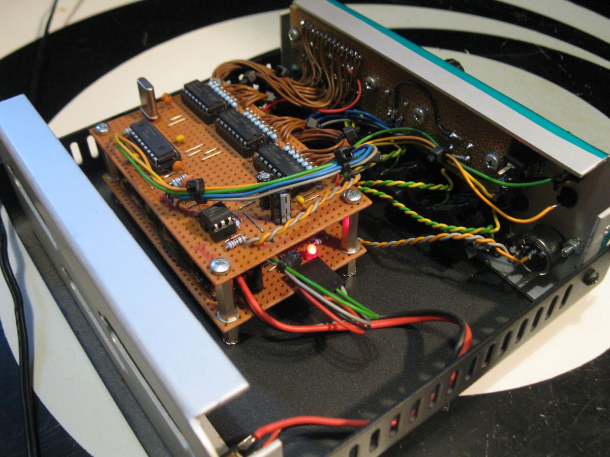

A while ago I build a master CLK oscillator that can be set to a certain tempo. It has 5 trigger outputs: /4, /2, x1, x2, x4
and a sync/reset button. The manual BPM control is actually it's secondary function but I ended up using that most of the time.
It's primary function is to convert a MIDI clock signal to the 5 trigger outputs. The reason behind building it is that I wanted
a CLK oscillator with a TAP function. I have a Pioneer EFX 500 which has an excellent TAP function (as well as a manual setting)
and it also happens to have a MIDI output. So I decided to make use of that instead of making something completely from scratch.

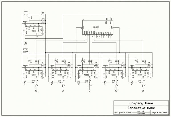

It uses a PIC and the MIDI conversion is mostly based on some code I found online. It sends out a much higher frequency,
probably using a hardware PWM output, which gets divided down by a binary counter. It has a 555 in monostable mode for
each output to create short trigger pulses and it also inverts the outputs from the divider (555 triggers on a high to low transition)
which makes it much more useful for music. (especially drums)
Since the timing is based on a crystal it is very stable and therefor I usually use it as my main CLK oscillator. However, it is
not very accurate. This isn't really a problem most of the time but if I record something and I want to add some things to it
later (using ACID) it can be quite tricky to find the correct BPM setting. So, time for an upgrade to see if I can fix that.
more info about that later but here are some photos and a schematic of the current divider/trigger section.

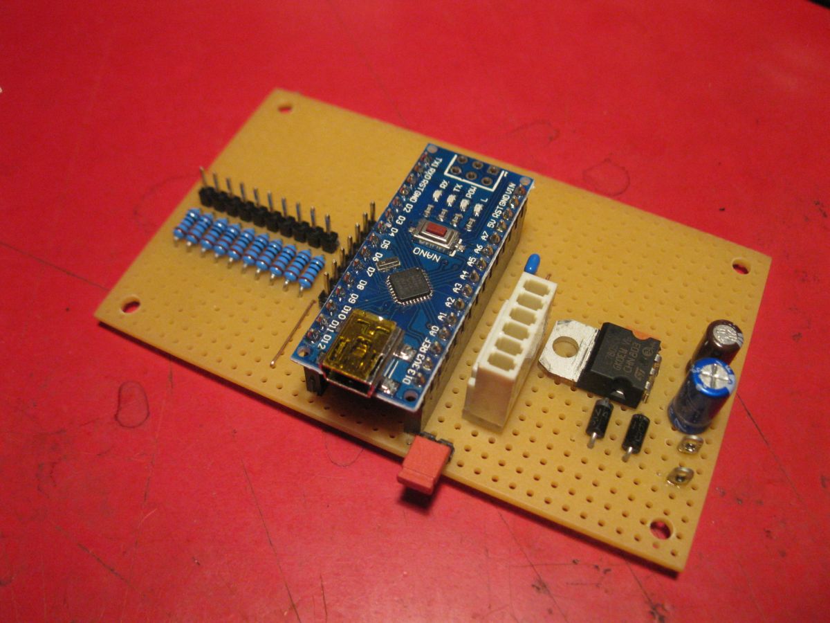

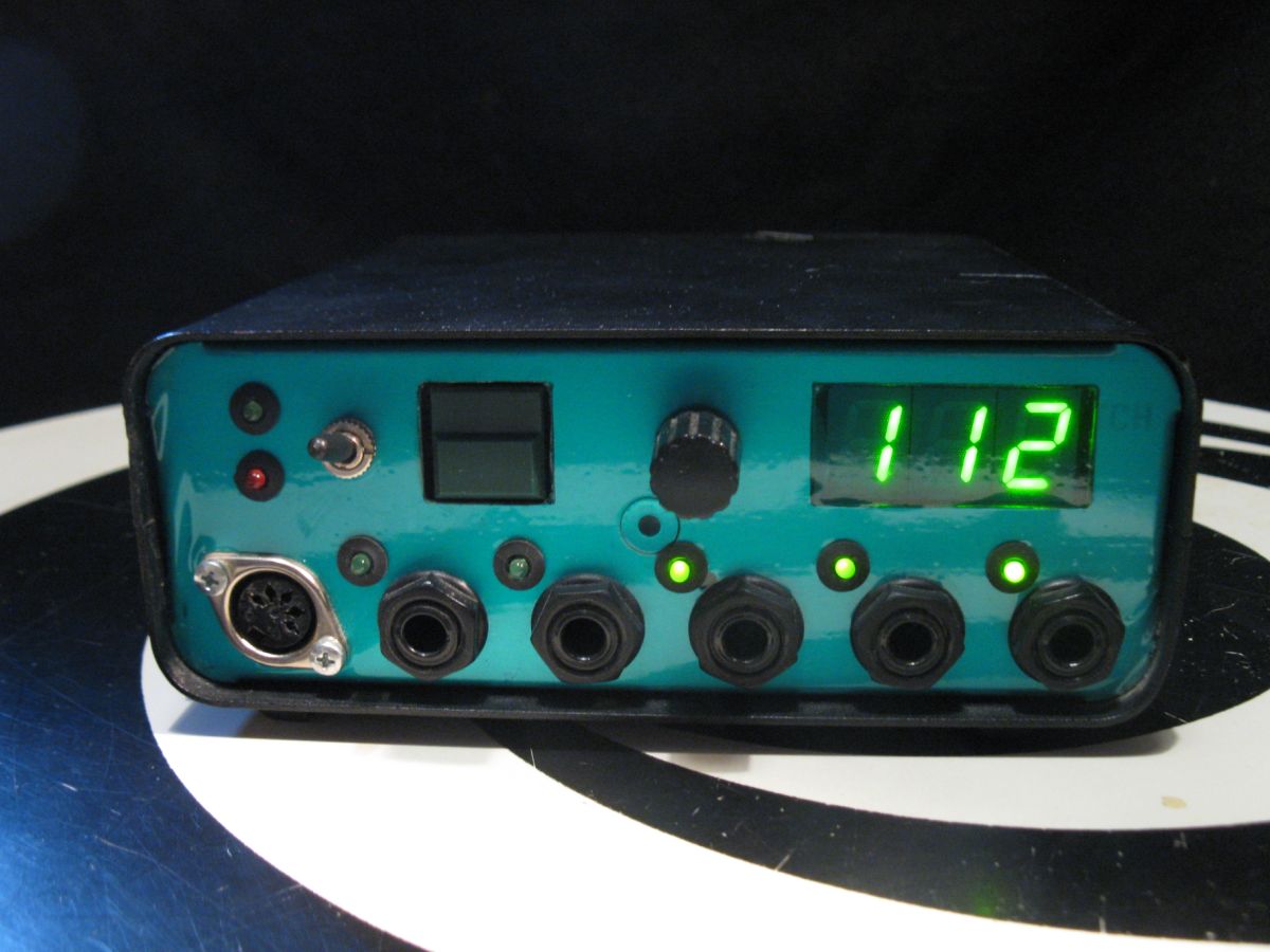

Instead of reprogramming the PIC I opted for using an arduino instead. I don't really know what code is in the PIC at the moment
and it would take a while to wrap my mind around it. I also find an Arduino much easier to work with and since that's what I've been
using lately it would get a bit confusing to switch back to another programming language (I use PIC basic for PICs). I also wanted
to get rid of the divider and 555's and the method of using a high frequency.
Besides having some problems with accuracy I also want some other divisions. Over the years that I used it I've mostly made use
of the x4 and x2 outputs and pretty much never the /2, /4 which I can easily do externally anyway. So Instead I think it's much more
useful to have some triplets (BPM x3, x6). I've also been thinking of making it adjustable per output and one idea involved pots/CV
but I wouldn't be able to fit that in and maybe another module would actually be more useful for that anyway.
I wrote some code and tested things connected on a breadboard and that seemed to be working. However the midi input misbehaved
once I soldered it together and put it in its housing. When I tested it I used my MIDI test board which uses a 6N137 optocoupler and the
BPM CLK oscillator uses a CNY17. This was working with the PIC though but just in case I replaced it with a 6N137. But that didn't work
either. Turned out that I had actually changed a small thing in the code and after fixing that the MIDI input worked as it should. doh
I did manage to fry 1 LED segment which I guess must have gotten shorted somehow Crying or Very sad luckely it is segment 'e' of the left display so
it is only visible with a tempo of 200BPM and up. I might even have a replacement for it, at least I know I have 1 green display somewhere
which might be the exact same one. I haven't been able to find it though.
Sofar everything seemed to be working but I did want to do an accuracy test which I did today. I let it control some drums and recorded
an hour of it to see how much it would drift. Well, a couple minutes would have been enough as it is clearly running a bit fast. Mad
I'll have to go over the code again as it is very well possible that I have a counter somewhere that is reset too soon. But I've also been
trying to find some info on the accuracy of the arduino itself and that worries me a bit. I think I will write some very simple code that
will give pulses at a fixed frequency and see how accurate that is. If that shows there is a problem I might be able to add some offset
somewhere in the code. Otherwise I might have to look into using some kind of external precision oscillator.

Posts: 5917
PostPosted: Fri Oct 25, 2019 11:40 am    Post subject: Reply with quote  Mark this post and the followings unread
I think I will write some very simple code that will give pulses at a fixed frequency and see how accurate that is.
I did a test with this:
Code:
void loop() {
  unsigned long start_micros = micros();
  unsigned long next_micros = 250000;
  while(1) {
    if (micros() >= (start_micros + next_micros)) {
      bitWrite(PORTB,2, !bitRead(PORTB,2));
      start_micros += next_micros;
Which is also running too fast. It's almost in sync with my previous test just a tiny bit faster.
Not sure if that has to do with my code or if it might be temperature related.
I think I might test what I get out of the Pioneer EFX500.
It can be adjusted to 1/10th of a BPM so I expect it is pretty accurate but I never really tested it.
