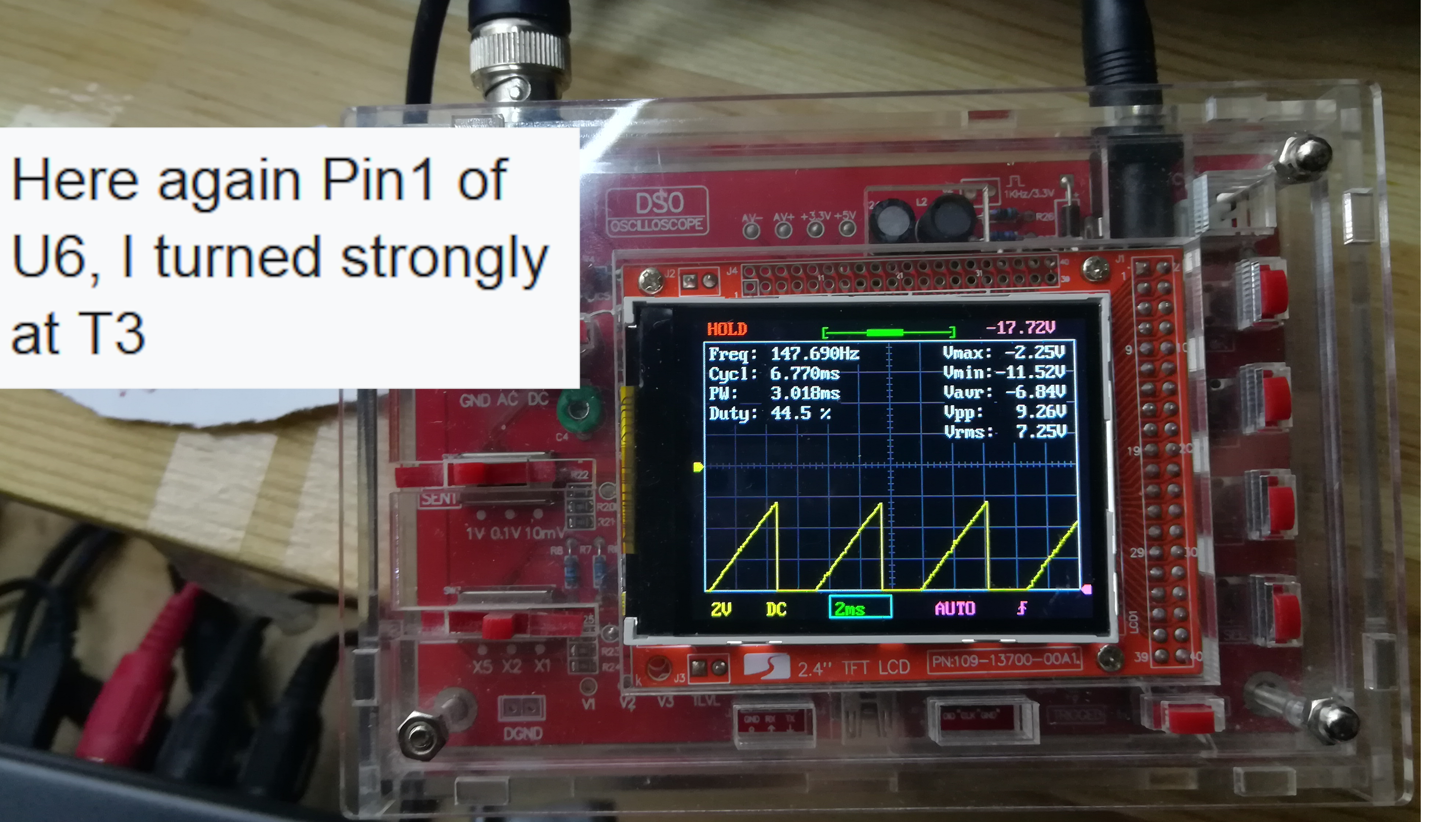

Hello friends,
I built the Yusynth VCO (12V with SSM2210) and calibrated it on the keyboard without any problems!
My problem is the T3 (10K Trimmer) "not responding", there is no change on the
Oscilloscope, I don't get +/- 5 volts for the saw, it is always -3V and + 7Volt, accordingly sine and triangle cannot be trimmed well.
The pulse wave seems to be good!
Can someone out there help and possibly know what the individual pin inputs and outputs of the ic`s should look like?
Grateful for any help!

Often the source of problems on these modules are cold solder joints.
Check the solder joints on T3. Then, assure that T3's voltages swings from Negative voltage to ground.
In addition, check the solder connections for R24.
The Yusynth modules are excellent! Hope this helps.

Peppy wrote:
They wrote: "Then make sure that the voltages of T3 oscillate from negative voltage to ground"!
You can check this with a voltmeter. Connect the ground of your voltmeter to the ground point on the circuit. Connect the other end to the wiper of T3.
When you rotate T3 you should see the (DC) voltage change from negative voltage to ground. Note that the negative voltage will only go about 2/3 of the way down to the negative supply voltage.
Again, if T3 has no effect, then check all the solder connections on T3 and R25.
If this checks out, then use your oscilloscope to check the output at pin 1 of U6a. You should see an inverted sawtooth wave there. As you move T3, the bias of the waveform should change (the waveform should move up and down as you vary T3).
Check all the parts around U6a to be sure they are the proper values and that the solder joints are good. Make sure there are no solder bridges, too.
From your description of the problem, the inverting amp stage with its adjustable bias (T3) is the culprit. Particularly, if the value for R25 is wrong or if it has bad solder joints, the inverter will act like a comparator and will output a pulse wave (of sorts) but won't give you a nice sawtooth wave.
Hang in there!

PostPosted: Tue Nov 30, 2021 4:58 am    Post subject: vco Reply with quote  Mark this post and the followings unread
Send you pictures here in the hope that you will recognize my difficulty! My trimmers as well as R23 and R50 are socketed with me can simply take it out for test purposes!

I think something is wrong with the wiper, it's only -00.3mv, it seems to be suspiciously little, I will measure the value of the r25 again (unsolder one leg). I could also try 82K (R23) as yusynth suggested, or What do you think ?
Posts: 1452
PostPosted: Tue Nov 30, 2021 11:34 am    Post subject: Re: vco Reply with quote  Mark this post and the followings unread
Yes, the wiper should vary from 0v to around -7 volts.

With your help I concentrated on the T3 and now noticed that the right side of R25 (5.6K) was short-circuited to the left side of the T3! Thanks for that ! I get a balanced saw, unfortunately the saw is broken again if I set the triangle well. There was a possibility for me to make all waves (Saw, Trianle, Sinus) look and sound good, but there were no 5v +/- in the waveforms, Sinus for example: 2v to 6.8v (total: 9v) I have with Sinus 1V too much? If so, could you possibly give me a hint where I could adjust a resistor?
Sorry that I write so much and annoy you
Posts: 1452
PostPosted: Wed Dec 01, 2021 6:53 am    Post subject: Reply with quote  Mark this post and the followings unread
Good work! Suggest you adjust to to get a good sawtooth then see if you can get a good sine and triangle by adjusting T4.

want to let you guys know everything that i most likely finally found the bug. I received my new oscilloscope today, the waveforms have immediately improved by 80%, sine and triangle are balanced, saw ok too! I will still work on the resistors that I have changed in order to optimize it even further and I am full of hope that I will get it to work well.
Conclusion: do not buy a china oscilloscope (do not buy a copy of the DSO-138)!
