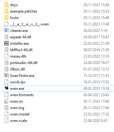

1) For some reason, Wren refuses to recognize included dlls. The only one Wren recognizes for me is portaudio-r64, but when it comes to libfftw3-64, r8bsrc and espeak-64, these are "not found" even though they all exist in Wren's root folder, together with abeforementioned portaudio. So when I open some patches, it says that this or that module can't initialize. How could I fix that?

2) No, there is no zoom option - maybe it will run at 150% windows scaling or so .. I have it at 1920x1080 with a 15" screen btw with no scaling

I'm using Windows 10, which is 64-bit. And Wren that got installed via installer is "win64r 2023.2.8.0".
Installation path I chose was "H:\APPS\WORK\Wren". So it's not "µsoft owned" folder.
This is how it looks for me:
When I read log, it seems to acknowledge that directory:

By the way, how does it know about all those additional software folders?

But refuses to recognize others...
0000:00 542 [STARTUP ] FFTW DLL not found in path, some modules will not work
0000:00 550 [STARTUP ] ESpeak installation not found in registry (HKEY_CLASSES_ROOT\TypeLib\{7192AA2F-F759-43E9-91E7-226371EF6B2F}\1.0\), or the DLL is not on the path
Weirdly, it doesn't even try to mention r8bsrc at all.
And as you see on screenshot, all of them are in main Wren folder, after installation from installer.

1) Odd stuff, it looks all good (except for not working Wink ) ...
Is H: a portable or an external drive maybe? No idea what that would have to do with it .. but ..
Maybe copy all Wren stuff to C:\wren and see what happens when you run it from there?
2) Wren knows about the additional folders trough the windows registry - which is where the PATH environment variables (a system one and a user one) are kept.
Automatically the current folder (where the executable was started from) is added to that (even when it not actually is in any PATH).
You can edit these from the windows settings and installed software will often add itself on installation.
Maybe you could add H:\APPS\WORK\Wren to one of the PATH variables .. although such /should/ not help Rolling Eyes
3) In my own logs r8bsrc is not being mentioned either ..I forgot why that is again .... probably loaded only when needed (it is used for modules using audiofiles, and I am not currently using any of those).

Ok, I'm back after some testing... Razz
No, it was an additional HDD that was added to my desktop, so it stays there all the time, inside of computer tower.
I've now tried that, and it didn't work. Confused
Now, this... seemingly made a change! Shocked
Or at least partially.
It says this now:
0000:00 736 [STARTUP ] probing FFTW DLL presence, looking for "libfftw3-64.dll"
0000:00 747 [STARTUP ] FFTW DLL found (it has no version information)
0000:00 757 [STARTUP ] ESpeak installation not found in registry (HKEY_CLASSES_ROOT\TypeLib\{7192AA2F-F759-43E9-91E7-226371EF6B2F}\1.0\), or the DLL is not on the path
I can confirm that r8bsrc, I guess, finally works now. Because I can open patch named "mobile information complex" which, from what I remember, was needing it. It doesn't give errors anymore when I open it, and I can hear stuff when I run it.
With FFT, I'm not sure yet. By any chance, do you remember which of your patches used it? So I open and check.
As for digital speech, I think it's still troubling (as it says in the debug console). I tried openining "czar powder" but didn't hear any voices (though I don't know if they should be there from the very start - when looking into your patch examples, I noticed you often create compositions where certain sounds appear over the time; I caught myself listening to them for a decent amount of time, haha!).

Ah, that sounds good then .. but still a little odd ..
As for ESpeak it needs it's own installation before theWren interface to it can work.
