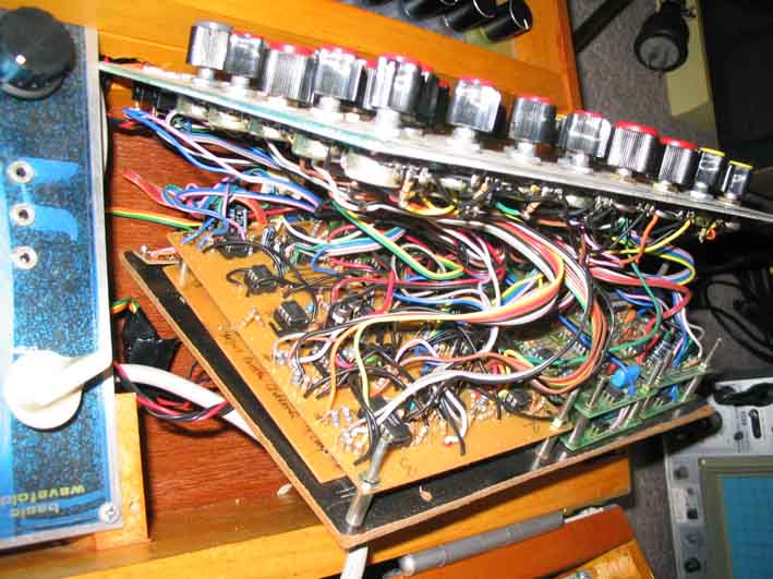

PostPosted: Tue Jan 09, 2007 7:04 am    Post subject: freq shifter Reply with quote  Mark this post and the followings unread
Electronotes has some good freq shifter designs, which is also included in the cheaper 'Preferred circuits' edition.
maybe there is a barberpole phaser in there too??, I remember some article about it.
I made a frequency shifter panel a few years ago, Core circuit was Electronotes FS, 3 CGS dome filters, 4 JH ring mods, 2 passive ring mods, CGS VCO.
Also included a modded 'Lissajous Pattern Generator' from a 70's Silicon Chip mag, strangely similar to the 'oscillograph' of another thread, I had some hopes of being able to get interesting effects by having adjustable phase and amplitude on the sine/cosine outputs - No, it is good on the scope tho.
pics here -
http://www.sdiy.org/pinky/frqshif%20004a.jpg
http://www.sdiy.org/pinky/frqshif%20003a.jpg
Andrew
