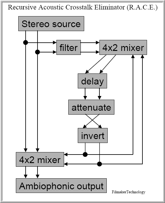

Ambiophonic stereo is a significantly better form of stereo than conventional placement of 60 degree speakers. There is already much literature about ambiophonic sound, see http://www.ambiophonics.org/ for starters. I have participated in many experiments with Robin Miller and I love the sound. You get a very much wider stereo field and no hole in the middle feeling.
Robin has developed a pretty simple algorithm for the ambiophonic phase cancelation encoding. Attached here is a diagram. It seems that ChucK would be a natural environment for developing a ambiophonic encoder. I would love to do it by I'm unable to work on this until the Fall. Would anyone care to take a shot a coding up a Chuck encoder?
It would be great if the left and right attenuate and delay values could be ganged and controlled by a MIDI controller.
UPDATE (April 7, 2008): With apologies, I have updated the diagram of the RACE Ambiophonics encoder. The previous version was incorrect. This one has been tested and works very well. The specs of the filter are bandpass 500 Hz to 5000 Hz. 12 dB/8va works well, but other values of selectivity can be used as convenient. The delay is best between 60 and 80 microseconds. Experiment has shown that 68 µsec is perhaps ideal.
RACE Ambiophonic phase canceling encoder block diagram. Version 2 updated Apr 7, 2008

howard, am i missing something here? wouldn't this be cake to do with the g2?
the 60 .. 120 us is a bit short for the delay modules, only possible in-range value is 90 us, so there is not much room for fine tuning.
Here is a proposal anyway, untested.
Edit : uploaded a new version to reflect Howard's changes.

The G2 can do this to some degree, and I have done a patch that works like Jan's but a little differently, but one has to have a G2. We need a good simple solution that runs without dedicated hardware. I thought ChucK would be ideal.

Hmmmm, that's micro second, right? a milionth of a second? The patch itself would be trivial but I'm not at all sure about micro second delays since the feedback loop itself would mean one sample of delay already which is already roughly 23 micro seconds at cd quality. I looks like the interpolating delays that can take fractional lengths like DelayA and DelayL should be capable of this sort of thing but the manual warns about "high-frequency signal attenuation to varying degrees depending on the fractional delay setting." which might affect stereo perception and which I bet will have a pritty large effect on moving sound sources.
It would also need a fairly elaborate controll structure to generate parameters and moving soundsources would demand interpolation of controller-data.
Isn't there a Csound opcode that's specialised for this?

With the G2, on can generate a 48 KHz clock and that has a period of about 21 usec which gives 60, 80, and 90 usec delays which it useful. Experience is that 70 to 80 is the best value - depends a bit on your head dimensions and on the speaker setup.
Kassen, can't you run ChucK at 96 KHz?

I'm fairly certain it has specialised tools for this. Perhaps the main advantage of those would be that they take straightforward parameters with regard to the direction of the sound.
Yeah, those are within that range but HEAVILY quantised which translates directly to quantisiation of the directions a sound can come from.
Yes, no problem. When rendering off line I think ChucK can actually run at arbitrary bitrates though obviously playback of such files would be impossible on most DAC's and going into the MHz range would result in very large files as well as lots of render-time but I do think it's possible. I'd have to try how well those interpolationg fractional delays hold up on this sort of aplication. Maybe they would be fine at 96KHz. Another question would be how to generate the controler data, is there literature on this?

Ok, Did a quick test and it looks like DelayL in ChucK can be set to .0001ms. When asked it then reports it's length is "0.004800 :(dur)" which is exactly right (it runs at 48KHz on Linux by default).
So; yes, ChucK should be able to do this, I'm not sure wether it'll do it very *well* and I'm also not sure where I'll get those durations or amplification amounts from but it should at least work on a theoretical level. I'd also imagine that any system in the sub-MHz samplerate range will have artifacts with this sort of delay length.

I put together a synthedit VST and ran across something that makes sense. I did not try the EVM sample based delay, btw, but first used the delay2 module, which accepts a .00006 value.
Within the VST, data is passed between modules as blocks of samples. If you try to introduce a feedback loop (which this schematic does, out of the delays and back to the mixer) you generate an error. You can avoid this error by inserting a 'feedback delay' in the offending feedback path. However, because the blocks are in sizes of 100 samples, inserting this will not permit a delay value of less than 100 samples: I ended up with a kind of tinny sounding flanger as a result. Smile
I'm using a slightly outdated version of synthedit, maybe this behavior has been modified since.
I *did* realize a VST that kludges the signal path: it adds some brightness to the mix by mixing the split, partly inverted, ever so slightly delayed signal with the original signal. When used on the master (stereo) track, the end result is a crisper mix that loses a bit of bass. You can recover the bass by adding a post low end boost, and this technique also seems
to 'de-muddify' the bass as well.
