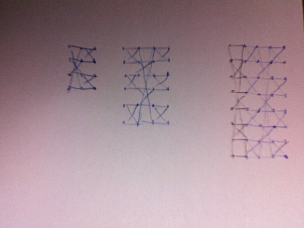

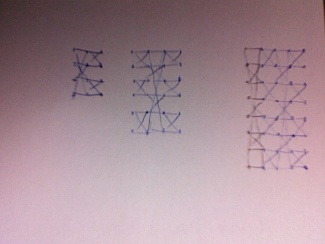

PostPosted: Tue Jun 05, 2007 11:34 am    Post subject: Reply with quote  Mark this post and the followings unread
OK, I updated the patch to shuffle 8 inputs, and attached a little sketch showing the principle. Note that although in the new patch (the old was a little buggy) e.g. input 1 may be routed to any output, there is a greater chance that it will be routed to output 1 or 2, since there are more paths to those outputs than the others. Maybe the switching can be tweaked so the spread is more even?
As can be seen in the sketch, only three columns are needed for six inputs, and two columns for four inputs. Also note that I only used the muxes here to show the values visually, when using this replace the constant modules with input, and the muxes with output.
Still a little bit cheaper than Jan's version on the cycle side, I think, although bigger and consuming more memory. Another downside is that I don't know how to reshuffle without having a short moment where all inputs are routed directly to the outputs (random triggers only stay up as long as there is a live value at the Clk input).
This is fun! Very Happy
/Stefan
Switch illustrations: 8 to 8, 6 to 6 and 4 to 4
 Filesize:  64.07 KB
 Viewed:  1049 Time(s)

PostPosted: Tue Jun 05, 2007 3:36 pm    Post subject: Reply with quote  Mark this post and the followings unread
a primitiv solution for only 3 input and no propper random...
bit its the cheap and dirty way when oly 3 inputs are enough

Posts: 24676
PostPosted: Sat Jun 16, 2007 6:33 am    Post subject: Reply with quote  Mark this post and the followings unread
Sorry for not having found time yet to go on with/into this - got some time consuming other things.
I saw this was posted as a building block - it seemed appropriate to link it from here : http://electro-music.com/forum/post-124787.html
