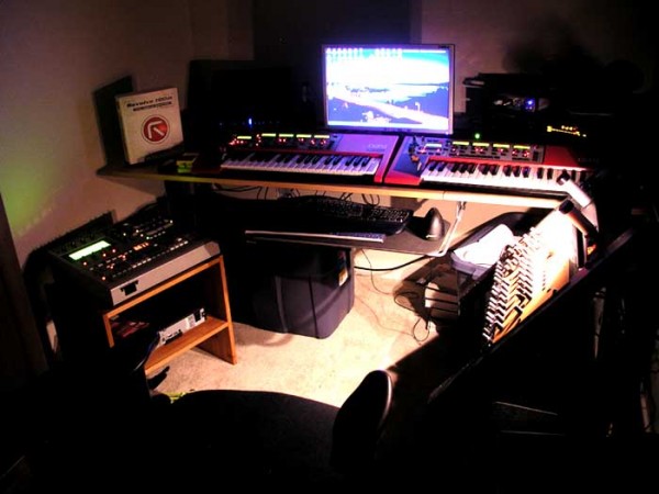

PostPosted: Fri Aug 24, 2007 11:56 pm    Post subject: Reply with quote  Mark this post and the followings unread
after 4+ years, I have no more gear closet to "hide" my gear in. I am (not pun intended) out of "that" closet and into my own studio room. I am very happy and somewhat reluctant to take a whole room up with my electronics.
here is the picture for elaboration. Notice a copy of Revolve 100m sequencer s/w I produced in the 1990's (eventually for Opcode), Rs7000 (left most)), 2 G2 keys with monitor between them, one DAT machine as A/D for Waldorf xt (right most in rack, with all those 44 knobs)
Damn, this space gives me good inspiration. Good! Share your space for inspiration!
/Dasz

thanks g2dream (some would argue you ought to change your name due to the no more OS fear, but for me I dream in g2 modules, regardless of updates)
Here is the g2 patch (very simple btw). the g2 must run on the same midi channel as the xt (and control it). All it does is add some saturation and OD and adds an osc for testing purposes.
the connections are
1. g2 loaded with this patch and output 3 out goes to xt audio in. the xt's sub outs are connected to g2 input 3&4
2. xt has a multi with 2 patches (both on the same midi channel as the g2)
a. Out patch - mixer goes to 2 completely open LP filters (cutoff max, res, 0) this goes to sub outs
b. In patch - all mixer levels off except for external in. You then pass through the xt filter of this patch and adjust & midi control it (if you want to)
Reading about the waldorf Blofeld and it's brilliance parameter drove me to try it out for myself ...
I know there are lots of folks with an xt and a g2 around these parts ... I'd love to hear what you do with them & how you combine them -- with examples. It is inspiration for me and others to hear these ideas to drive us to do new things (call it our internal OS updates Wink )
/Dasz
