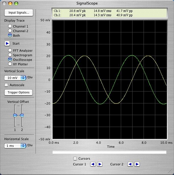

This is to generate sin(x) and cos(x) signals, made from basic "math" modules. Basically, it is a 2 pole filter with Q=1, forced to self oscillate.
See oscilloscope signal, there is a 90 degree phase shift between the two outputs to obtain sin(x) and cos(x) signals.
("blue" and "red" versions added.)
ik.

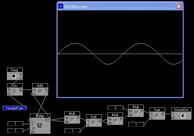

...where is a good place one can read up on the theory on how these "math" patches work?...
MusicDSP has lots of code (many way over my head Embarassed ):
http://musicdsp.org/
While the G2 was not particularly designed for this, it is an interesting area to explore ...
I usually try port the C++ code first into SynC Modular, (some already there!) since it is easier to explore there, and when/if it's working, I port it to the G2 (if I can ... Wink ).
As a very simple example, I found this code at MusicDSP:
"Cheap pseudo-sinusoidal lfo
References : Posted by fumminger[AT]umminger[DOT]com
Notes :
Although the code is written in standard C++, this algorithm is really better suited for dsps where one can take advantage of multiply-accumulate instructions and where the required phase accumulator can be easily implemented by masking a counter.
It provides a pretty cheap roughly sinusoidal waveform that is good enough for an lfo.
Code :
// x should be between -1.0 and 1.0
inline
double pseudo_sine(double x)
// Compute 2*(x^2-1.0)^2-1.0
x *= x;
x -= 1.0;
x *= x;
// The following lines modify the range to lie between -1.0 and 1.0.
// If a range of between 0.0 and 1.0 is acceptable or preferable
// (as in a modulated delay line) then you can save some cycles.
x *= 2.0;
x -= 1.0;
Now, the SynC port looks like this (see image):

2*(x^2-1)^2-1 in SynC Modular
