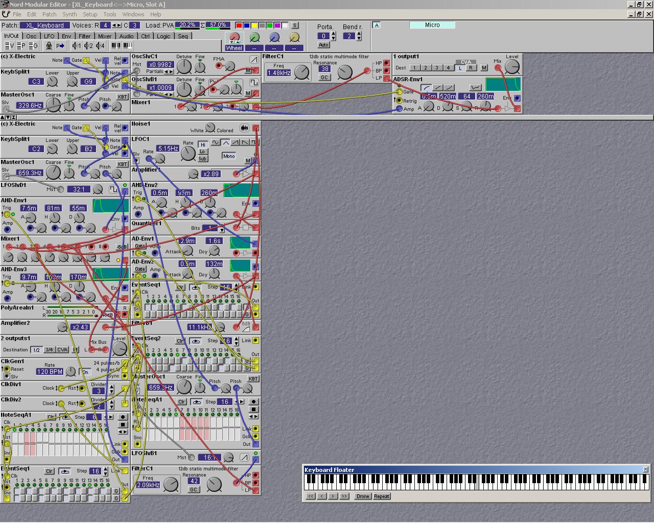

PostPosted: Wed Sep 20, 2006 1:31 pm    Post subject: Reply with quote  Mark this post and the followings unread
Here's my straightforward approach to arpeggiators. The patch itself is a simple rendition of cheap plastic keyboards, although I managed to get a harmonic arpeggio line, bass line, drum rhythm and a lead voice still with 3 voices poly on Micro Wink
First 12 notes on a keyboard are meant to choose the base note, and Mod. wheel changes chords from Minor (down) to Major (up). It's pretty easy to use and play. I'm attaching a screenshot and an audio file for those without first generation of Nord Modulars. (Don't mention my crappy play abilities - audio file was made in one shot in a hurry)
Screenshot of the patch.
