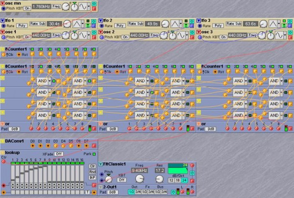

Joined: Apr 03, 2004 Posts: 24506 Location: The Netherlands, Enschede
Posted: Mon Feb 13, 2006 12:50 pm Post subject:
This might be representing the original idea better.
[Editor's note: The picture down-sizing feature now works. Click on the attached picture and see the larger size. --mosc]
| Description: |
| Screen dump of uncle-2.pch2 |

Posted: Thu Feb 16, 2006 5:00 am Post subject:
When it comes to testing this out. On the circuit as I originally drew it, what should I hang off the output? A volume pot (I s'pose) of what value? Before or after a de-coupling cap (of what value?) Why? _________________ What makes a space ours, is what we put there, and what we do there. |

I'd AC couple it and use a pot of approx 10 K, which sort of sits nicely between (assumed) 100 K input impedance of the circuit coming after it and the about 1 K impedance of the driving circuit. The capacitor should be something in the order of 220 nF ir so then to allow for a lowest frquency of about 10 Hz or so, didn't really calculate it though, but it won't be off by orders of 10. When it turns out it should be much larger an elco is ok, plus side on your "DAC". _________________ Jan

I never know these things until I try them, so I would look at the following:
1. Run it through a voltage follower (op amp buffer) through a 1K resistor and perhaps a 1uF cap (kinda like Ray did with the WSG)
or
2. Run it to a two stage mixer (two inverting op amp buffer stages), and mix in a bit of +V via a trimmer into the second stage to center the signal around 0V, with a 1K resistor on the output of that. A bit more parts-wise, but then you don't any capacitive coupling/frequency content concerns.
or
3. Run the signal through a cap and resistor to the input of a voltage follower (op amp buffer) with a 1K on the output. This would center the output around 0V with less parts than (2) and not have the cap matzoh ball on the output (1). Not sure if the cap on the output is a big deal, but I like to keep my outputs 1K output impedance, and I'm never sure if Xc is a factor there or not when interacting with my other modules (most likely not). Still, I like to have just the resistor on the output.
This is all assuming you have +/-V rails on the circuit.......

Scott's ideas are better than mine, I was just thinking you could do that later, when you like the results :-) _________________ Jan

Well it's up and running on the breadboard.
I'm pretty impressed with it so far, and I've only heard a couple of it's possible waveshapes. It's got a PWM square wave kind of timbre, (as you'd expect) but there's also some beating going on in there. (I think the 555 is contaminating the supply rails slightly and the propagation delay of the 4017 means it's always slightly out of tune with it)
It'd make a great bender. If you touch any of the diodes feeding the switch matrix it affects the ability of the 4066 to switch at the right speed and you get instant phasing like effects. The actual backboard of the breadboard also acts like some kind of aerial, touching it makes a definate change in the timbre of the wave!!
It seems so far that running the 4017 at about 2K is as far as I can go before the 4066 can't switch fast enough. At that point the switches stop reacting and everything goes quiet. 2K/8=~250Hz fundamental)
I'm thinking that improving the wiring and layout could improve that. Maybe there's a faster version of the 4066?
So I'm really quite happy with it so far.
It's got a fat square weird phased PWMed twitchy kind of sound which is about as stable as any other badly constructed high speed digital switching circuit! Which I reckon is pretty cool
I'll try to get some samples soon.
Thanks heaps everyone for all your help. _________________ What makes a space ours, is what we put there, and what we do there. |

A had a quick look at the 4066 data sheet, it should be able to go much faster than 1 kHz (maybe even up to 10 MHz).
My guess is that the diodes together with the input capacitance of the switch control lines is the limiting factor. The control lines have hardly any ability to go low now. You could add pull downs (10 .. 100 k I'd guess) on the switch controls, or alternatively replace the diode's wired OR function by real CMOS OR gates - pull downs is probably nicer from a benders perspective :-)
Re. the capacitor, probably between the DAC and the pot, that way you are guaranteed to have no DC over the pot, but after it would work just as well otherwise. _________________ Jan
