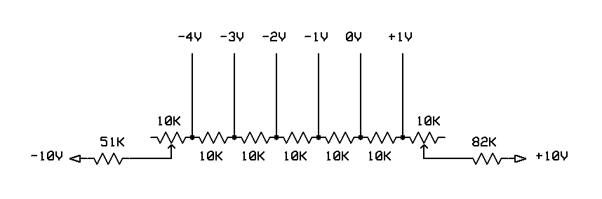

PostPosted: Thu Mar 27, 2008 7:57 am    Post subject: Reply with quote  Mark this post and the followings unread
In reply to both Jan and Etaoin (how do you pronounce that?)
I understand your concerns and advice, but this octave switcher is for a self contained ASM-2. It's not a modular. It has it's own PSU, and dedicated reference, so I'm not that concerned with running clean power to the "workhorse" if you know what I mean. And this octave switcher, or rather two of them, will hang off the back of the actual rotary switch. It's a special feature, not a separate module. Small, simple, accurate, that's the need.
And with that I submit my solution: -
It's designed to solder directly onto a 12 position rotary. Across the position 1 (-8V), Pole, and position 6 (-3V) pins. I actually went for the full 9 position version, which means 10 connections to the switch. All but the aforemention 3 must be made with solid strand wire.
 Filesize:  19.09 KB

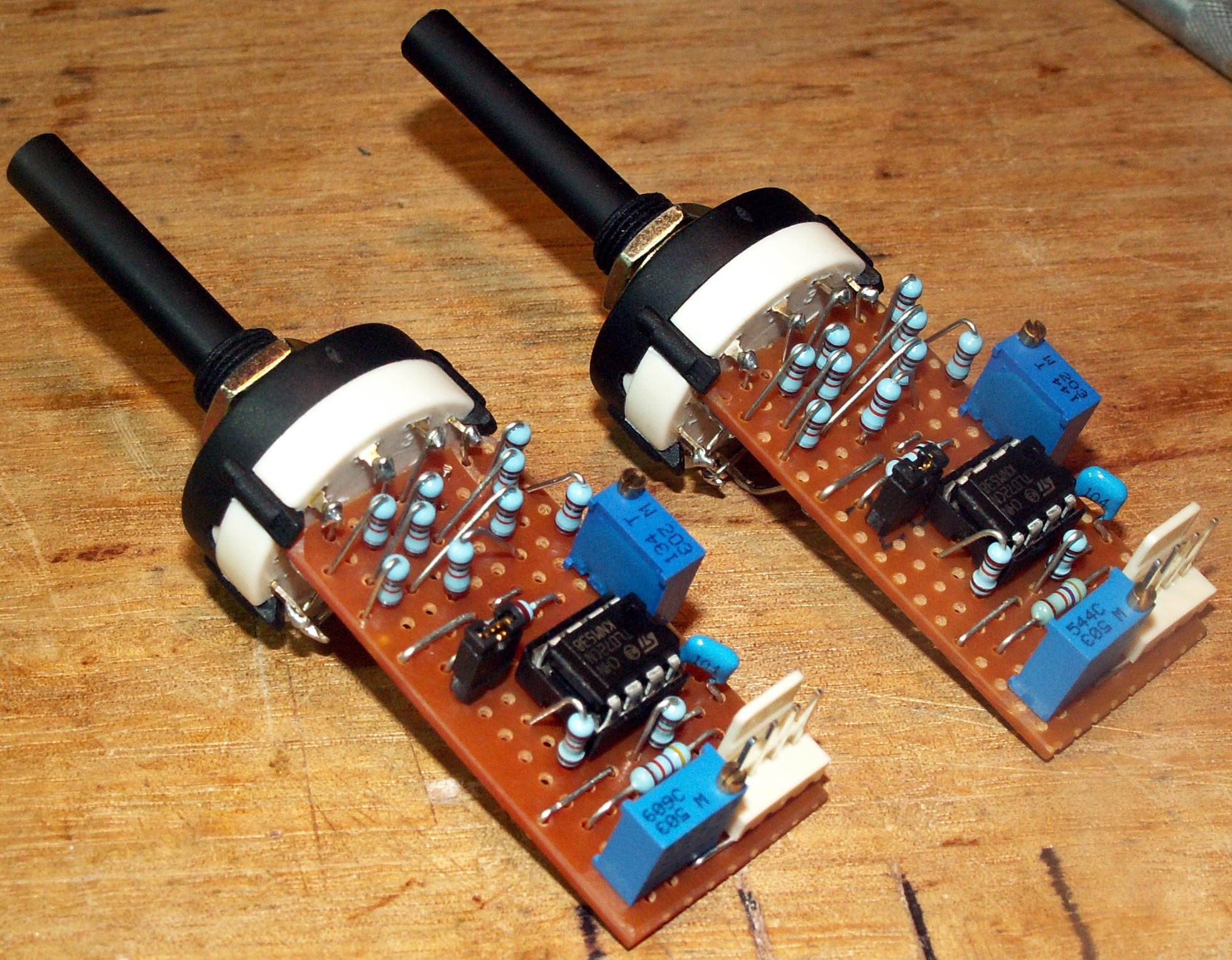

PostPosted: Sat Apr 12, 2008 4:34 am    Post subject: Reply with quote  Mark this post and the followings unread
Okay,
The sync buffers are finished, and so too are the new octave switchers.
And here they are.
Purty aren't they?
I need to update the stripboard layouts I posted before anyone uses them. (minor changes)
I'll get these babies into place and see if I can't teach that Klee sequencer a thing or two! Laughing

PostPosted: Sat Apr 12, 2008 7:54 am    Post subject: Reply with quote  Mark this post and the followings unread
Do not build this octave switcher.
It's been trolled to output the opposite voltage.
I should have known, I was close to asking, isn't that an inverting buffer followed by a non-inverting buffer? Doesn't that mean the output will be upside down?
Anyway, I'm gonna replace the -10V into the divider with +10V, and it should be fine.

PostPosted: Sun Apr 13, 2008 9:45 am    Post subject: Reply with quote  Mark this post and the followings unread
Okay, they work perfect now!
I've also updated the stripboard layouts a few posts back.
As well as changing the polarity of the resistor chain to +ve I also had to change the offset to -ve. After putting those two summed voltages through the inverting stage U101B you get the right voltages for the right positions on the rotary.
