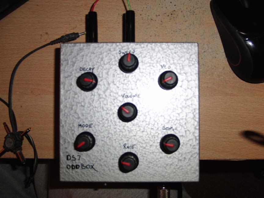

ok after several attempts at making a ds7, i failed bigtime. sooooo, i started touching wires around and got some interesting sounds (very unprofessional i know :p ) but anyway, here it is

it was actually the triggering that was causing the problem, it never really worked. just had a weird sort of effect, the more i turned the "delay" knob the longer it took before any sound came out. checked the schematic loads of times, i must have missed something. i still have another one of these boards and it would be nice to actually get this thing working. so any ideas will be appreciated.

1) I'm having a similar problem in a similar circuit: When triggered, the envelope start is delayed instead of the expected fast Attack.

At the risk of saving face for Richard, may I suggest hanging a large value resistor (1-5.6Meg) between the input jack and ground? On all my drum modules with a cap in to the circuit, I have to do this to get it to trigger properly.

Well, I'll be--!
That was simple. Thanks, Dan.
Now I need to figure out why there's no Decay, despite increasing the cap or the Decay pot. scratch
