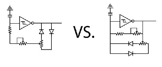

Salutations to you all. Long time lurker, first time poster.
I've been trying to implement adjustable duty cycle on some simple multivibrators. Disappointingly, when using only one diode it will work, although it also will cause the frequency to change.
So I've narrowed it down to two configurations.
I am having trouble deciding on which configuration might be more accurate. I'm looking for the version that will affect the frequency the least... Would there be any noticeable difference?
Also, should the pots be linear or log?
Any thoughts?
Sorry if this is a "find out yourself" type question. I can't really test it myself at the moment. I'm in between my parts ordering stages. But I would like to get my schematics right while I have this on my mind.

I don't think it will make any difference.

I don't think I've ever seen the right one but Im very sure the left one works without changing the frequency.

I can't even begin to figure how the right circuit behaves. It looks as if the location of the freq. pot pretty much defeats what the width pot is supposed to do.
In the circuit on the left, the width pot won't affect the frequency, but each pot's value will affect the range of effect obtainable from the other. Consider if both pots are 100k and the fixed resistor is 1k. The setting of the width pot doesn't matter. Whether it's set for 1k half a cycle and 99k the other half, or 37k/63k, the total average value with respect to the timing is 50k. If the 100k freq pot is set for zero ohms the value R in the equation f=1/RC (which is only approximate for these oscillators,) is 51k, and the pulse width can be varied from roughly 2% to 98%. If the freq pot is set to 100k the total R is 151k: only 3 times what it was with the pot at 0. The freq range is only 1:3 Furthermore, the the pulse width range is reduced by 1/3rd (I think,) because the 50k average value becomes a smaller percentage of the total R.
Attempting to get a wider frequency range by increasing the value of the freq pot just makes matters worse, width-wise. Increase the width pot's value, and frequency range will again be diminished. The trick will be finding an acceptable compromise of freq range vs width range.

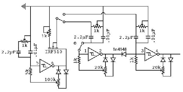

The reason I ask is cause now instead of using range cap switching, I think I want to just make the frequency knob have a massive range. Something like roughly aiming near 10Hz-15000Hz. Would that be too unreasonable, or do you think it is feasible?
Attached is what I'm trying to work on so you get a better idea of my intentions. Any values jump out as ridiculous or unnecessary? Should pots be linear or log?
Thats why I would like as many useful equations or methods to help me get as close as possible on paper before I tweek the rest on the breadboard.. Also so I don't have to bug someone else for work I should be doing and learning for myself.

Because of the diodes, the width pot's contribution to the frequency can be only half its total amount, no matter where it's set. 47k is slightly less than 10% of 1M/2, so fully clockwise or counter-clockwise the width will be 10% one part of a cycle and 90% for the remainder.
I think I understand the ƒ=1/RC equation...
Vcc plays a part in calculating the frequency of schmitt trigger oscillators. I've ignored that and haven't calculated anything: I've guesstimated. I start with common parts values, then increase or decrease until a circuit sounds like what I wanted.
I don't understand what the fet is supposed to do. The width pots should be linear. For freq, I don't think it matters too much.
I only tried 1M for that freq control method. I don't know if more than that would be useful or usable. 5M is impractical for two reasons. First, for some unknown reason high-value pots are getting harder to find. Even 1M is not as common as it used to be. Secondly, tuning will be extremely coarse, especially with the unrealistic range you stated.

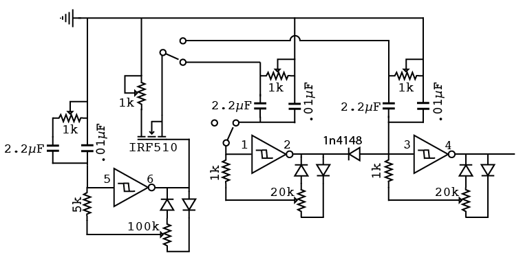

The mosfet is 'sposed to be a switch controlled by the LFO, modulating frequency of either the main osc or the synced osc. It turns on and off the extra pot reducing the resistance of the one it is attached to. Is that wrong too? I just followed the example of the "How to make a digital synth" on the hackaday page.
Other than that, I think I understand everything a little better now. Thanks so much for the help. *big smile*

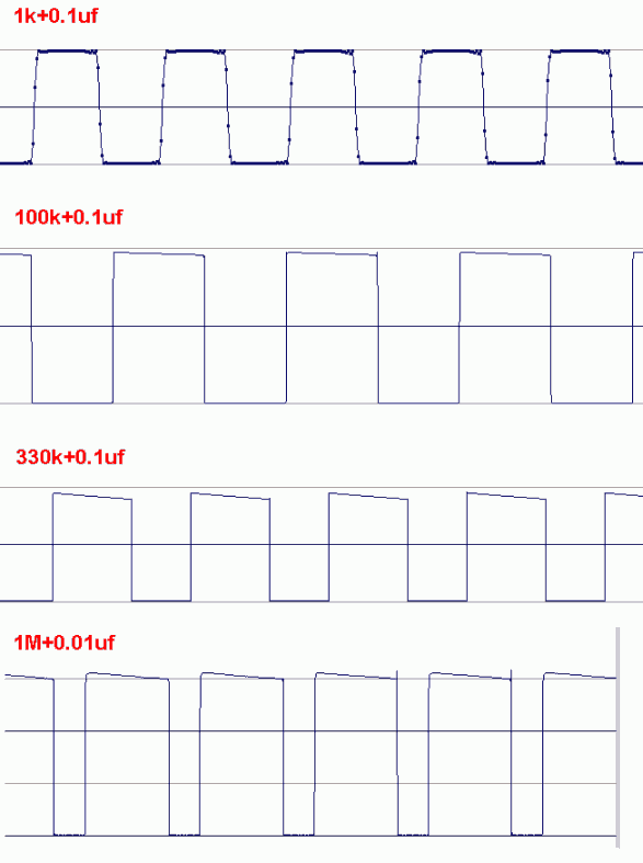

I found another reason not use too high a value for the feedback resistor: it affects the duty-cycle regardless of any width control that may be present.
As can be seen in the screen captures, at 100k the waveform is fairly close to being 50-50, but at 330k the asymmetry becomes more significant. With 1M (and a smaller cap to keep the freq reasonable,) the shape is most definitely non-square.
This is something the schmitt trigger datasheets don't mention. (Edit: Or maybe they do -- somewhere in the equation.)
There's probably some highly technical explanation for this, and the slope of the "1" state might offer a clue. But the effect is of little concern when the oscillator is an audio source -- especially in Lunetta's, which are supposed to be "dirty." As modulation or gating, though, the asymmetry could be noticeable and undesireable. It might cause glitches when clocking sequencers and latches, and is an added complication when attempting to control the pulse width.
If I knew how to inset this as text, I would have. And WTF is that lower-case script "L"?

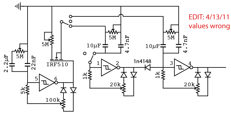

Just though I should update with a more or less fixed version of the schematic I posted. I didn't like the idea of having it up with no heads up on the wrong values.
This one is a tad better, but I'm still experimenting with capacitor values.
