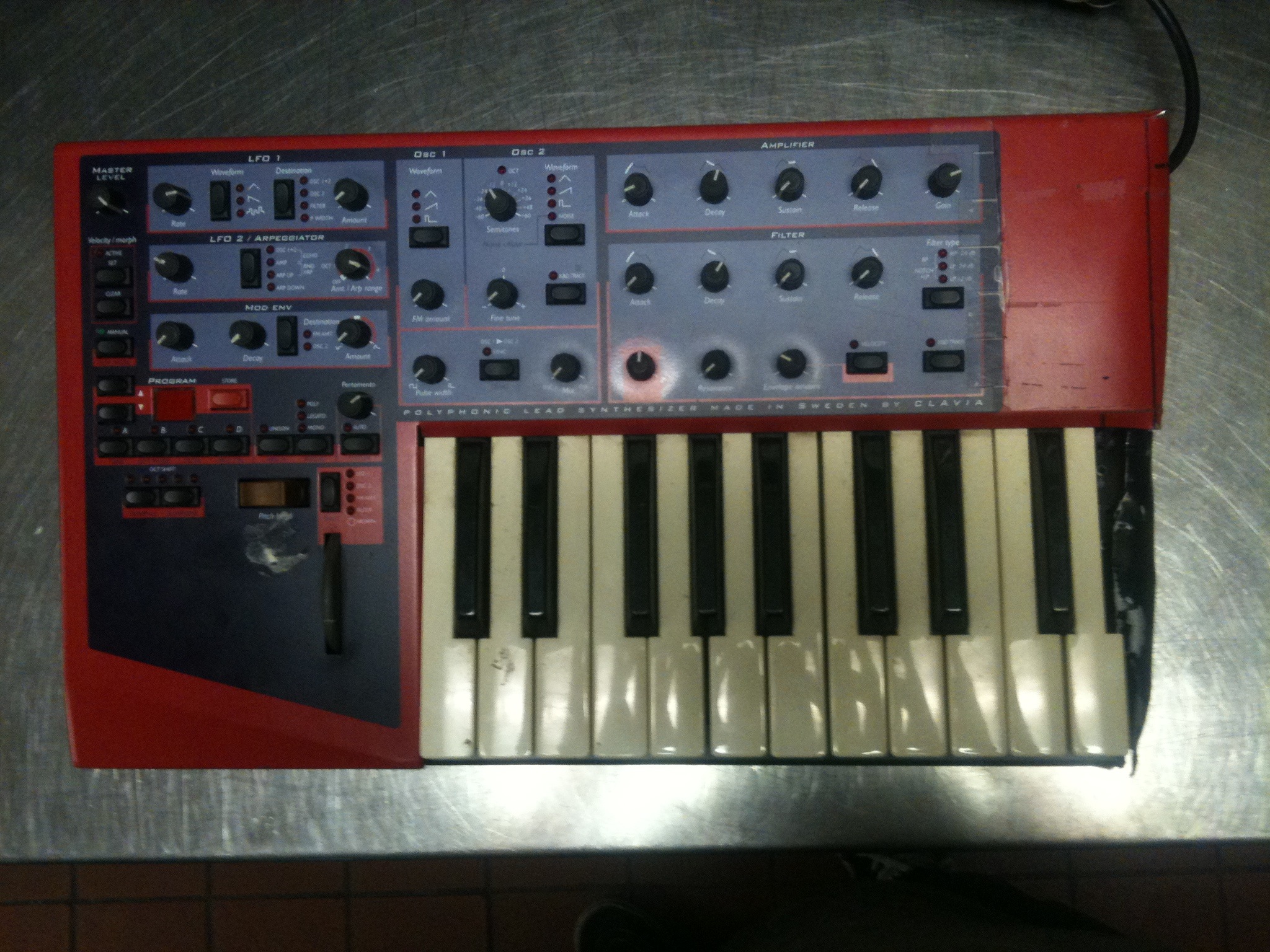

You are asking what's going on here...?
(Synth has been reduced to fit the page...)
Anyway, the main operating part of the OS doesn't find the Keyboard any more, so it assumes it is a Rack. Probably you cut away something important...
Maybe someone from Clavia can tell you what to do. Sending some parts to install.

i didnt cut anything other than the metal that cases the synth and the extra plastic that the keys i removed were connected to. there are 2 PCBs that are responsible for the keys; one large PCB with the higher pitched set of keys that starts after the last key you see in the pic, and one PCB that starts with the lowest pitched key that continues to the last key you see. i simply unplugged the large PCB and cut the case down to size. it really is a cool modification. (i admit my metal working skills could use some work)
At any rate, im assuming that "rA" means its in rack mode? is there any way of toggling between the 2 modes? |

No, the synth is doing it all by itself. When it detects the Wheel, PitchStick and Keyboard it 'knows' it is a Lead, otherwise it will be a Rack. Or the connection between Wheel and Stick is gone or it has to find the Keyboard.
I don't know exactly, but Clavia can tell...

1) check wire connections from mod wheel and pitch stick to panel board
2) check C17 and C19 on panelboard. The config is NOT auto-driven. The keyed versions use 0.1uF caps in those positions; for the rack versions those are replaced with jumpers.

Anyway - I don't know if you ever fixed it, but if you could fit the PCB you removed into the shortened case and plug it back in then the synth would have no idea that the keys are actually missing.

cbright: You may have some success finding another complete Nord Lead to observe the architecture of the stuff you cut away. There's likely some clues to point you in the correct direction.
