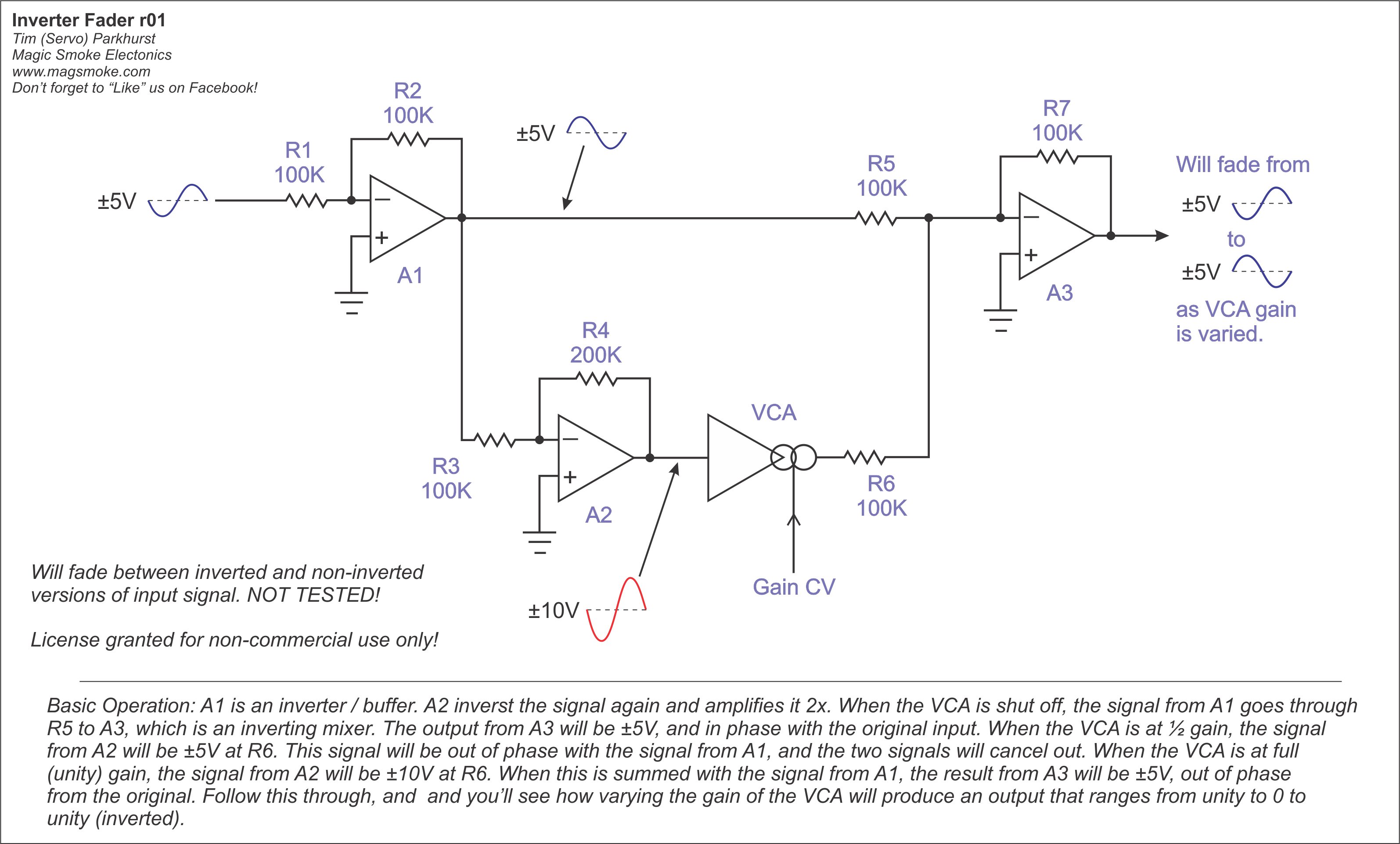

How about this for a VCA circuit that would fade between non-inverted and inverted versions of an input?
I haven't tested this, but I think the theory is right... any thoughts?
Tim (in theory, until it goes "Blammo!") Servo
That looks fine. If you use an OTA where you have "VCA" labeled, then A2 and R6 are not needed! Just feed the OTA (-) input from an appropriate voltage divider. Then design the OTA control current to proved twice the maximum output current as the current through R5, ie 0.1mA max. Finally, drive A3's summing node directly from the OTA output!
This illustrates how it is often advantageous to think of the summing node of an inverting opamp summer as a current summing node, ie, total input current is zero. Then the currents can come from OTA outputs directly as well as from input voltage through input resistors.
Ian

frijitz wrote:
Ian
Wow, I definitely would not have thought of that. Nice! Okay, so you could throw this together with a 3080 or half of a 13700 and simplfy the circuit further. I may have to give that a shot this weekend. Thanks for the tip, Ian.
Tim (all about the simple) Servo

Ahem...this signal cancellation process looks awfully familiar to me.
Would it be possible to eliminate A2 by using the OTA's inverting input?
