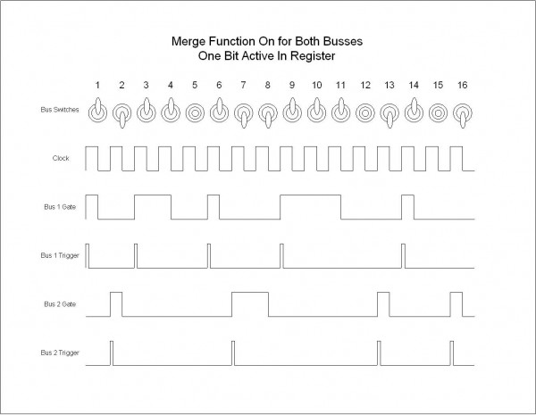

The thought occurs to me that my concern over 20 us of difference between gate and trigger is a bit foolish. After getting some much needed sleep, I realized that most EGs are retriggerable - the trigger is independent of the gate. If you have an EG gated, then trigger it, it still reacts to the trigger. The human brain has no way of knowing that something happened .02 ms after something else did.
This day's chapter deals with the 'Merge' function I mention every now and then. Its function is to merge the gates of adjacent selected bits into one big gate instead of individual discrete gates. It also eliminates the accompanying discrete triggers - it produces one trigger for the gigantor gate.
This function is intended to be able to create notes of varying lengths in a sequence. Another method would be to clock the Klee with a pulse width modulated VCO (the gate will be as wide as the clocking pulse). In this instance, the gates will be of varying length, but the triggers and gates will occur in unaltered numbers.
I've attached a couple of illustrations of the merge function. They illustrate the row of bus switches in varying up (bus 1 selected), down (bus 2 selected) and middle (no bus selected) positions. Below that is the clock signal, and below that are the gate and trigger outputs of each bus.
The examples illustrate the simplest use - using only one active bit in the register. Once more than one bit goes active - Klee function as opposed to 'normal' sequencer function - it gets quite varied. I'd have to produce 64K drawings to illustrate all of the permutations Very Happy .
Cheerio,
Scott
Merge function off for busses 1 and 2.
 Filesize:  80.73 KB
 Viewed:  235 Time(s)
Merge function on for busses 1 and 2.
 Filesize:  78.49 KB
 Viewed:  227 Time(s)
