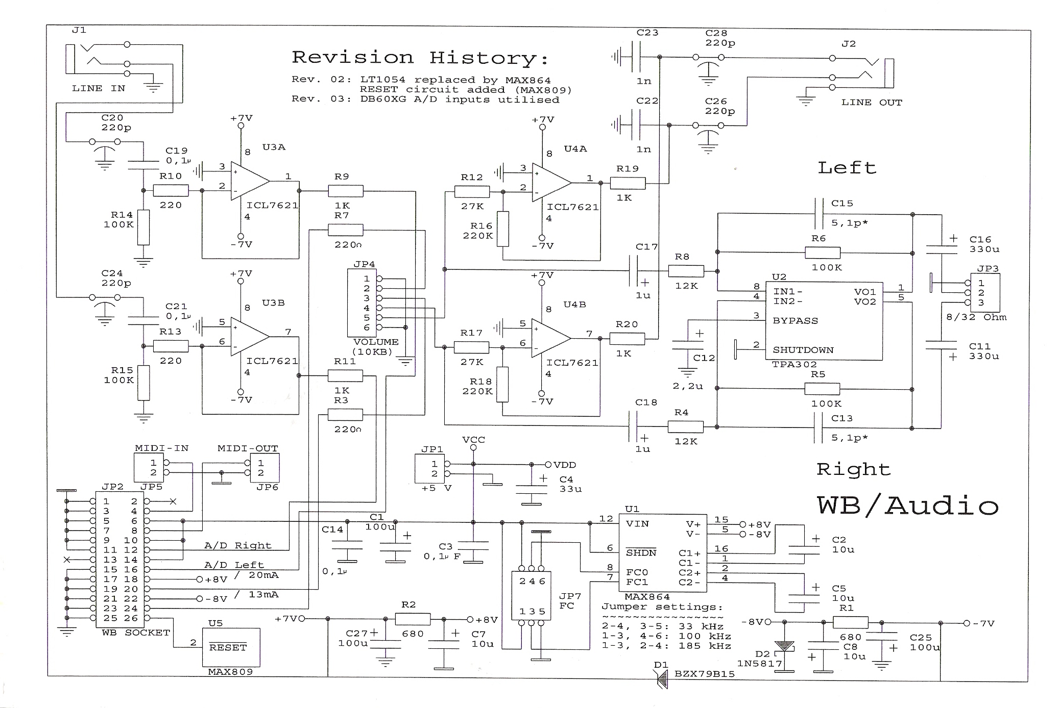

PostPosted: Mon Nov 03, 2008 1:53 am    Post subject: DB60XG Pinout
Subject description: Old Player Schematics
Here I send you all, the schematics of an old commercial Midi player (I don't remember the name).
The good news is that it has the complete pinout of the wavetable, and curiously it works with -8 and +8 volts, instead of -12 and +12 volts. The proyect itself only needs 5 volts, and then converts to the desired voltages.
It has also a pream for the A/D ins, and a Midi out if the card supports it.
I hope it would help you all.

PostPosted: Mon Nov 03, 2008 4:32 am    Post subject: Reply with quote  Mark this post and the followings unread
thank you very much for posting this. great. now we know the db60xg definetely provides analogue inputs.
funny, the db60xg is powered by +/-8V in this case (there are no 8V rails in a PC system, are they?
gfloreza
Joined: Nov 03, 2008
Posts: 12
Location: Spain
PostPosted: Mon Nov 03, 2008 5:10 am    Post subject: More about DB60XG Reply with quote  Mark this post and the followings unread
The Max864 converts to +8 and -8 volts from +5V.
Only 5 volts is needed, as that compsumption is very low (only for the internal amplifiers of the wavetable).
Gflorez

PostPosted: Mon Nov 03, 2008 7:08 am    Post subject: There's still hope for inputs on the DB60XG! Reply with quote  Mark this post and the followings unread
Thanks gfloreza,
The schematic is very helpful and confirms the inputs as Fonik said. I searched for the XG Gold editor and found these two links.
http://www.midiweb.de/main/pro/yamaha/gold/gold_e.htm
http://www.cybertown.com/gold_e.html
I guess we still need to find out how to enable the A/D ports on pins 12 & 16.
Tim

PostPosted: Mon Nov 03, 2008 8:24 am    Post subject: more on DB60XG Reply with quote  Mark this post and the followings unread
On http://www.studio4all.de/htmle/main96.html, Werner says:
"The default XG volume setting for the A/D Parts is 0 - so you'll need to adjust the volume settings after the activation of an A/D Part."
Then I think that a part must be ativated:
F0,43,10,49,01,00,00,01,F7. (part 1 I suppose or the two).
Once actvated, pull up the volume:
F0,43,10,4C,10,00,0B,40,F7. (40h or 64d is the midle)(part 1).
Is this correct?
Can some of you probe this on the real thing?
Thanks.

PostPosted: Mon Nov 03, 2008 5:54 pm    Post subject: ANALOG INPUT WORKING! Reply with quote  Mark this post and the followings unread
Hi gfloreza,
It works!!! Laughing You were correct. I'm not sure what I did wrong Rolling Eyes the first time, but the SYSEX commands below will enable the analog inputs on the DB60XG.
1.) F0 43 10 49 01 00 00 01 F7 - (A/D 1 & 2 PART ON)
2.) F0 43 10 4C 10 01 0B 64 F7 - (RIGHT CH. FULL VOLUME - PIN 12)
3.) F0 43 10 4C 10 00 0B 64 F7 - (LEFT CH. FULL VOLUME - PIN 16)
I have also successfully tested the chorus and reverb with these commands:
4.) F0 43 10 4C 10 00 12 64 F7 - (FULL CHORUS ON RIGHT CH.)
5.) F0 43 10 4C 10 00 13 64 F7 - (FULL REVERB ON RIGHT CH.)
Thanks again gfloreza for posting the schematic and encouraging me to try the SYSEX commands again!

Then, for the input of a mic, is necesary a preamp?
I have a Turtle Beach Santa Cruz and I've planed to hack it a bit with the "on the way" NEC clone.
On the other side, the DB50XG, doesn't have the A/D parts, as I've inspected the board intensively.
It has a MIDI out lead but... it is said that is canceled internaly!
Could be... that an unknown exclusive message makes a memory dump?
Another utopia.
